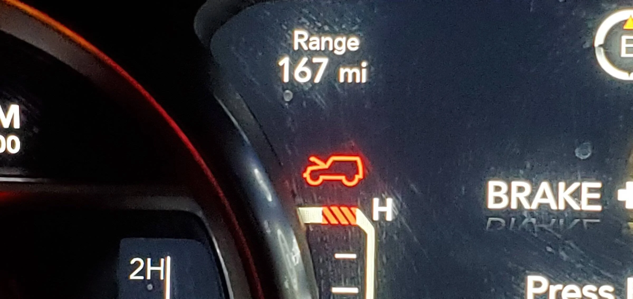

The other switch warns you that the hood is not closed. A warning light appear on the dash cluster stack.
