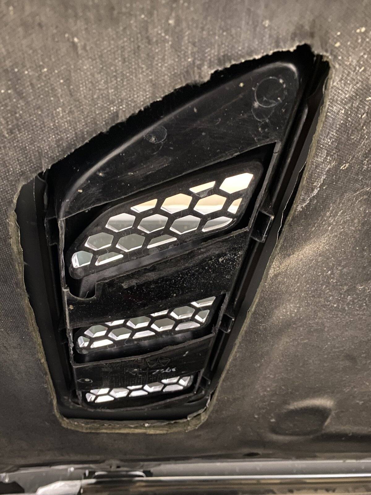

Yeah our cooling systems work harder than an ugly hooker. I've burned myself a couple times trying to pull the prop rod down. I did cut holes in the insulation and the bottom of the fake vents. I didn't do a before test to see if it's helped but when sitting you can definitely feel hot air coming out. Other folks have tested and this is a low pressure area so it should also be drawing out heat while moving.

Vents do not go all the way through. You have to cut the liner and the bottom base on the vent/s

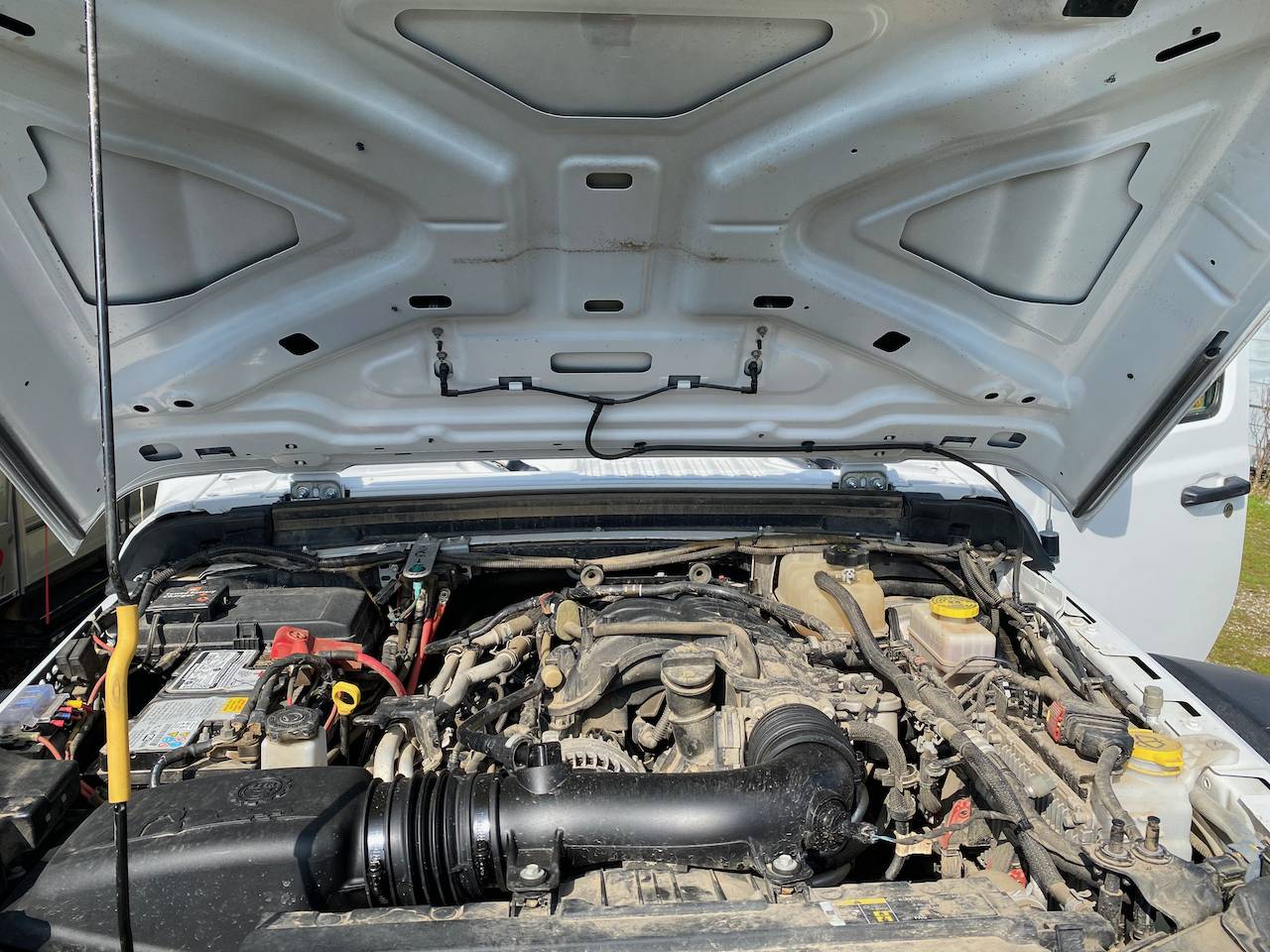

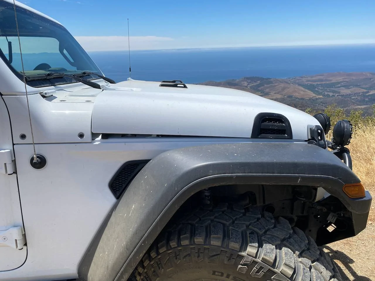

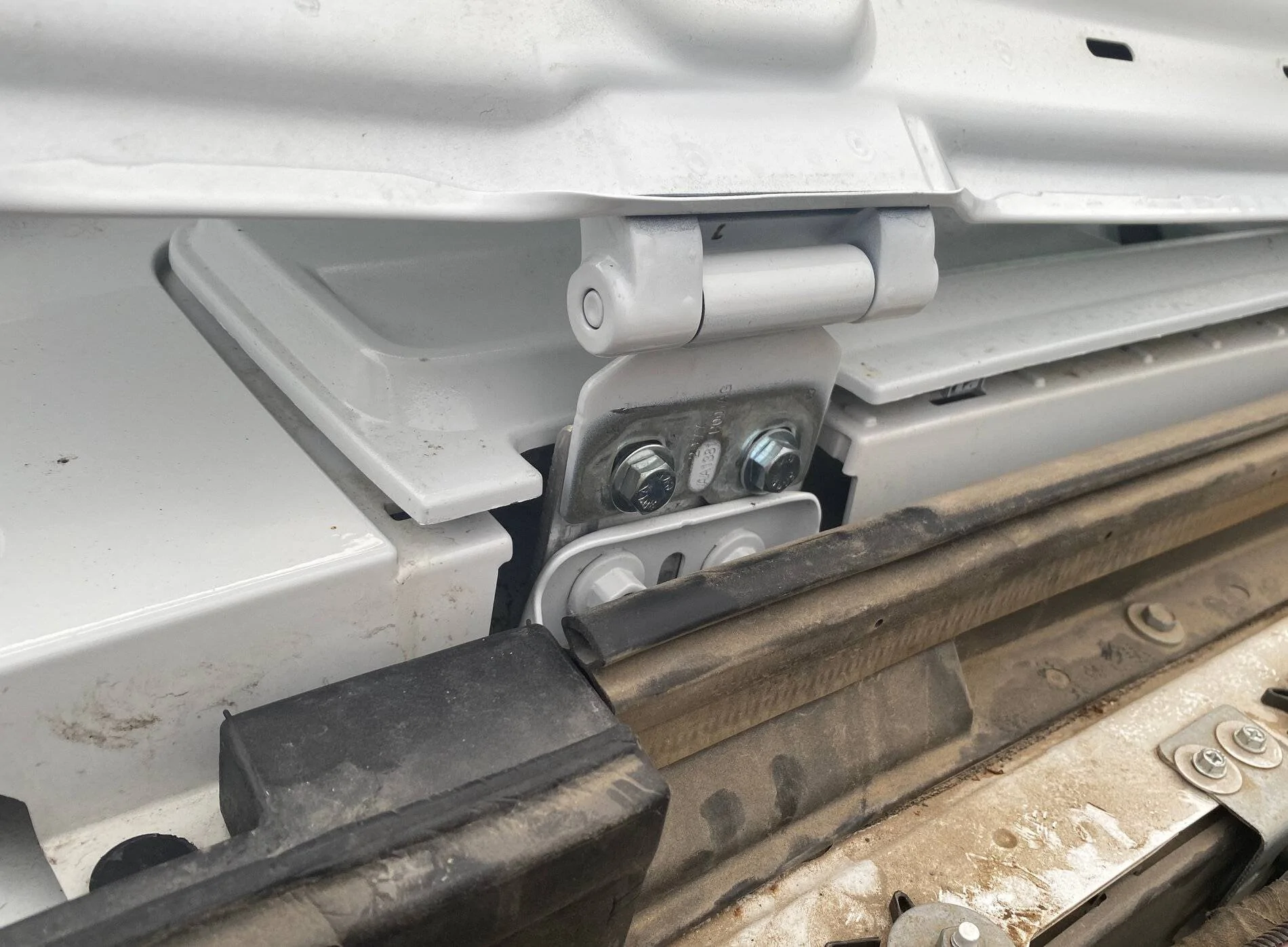

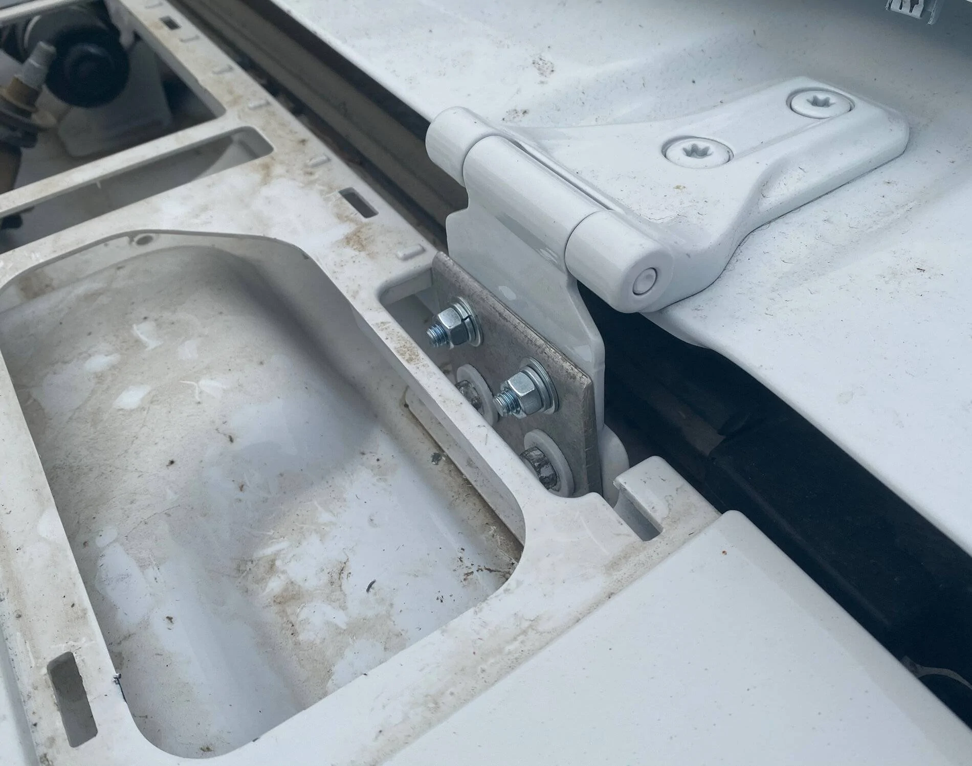

Or if you are a DIYer just pull the sound liner, top engine cover and extend the hood hinges. It works very well venting under hood heat. Caution! some folks are critical of the adjustment to looks and don't understand, "its a JEEP thing" Haha It costs next to nothing to do and if you are not into it. It's very easy to undo. Cuting the hoodliner and drilling holes in the fake hood vents is a one way modification.

BTW, carriage head bolts with the nuts on the inside of engine bay replaced the hexhead bolts. No cowl vent cover intrusion. And about the under hood sound liner that started in the 50's, has any manufacturer ever stated it was for hood paint protection?

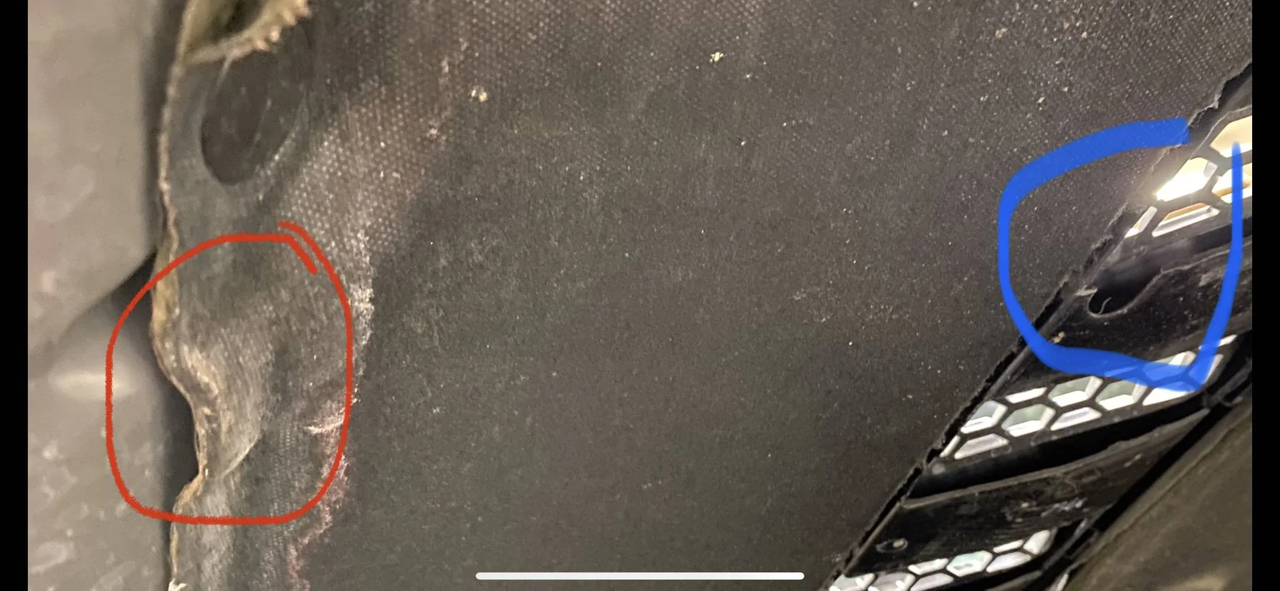

The vent inserts are normally blocked off with a small opening towards the front. Any water gettin in would drain through that to the top of the fiber board looking heat shield and drain off to the side. (Blue circle and red circle respectively)
I didn’t cut the entire bottom out of the vent because I wanted to maintain some side to side rigidity. Hoping that would make it less likely to pop out while on the freeway.
Then of course the fiber board shield has also been cut out.
folks that aren’t a fan of this usually cite concerns of water entering the engine compartment. I’m not saying anyone should do this just that I did it.
