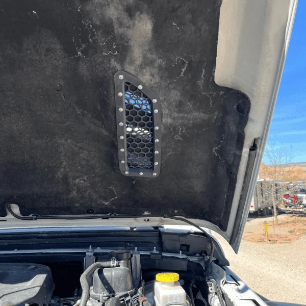

I have recently installed a set of OTB scoops that I bought from iron rock off road. These you cut the bottoms out of the stock Rubicon scoops and cut out the hood liner. My big concern was water entering the engine compartment. They have a fabric in there that lets air out but doesn't let water in . The water still drains out the factory location! It also encapsulates the hood liner.
Thanks, sounds like a great solution.

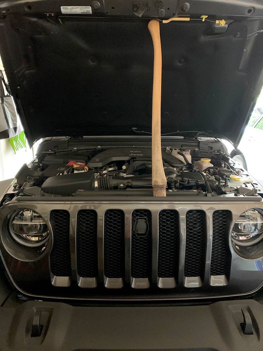

OK, so I'm the new kid and I just read through (almost) every post in this thread. I have a question: does anyone else regularly open their hood when done driving to allow all that pent-up heat to dissipate more quickly? I started doing it on my last car after it developed cooling issues and the habit has carried over to my new Wrangler. I'm convinced it's a good thing to do. I've noticed that despite the mid-to-high 90's we've regularly seen around here this summer - he runs perfectly cool. That's not the issue. When I pull him in the garage his hood is often cooler to the touch than about 15 minutes after I've parked. All that heat under the hood while he's running down the road is being addressed by the engineering designed to keep him cool. But when he stops, so does the cooling. So opening the hood allows all that heat to escape more quickly, saving wear and tear on the plastics, rubbers, computer chips and everything else over the life of the engine bay. The prop gets pretty hot, so I have an axe handle I keep by the front and open him up to give him some air when done driving. I know I probably don't need to, but it feels like a good thing to do. Not saying every time, everywhere... but.... Don't want my buddy ridden hard and put away wet when there's an easy fix. Anyone...?
Jbcrane, can I ax you why you chose to use an ax there?

Ax and you shall receive... it was on hand, the right length and better than the hood prop - which made a cracking sound every time I un-hooked it from the yellow clip on the hood. Figured it was just a matter of time until it broke and the prop swung down. And in the summer, that little bugger was hot to the touch. Any other questions ax away.

I do this while out wheeling. The cabin is much cooler when I get back in.
