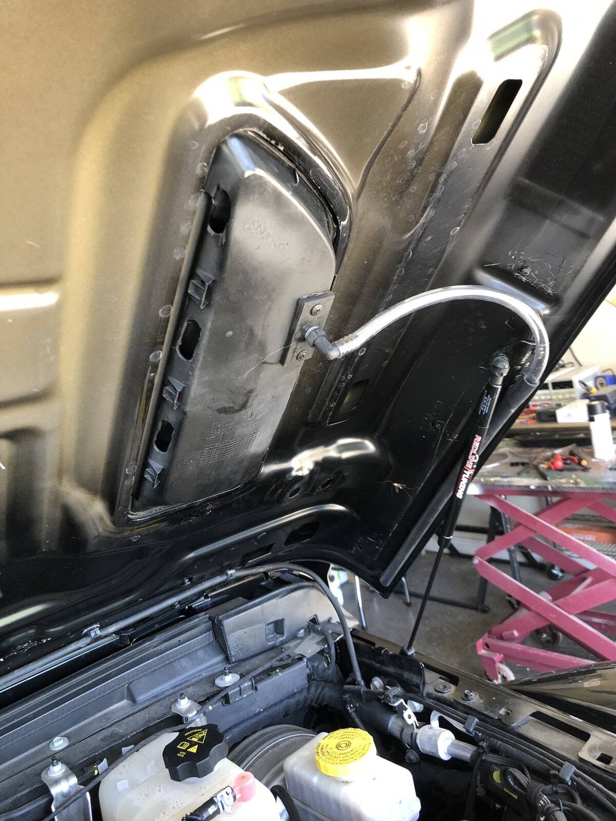

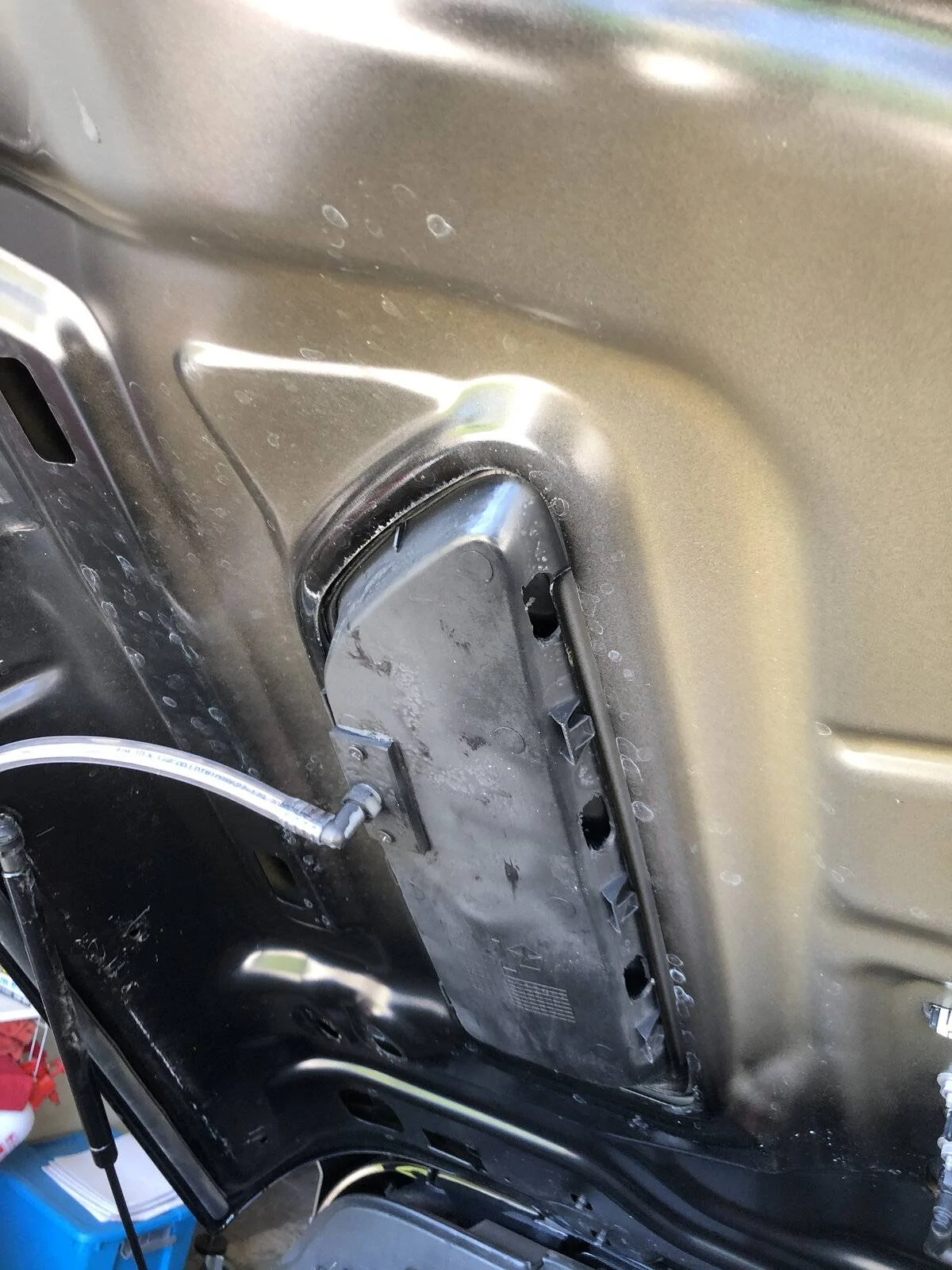

The hood pad has nothing to do with heat and paint, it’s a sound insulation pad. The paint gets hotter in the sun than from underneath.
on the JL it also serves to route vent water to the edge of the hood for disposal. I’ve taken my pad and sent it to the recycler and cut the sides out of the vent
to release heat and attached a couple of hoses glued to plastic to route the water to the hood seals and out of the back of the engine compartment! It’s been this way since January 2018! Check the photo.
Wow, you've takin' it to the next level! Nice work.

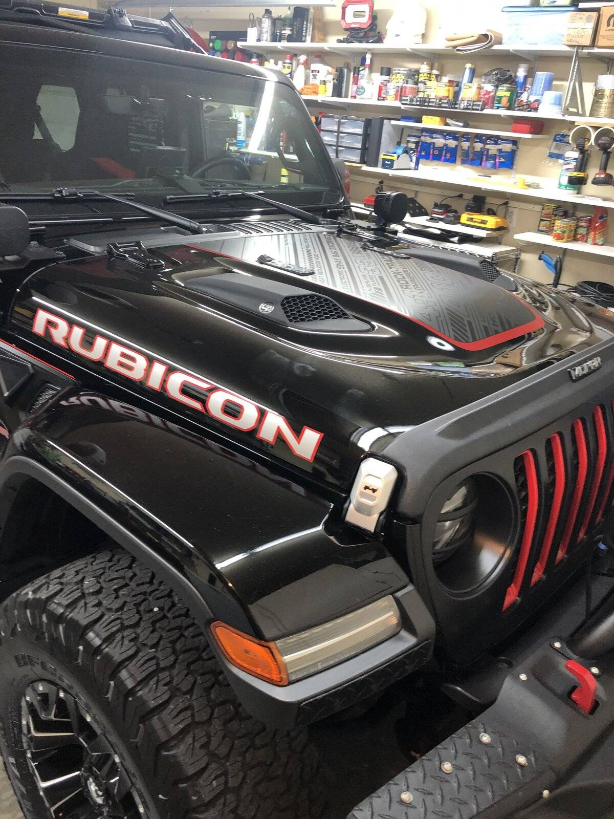

Oh, so you mean these? See attached. I’ve had them since 2019, absolutely love them.
The S&B Hood Scoops are designed to fit the 2018-2020 Wrangler JL and 2020 Gladiator Rubicon hood.
I just emailed them to find out if they'll work for 2021 JLUR. Those are nice scoops for just $200.00 bucks.
