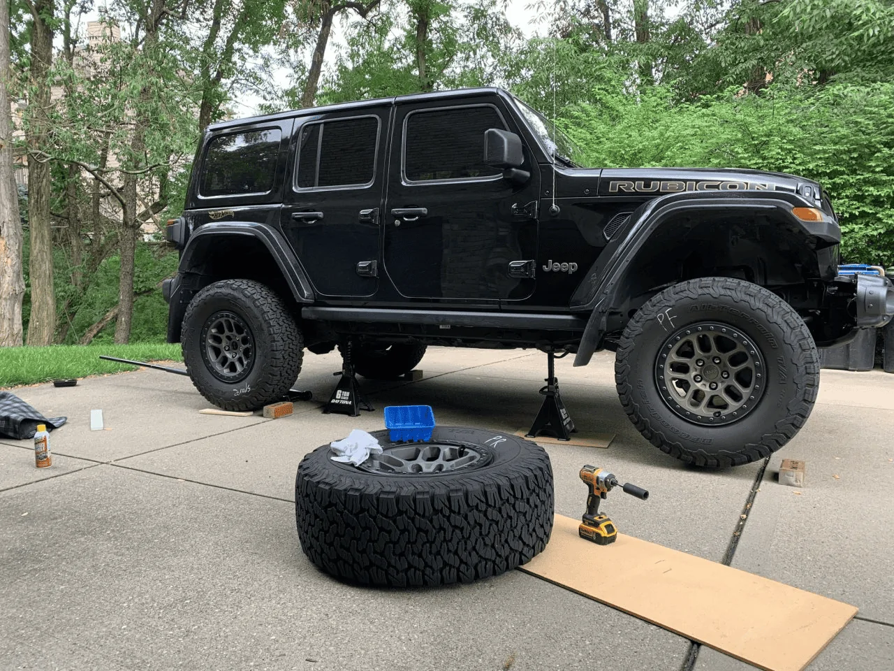

But if you use the no jack stands method I described above, you only need to jack each wheel a 1/2" off the ground. When installing the tire just rotate the tire so the bolt holes are in a similar position to the bolts, scoot it up to the bolts and lift it the 1/2" onto the bolts.
It's a lot easier than lifting to jack stand height and you'll never scratch the wheel as it will always be within 1/2" from the bolts.

Thanks. After about 30 minutes of grunting & cussing with the first wheel, I realized that if I sat my butt on the floor and used my legs to hoist up the wheel onto the studs, this was far easier than trying to do this half-standing up. I also realized I jacked up that first corner a little too much. Once I figured these two things out, I did the other four tires in the same time I wasted on the first.
Other than that, I did exactly the approach you suggest last night: no jack stands, and just jacked up one corner at a time.

Hey guys, just did my first 5-tire rotation on the Jeep last night and had a couple questions.
First, I bought some jack stands with the idea of doing the approach a lot of guys talk about for tire rotations, where the Jeep is put on four stands and all the tires are rotated at once. However, I was surprised to see mentioned in my new jack stands' instructions the following: "Do not use automotive jack stands to support both ends or one side of a vehicle. Use only one (1) pair per vehicle."
Is this just overblown lawyer legalese talking here or is putting up the Jeep on four stands to do rotations a bada idea? I ended up just lifting one corner at a time last night.

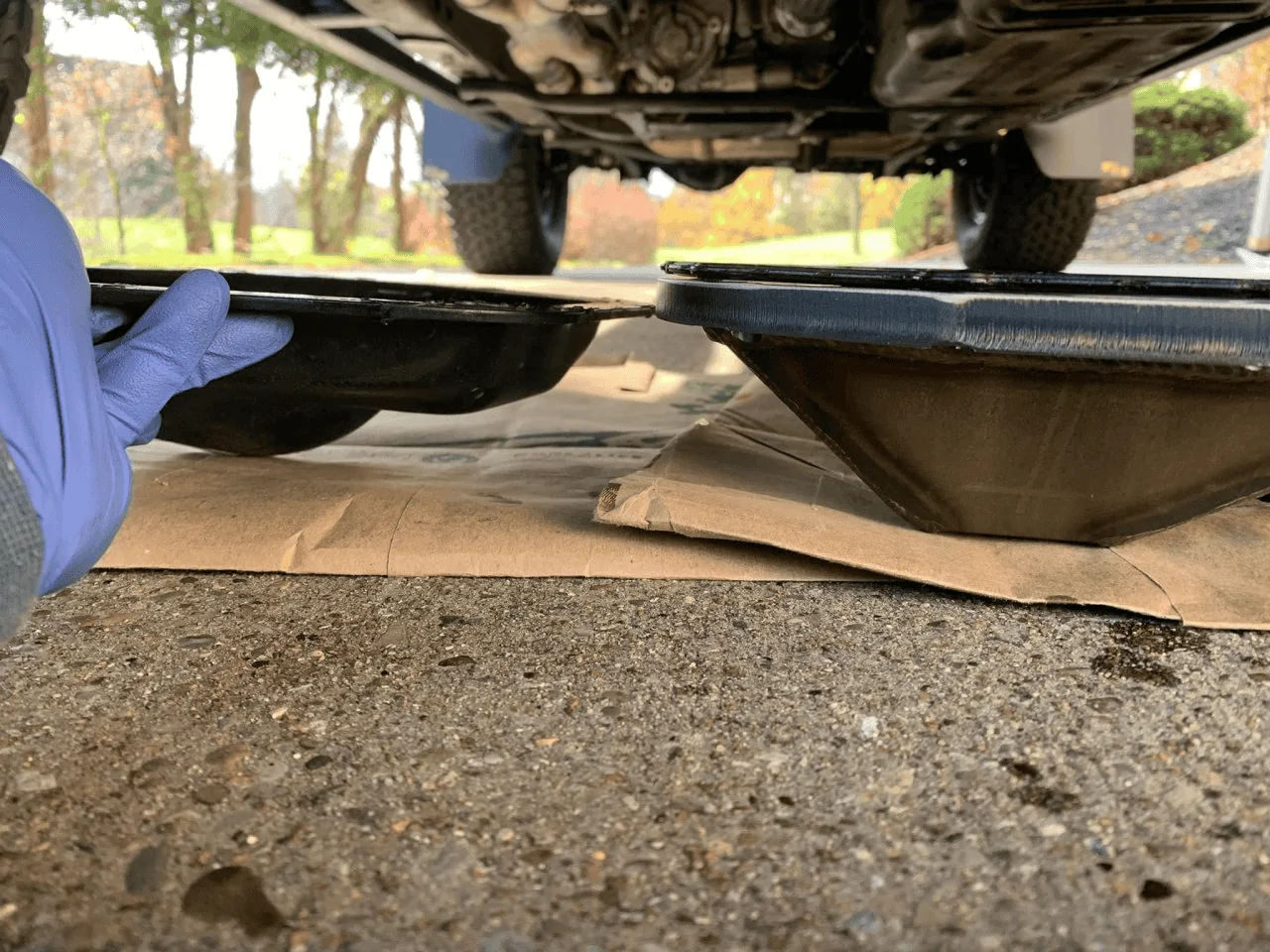

I did my first 5-tire rotation in August myself and documented the details https://www.jeep392.com/threads/my-1st-5-tire-rotation.1593/ I used a 24" long reach floor jack and two 6-ton jack stands bought from Harbor Freight.
I decided to jack up under the frame near front passenger side and put the jack stand to hold (with a rubber pad). Then went back to the rear and jacked up the axle tube of the right side. This way I can change the two tires on one side first then move to the driver side.
Jeep Wrangler JL Two tire rotation questions 1668099778153
I didn't use the pumpkin as @Rhinebeck01 explained. You can also see how thin the factory diff cover is from my picture.

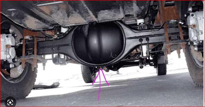

I am an older fruck (73 yo) .... For years and years, on various vehicles I used / would use the pumpkin.. Never an issue.. I have Jay Walked for years too, and so far have not been run over...
SURE, there are times, no foul if you use the pumpkin.... but to be honest when I teach/explain to young guys and gals these days, I tell them it is best to avoid the pumpkin as there are far better ways to do the deed..
See, problem is depending on the vehicle, you can get into real issues using the pumpkin, even if the vehicle has a pumpkin that is high enough up to get a floor jack under.. Also, there are lots of vehicles that you do not dare jack up using the pumpkin..
Anyway, I just tell guys/gals... in general.... that unless you really have a clue lets say .... just avoid using the pumpkin is best... .....There are better points use..
Last young guy I told this too, called me two weeks after I told him to avoid using the pumpkin... He decided to use the pumpkin and of course, somehow in the process... he really damaged the lip/bottom of the cover on his rear diff....
As for using 4 jacks stands for a tire rotation.... Not worth the effort of doing this... and there are valid reasons and concerns for the caveat the jack stand manufacturer gave. I know i would never tell someone to use 4 jack stands for a tire rotation.
