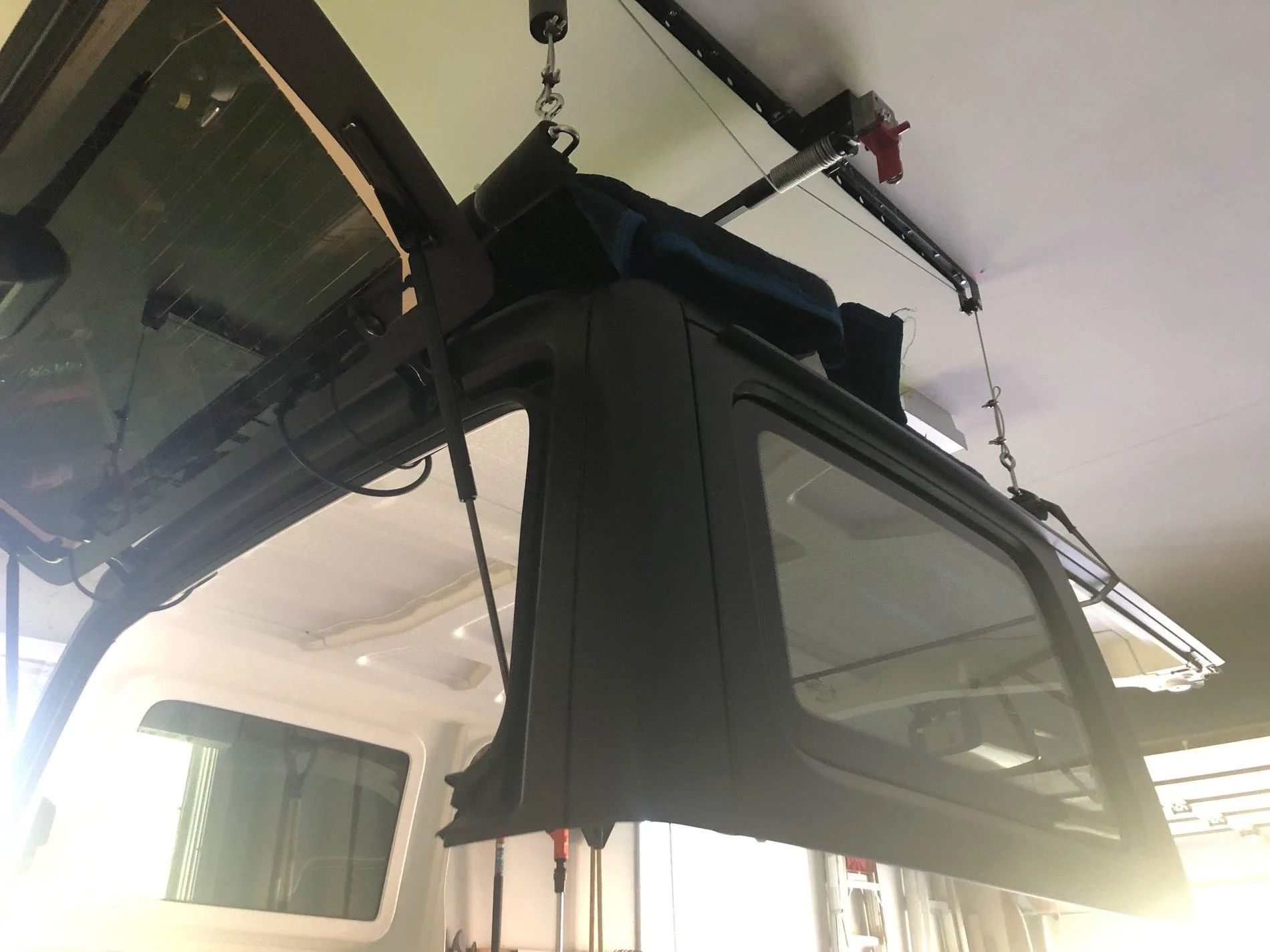

I timed putting on my top today (including freedom tops, but not the 30 seconds to back in) ...
12 1/2 min
I use a little 4v drill to speed the bolts in with a separate t50 bit I grabbed at HD. I then hand tighten with Jeep socket wrench.
- Brad

Hoisted the top today, all looks good.. ordered the extra parts to replace the plastic parts etc.
My question is, the directions say that the front hooks should wrap around the front eye hooks but not through the eye.. I look at pics and I see lots of folks going through the eye..
Big deal or no? I went thru the eye

I go around. I can’t imagine it matters other than you may need to level racor set up differently because distance is changing when back straps stay the same.
