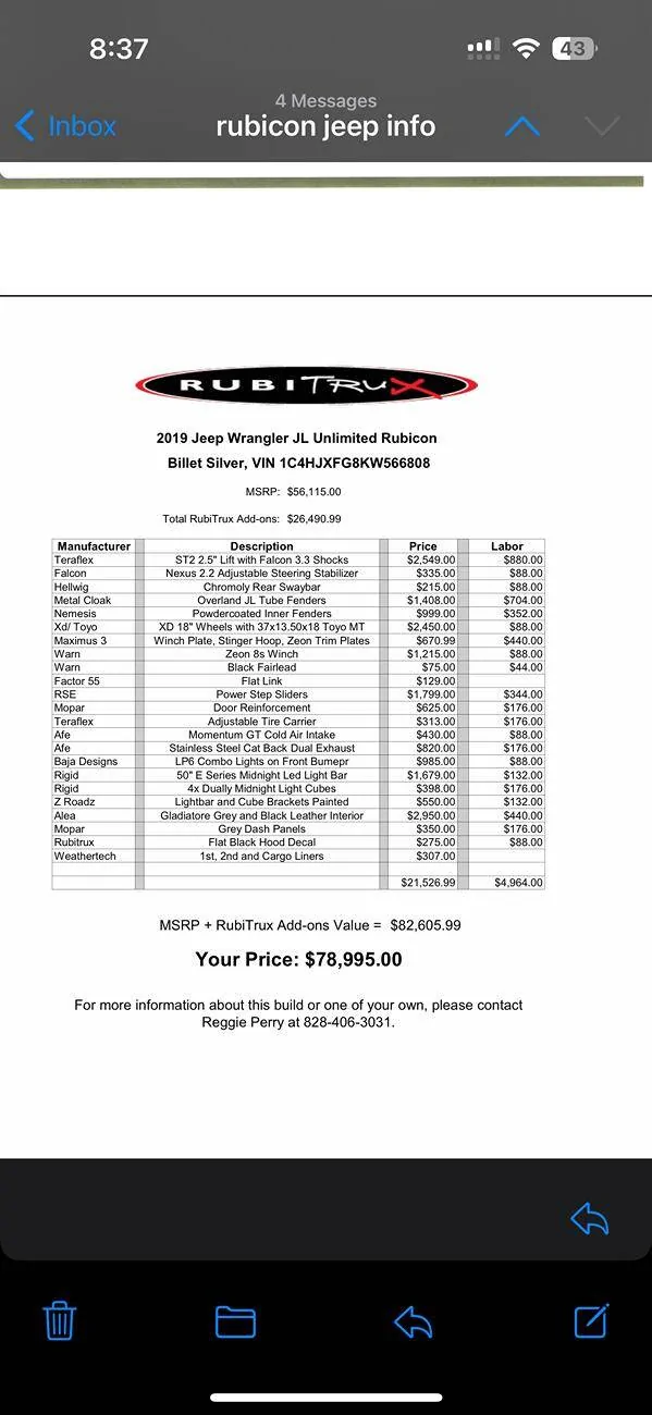

Well that's a big part of the up travel issue - you only got like 3" before you're in the bump stop. Did your Jeep start off as an XR?
I don’t think so, 2019 JL Unlimited Rubicon - here’s the build sheet

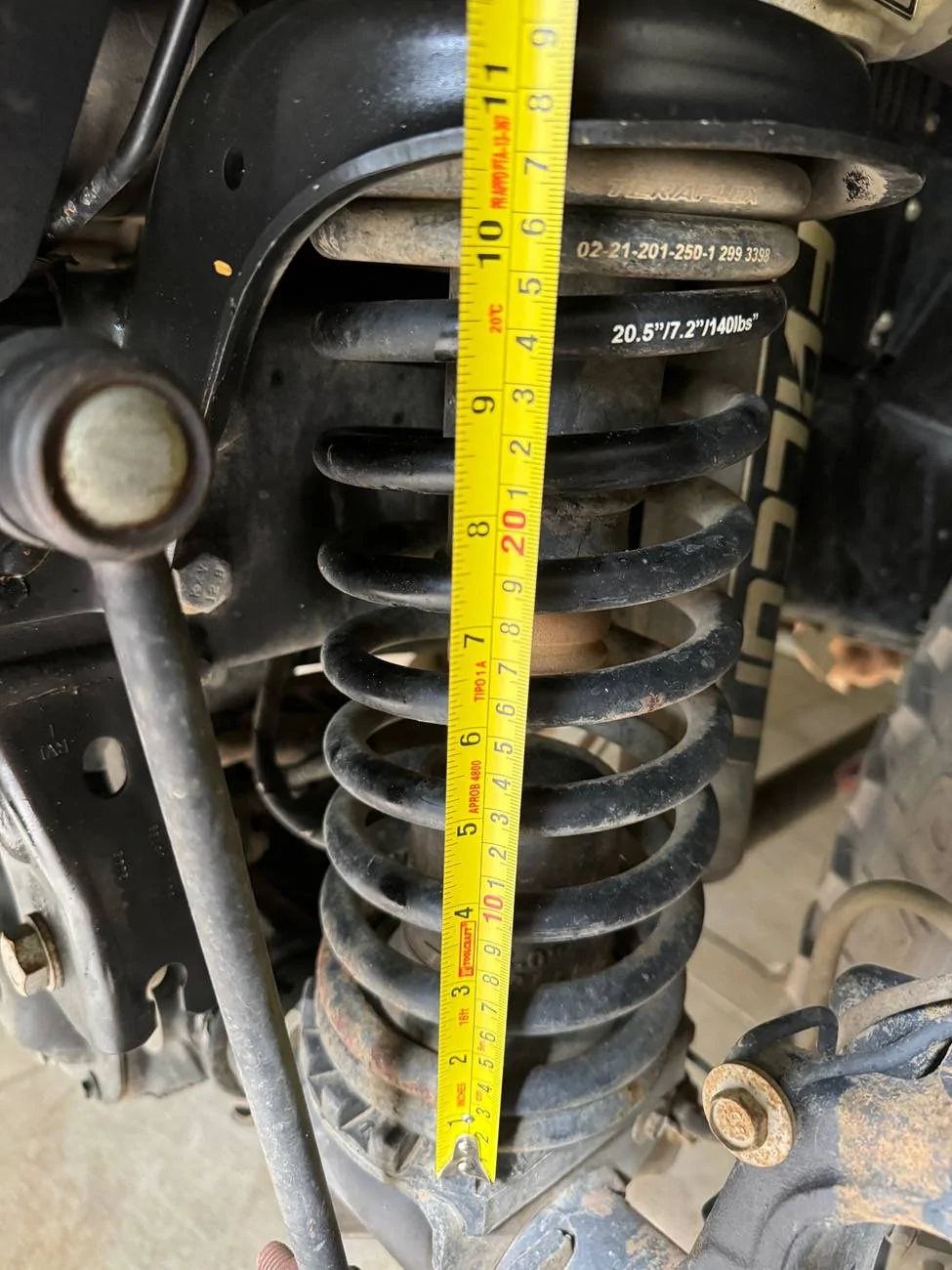

That's 3 cm, not 3" of travel. No wonder that thing rides like poo.
You have to measure to bottom of the jounce tube, since the foam bump stop compresses under load. He has 7cm to the lip of the jounce tube.
