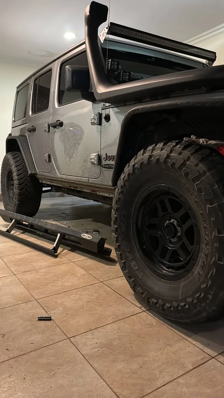

I’m asking for help please from someone who knows. My Jeep suspension is terrible and after years of suffering it’s time to fix it. My best guess is I have too much weight for the springs, unless I run my Falcon 3.3’s on firm, the Jeep just wiggles and wallows all over the place. Would an HD coil spring in the front or all around be a solution? This is the Teraflex ST 2.5 with Falcon 3.3’s, it’s been terrible since new and less than 12,000 miles on the Jeep. My previous experience is with Carli Suspension on 2 Ram 2500 HD’s, one had a AEV steel bumper and winch and it too was too much weight for the springs so I’m inclined to think same issue here. The shocks are still good, if anyone who runs a winch, bumper, sliders/steps and has extra weight solved this issue I would appreciate your help. Use is spirited driving, washboard, washouts, big holes at a good speed, no rock crawling or slow technical stuff. Thank you.

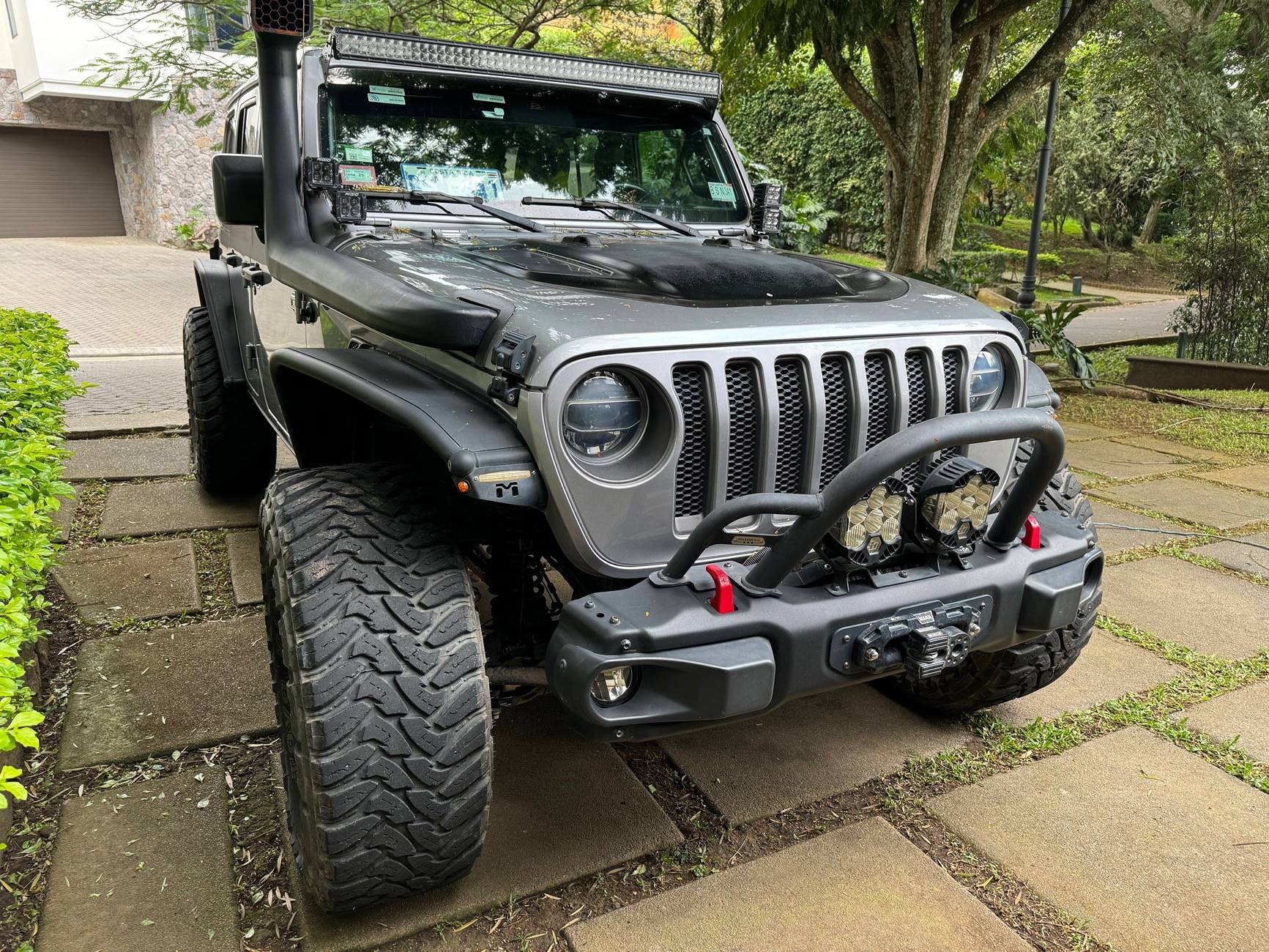

You can see I have the winch, stinger, sliders, fenders with a 37” tire on the back.
Was just wondering what there was for weight beyond that. Any additional belly skids? Overlanding platform inside? Big box of tools in the cargo area? Etc.

No, just what I have listed is in addition to stock and it’s the front end that is my biggest concern/problem. Floor to fender there is just over an inch and a half difference with noticeable rake in the stance with front being far lower than rear.

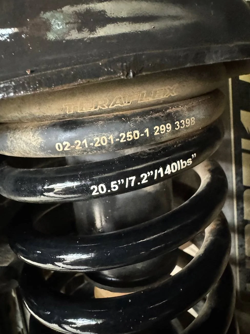

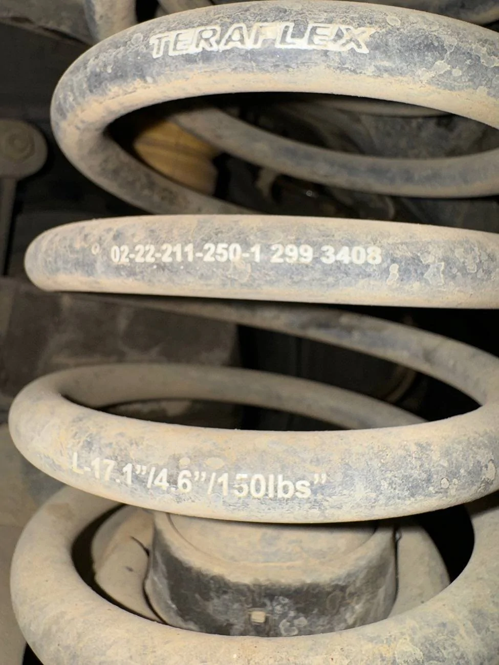

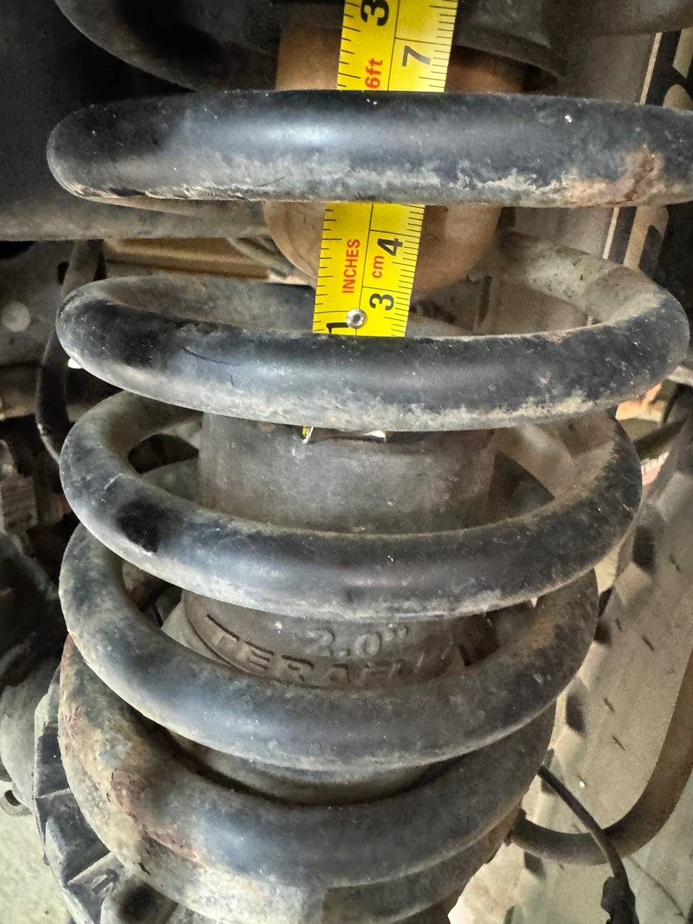

@MikeG_CR in the first picture (front spring I believe?) can you measure the distance between the bumpstop and the plate?
If you're bottoming out on any setting except the hardest, you may not have enough travel. That happens to the diesel XR all the time, for example, given how heavy they are. What engine is yours?

It’s only the 3.6L gasser but the winch is 75lbs, the stinger is 15lbs putting 90lbs+ on the front bumper. I agree, I don’t think I have enough travel, always seems it’s missing one to two inches

This is what we have on the front

Well that's a big part of the up travel issue - you only got like 3" before you're in the bump stop. Did your Jeep start off as an XR?

those 2 inch bumpstop extensions also seem like a lot. Do you have any idea why they added that much? There must’ve been crazy interference with some part or sth…
I would try cycling the suspension without these on to determine the right amount of bumpstop. If you really need that much, you can either change the part that’s causing the interference or, as you suggested initially, go with (much) taller springs.
