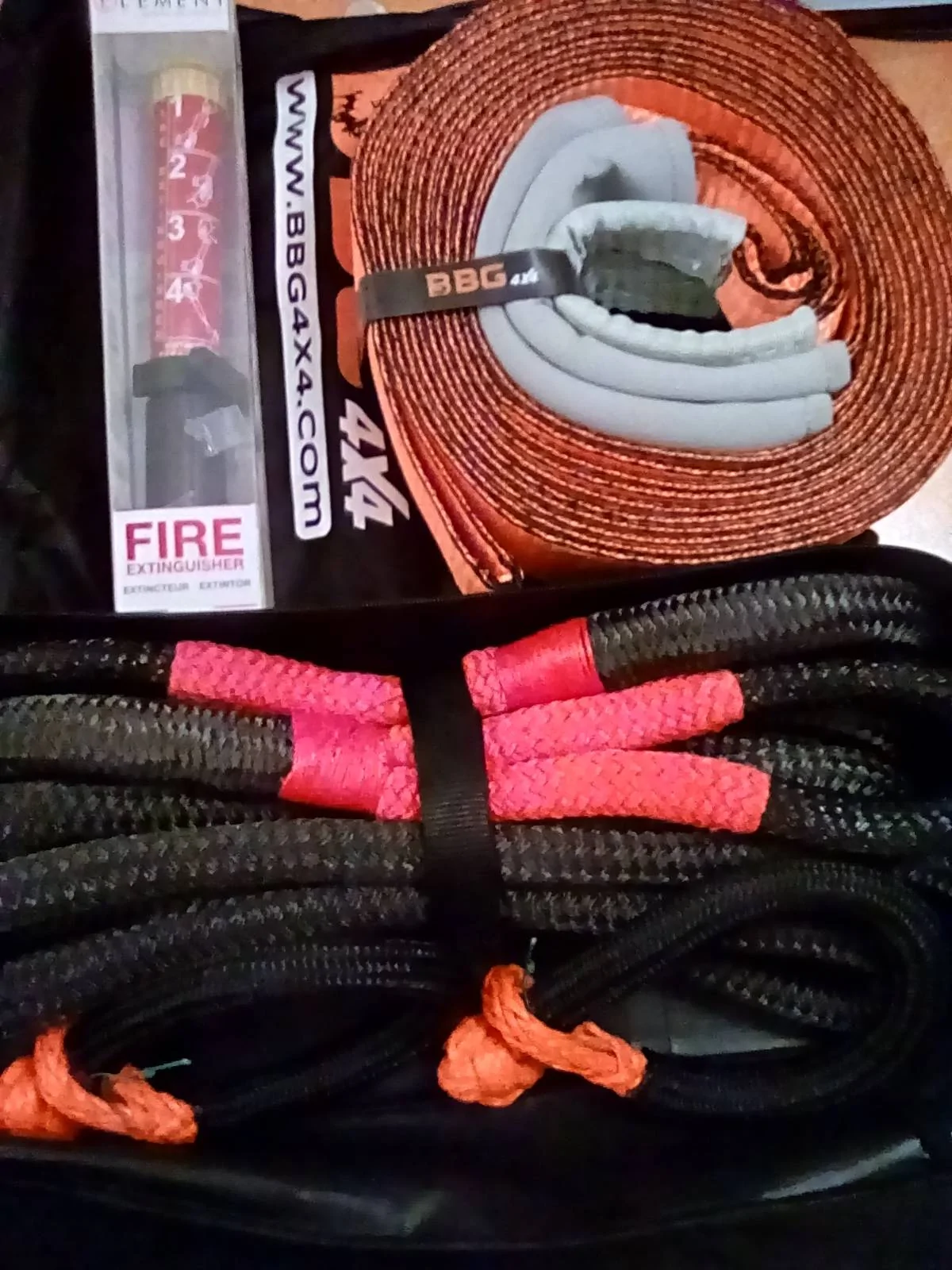

If you will be using it to recover stuck vehicles, then definitely consider a Kinetic Rope, rather than a Tow Strap. If you're going to be towing vehicles, then use a tow strap.
I have a BBG4x4 3"x30' Tow Strap that is Super Beefy. Although, I haven't had a chance to use it yet. I went overboard with the Strength because I figured I could also use it as a Winch Line Extension or makeshift Tree Saver. It was $28 Shipped on Amazon (now $36 though).
For Kinetic Rope, I use a QiQu 7/8" rope with 2 of their soft shackles. So far they have worked great and held up very well.
Pics of when I got them:
Since I have to first purchase a steel bumper and then a winch, I decided it was worth the $ to have some decent recovery gear.
I picked this up on sale and feel I can at least flag someone down to help me out - or be available to help another stuck soul - until I kit out a bumper and winch.
