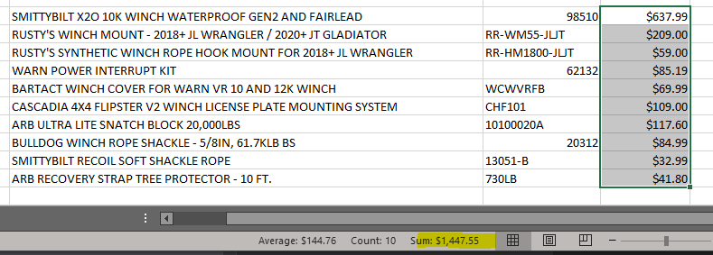

ML7
Sep 29, 2020
131
158
Frisco, CO.
2020 Wrangler JL Rubicon
Here is my complete winch/recovery kit currently, used this forum to get all the different pieces haven't mounted everything yet the pics will be soon
Jeep Wrangler JL Thoughts about winches winch
PyrPatriot
Nov 6, 2019
43
567
564
Kentucky
Jeep Gladiator
Ouch on that winch price. Got mine on sale from 4WP for $330 for the steel cable version. Synthetic line was about $100 and fairlead was another $50
