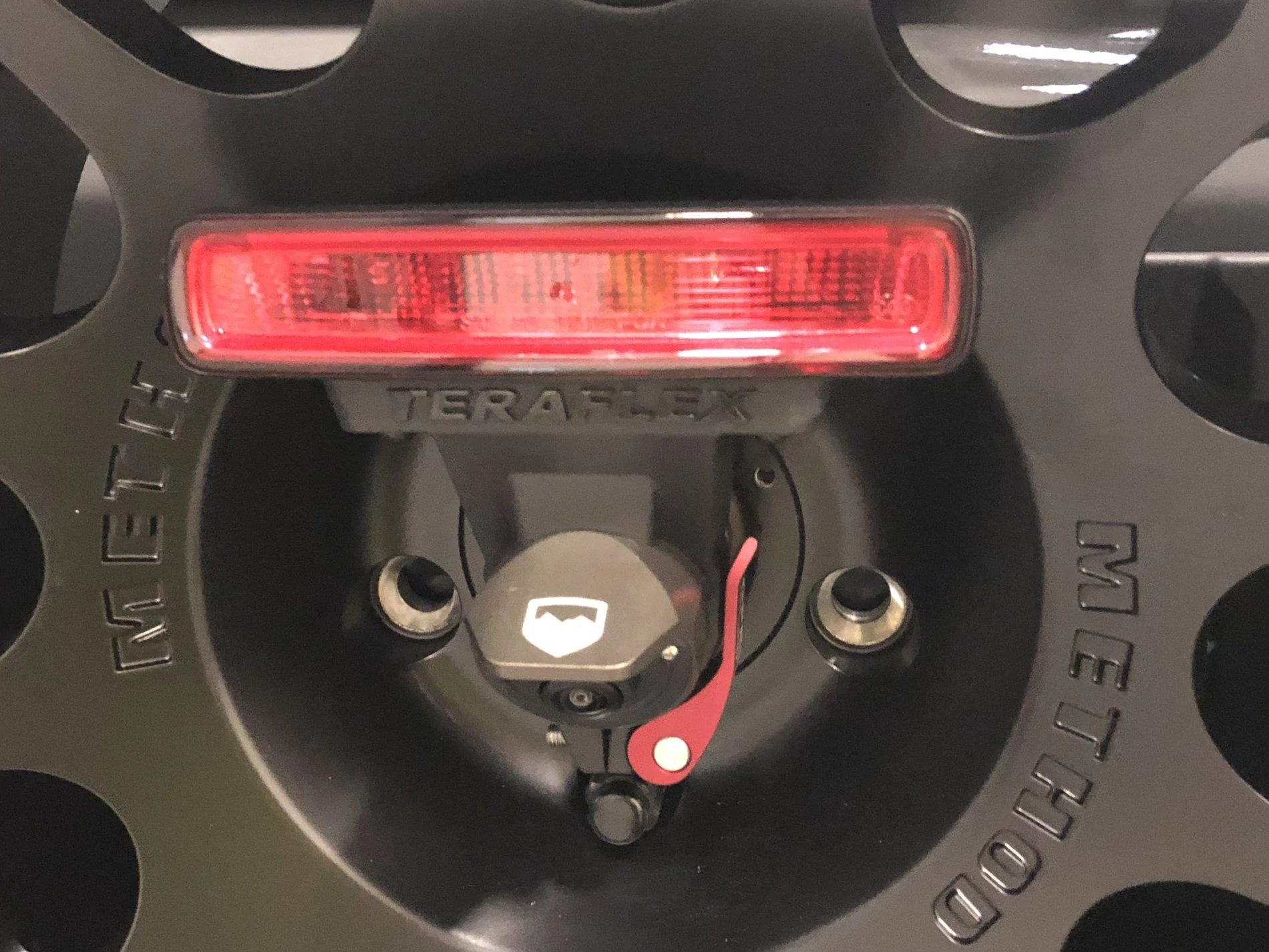

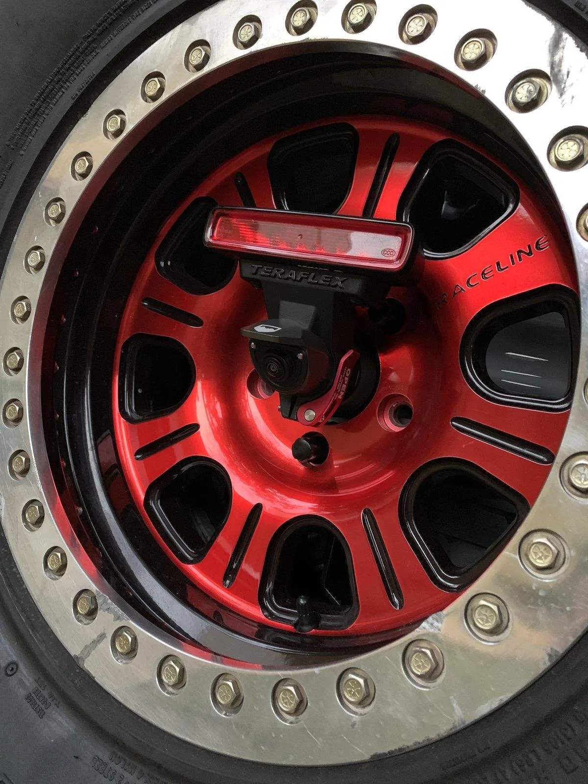

I went with the new Teraflex Alpha just released. Solid with a 37” beadlock. I like the billet quick release to access the spare. It is attached to the Mopar reinforcement brackets and it re-uses the stock 3rd light.
I did the same setup and I'm not happy. Does your tailgate rattle and sag like mine does?
