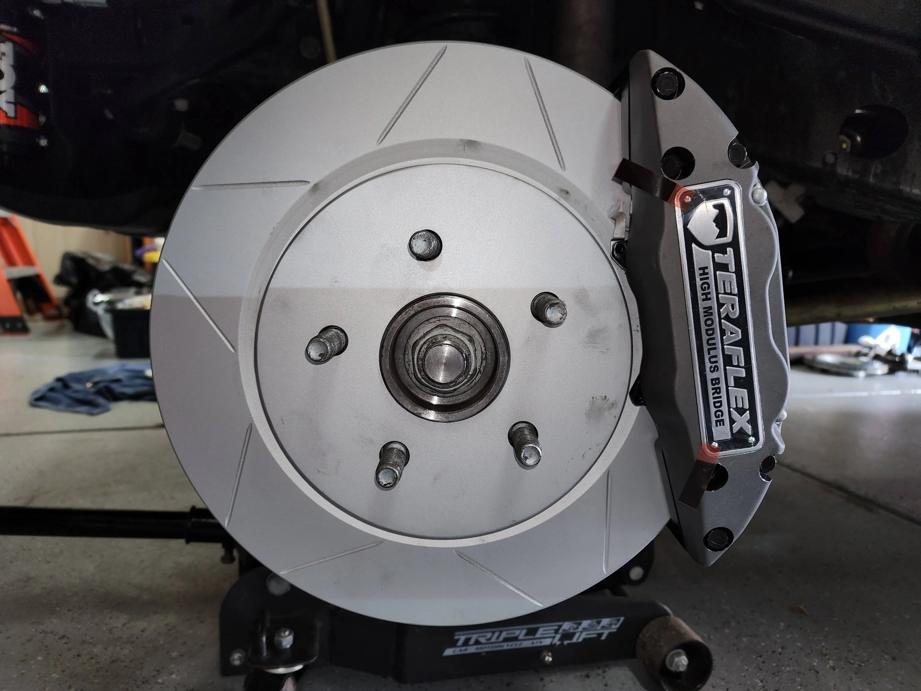

Rears are installed. The only thing I don't really like is the way the OEM brake lines fit. I'll be changing them to aftermarket in the near future. Otherwise, the template was pretty conservative which is a good thing, so I have plenty of room:
Jeep Wrangler JL Teraflex Delta Brake Upgrade! 20230413_181807
Slight difference in size:
Jeep Wrangler JL Teraflex Delta Brake Upgrade! 20230413_173750
Jeep Wrangler JL Teraflex Delta Brake Upgrade! 20230413_181449
Fronts are next followed by bleeding.

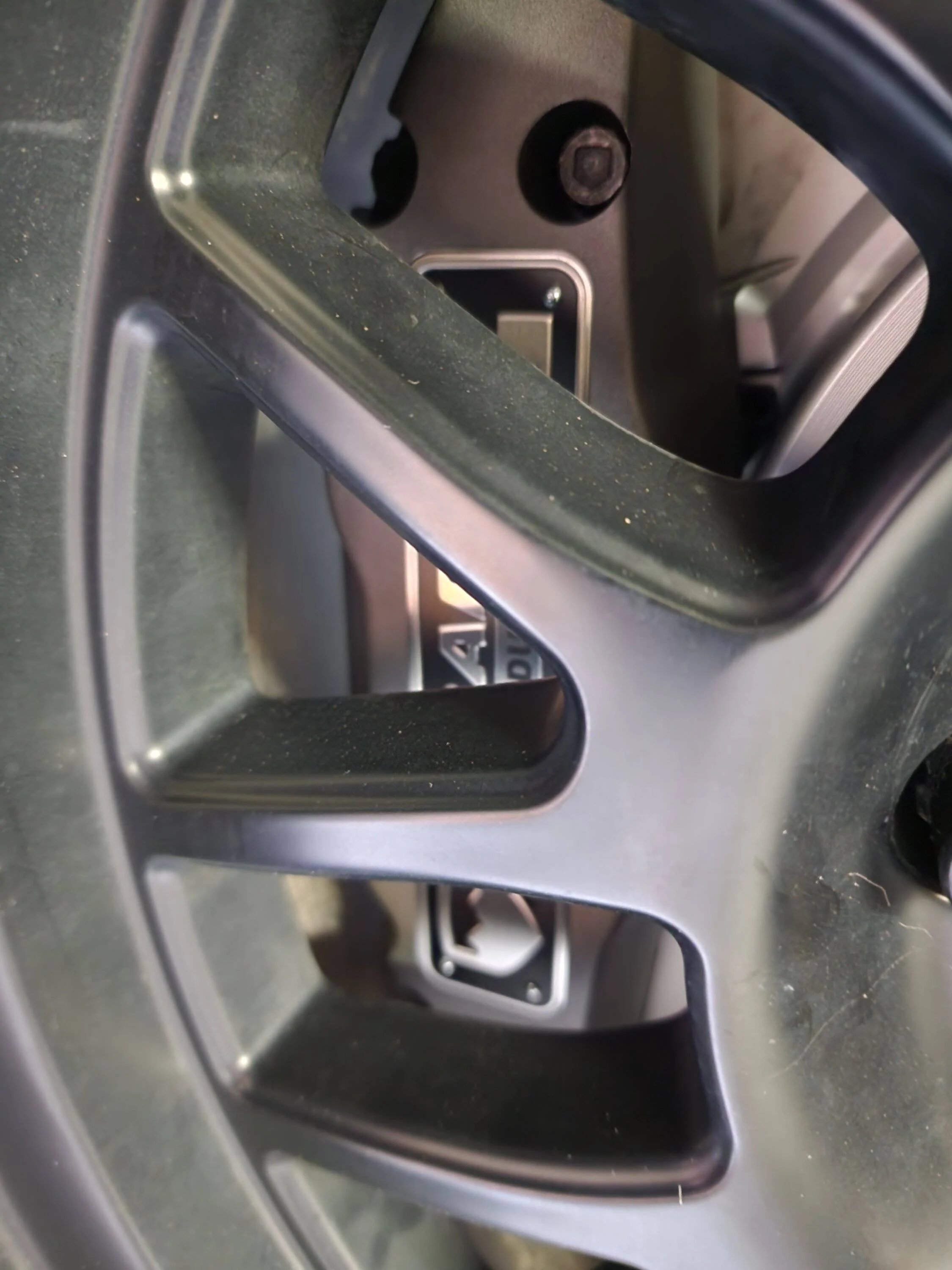

Fronts are installed. OEM brake lines fit perfectly on the front, so I'll only change the rears.
Less clearance on the fronts so the template is spot on:
Jeep Wrangler JL Teraflex Delta Brake Upgrade! 20230414_102123
Nice difference in size:
Jeep Wrangler JL Teraflex Delta Brake Upgrade! 20230414_094252
Jeep Wrangler JL Teraflex Delta Brake Upgrade! 20230414_101331
Now to get them bled and road test.
