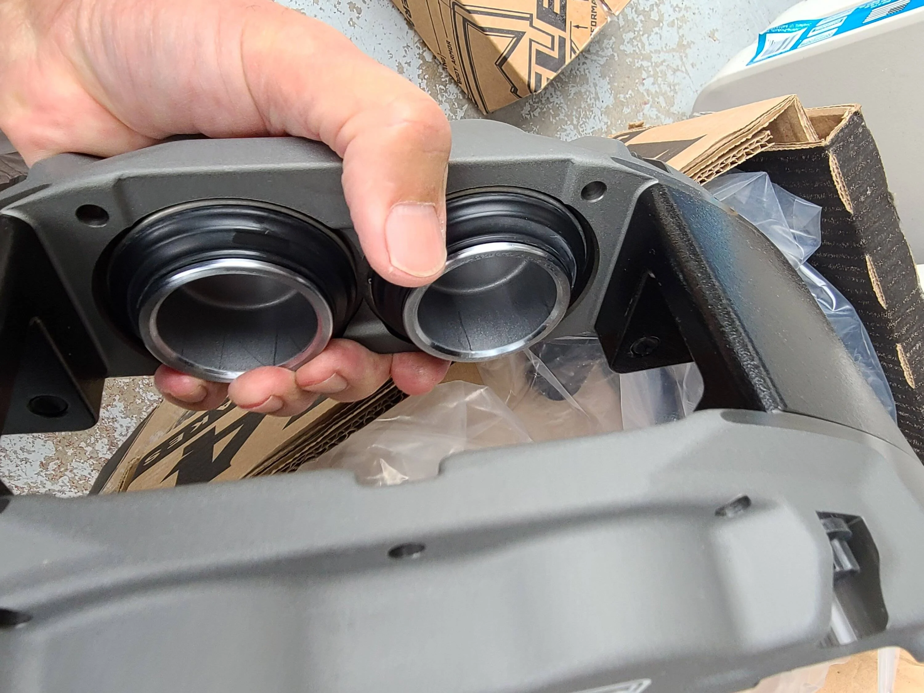

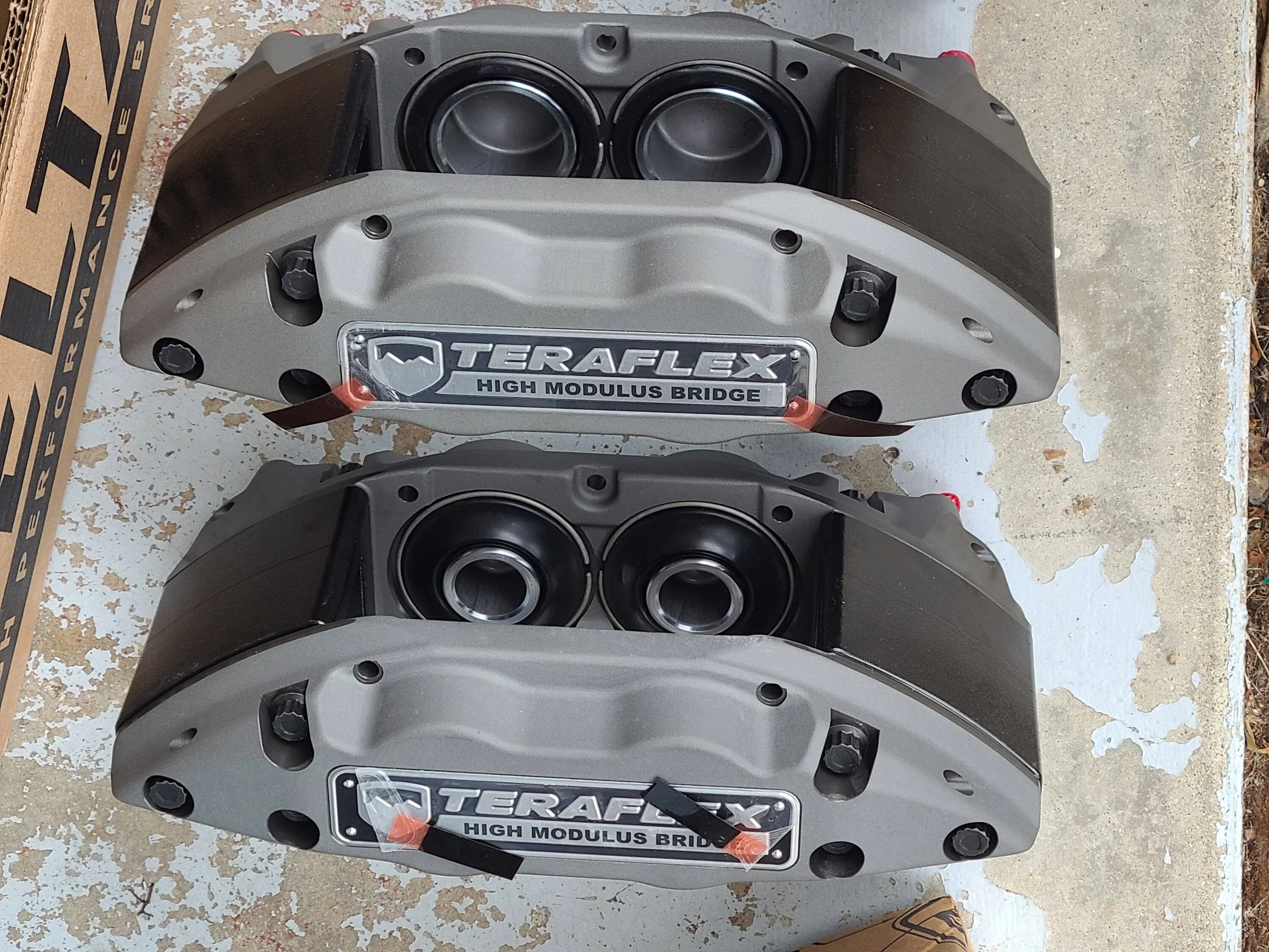

Progrip don't do a kit for the JL, but I found Teraflex's Delta System, and after a bit of research, decided to give it a go. Overall, beyond the marketing hype, it looked like a thoughtfully designed system: not just bigger rotors, which can never be a bad thing, but also having pots either side on the caliper for more evenly distributed pressure, and more of it. That one-person bleeding system was also pretty darn compelling.

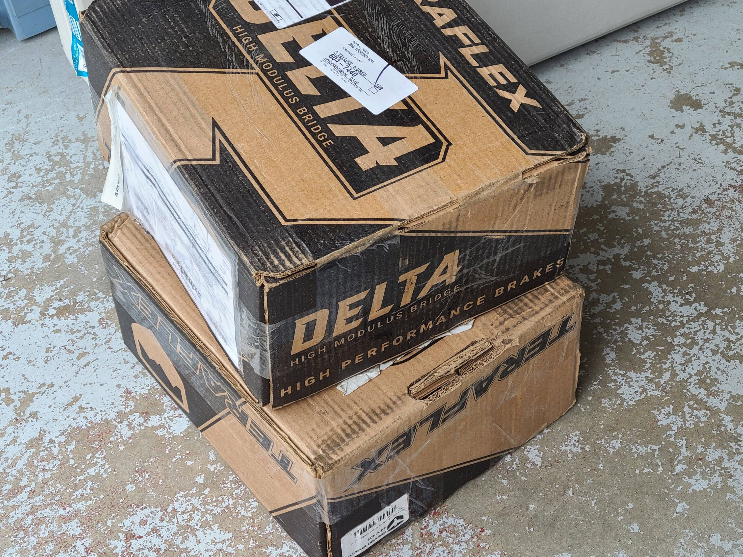

The kit arrive in 4 boxes, each of which weighed quite a bit. One box for each of the rotor sets, and one for each of the caliper sets (Front and Rear). These are some big-ass rotors, let me tell you!
