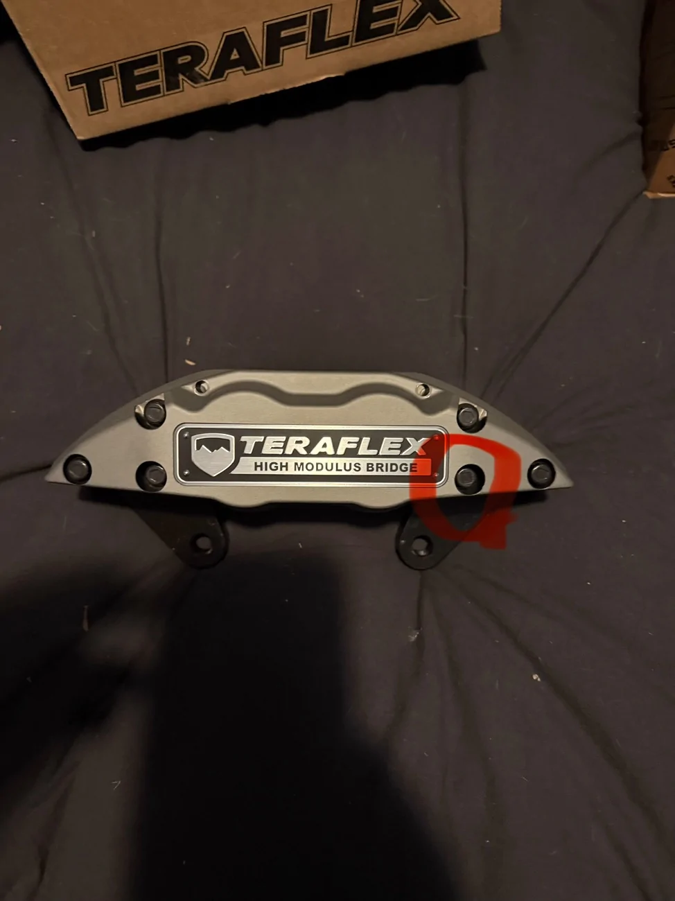

So my 21 jlurd needs front brakes so I decided to go ahead and buy the Terraflex delta bbk for the jeep. In my excitement of getting everything I took everything out of there original box including the rotors. The rotors and also individual wrapped so I kept them in those boxes and through the main ones away so I’m not for sure which are the front and rear rotors. Any one know if there is some way to tell them apart?
Also while looking at one of the rear calipers there was a single bolt that was loose anyone know the socket size and tq spec for these bolts.

Can't help on the loose bolt without more info - preferably pictures.

So quick update I contacted teraflex about socket size and torque specs. Was told it’s a 10mm 12 point deep socket and they get torqued to 60 ftlbs.
Jeep Wrangler JL Terraflex delta brake? IMG_4405
Not actual caliper with loose bolt but the one circled is the one I had loose on the other rear caliper.
