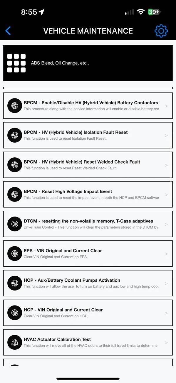

Anyone have any idea why service Abs light would come on after the delta bbk swap, including stainless steel lines?

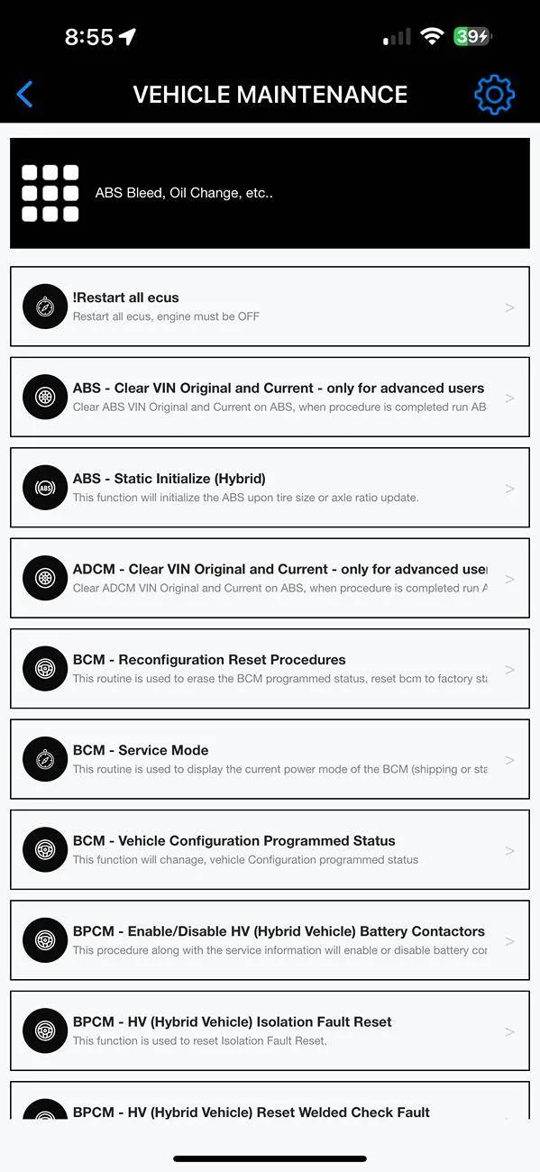

thanks for the response, double checked rhe wires and everything was well. I however used a scanner to delete the codes and it went ABS went away. Bled the car multiple times and pedal is still soft. Using my J Scan, sadly i cant find the ABS bleed procedure. Seems like it doesnt have that feature anymore

The ABS bleed is in the Maintenance section of JSCAN. That's likely your issue. There are many other OBD2 devices that can do the ABS bleed process.
Did you look under Adaptation, Vehicle Maintenance? Still there on my JScan.
Jscan on the iphone forced updated the app, so i am not sure why its not there anymore.
yes i did, and i have screenshot now of it to the previous member. Seems like after the app forced me to update and the ABS Bleed is no where to be found
