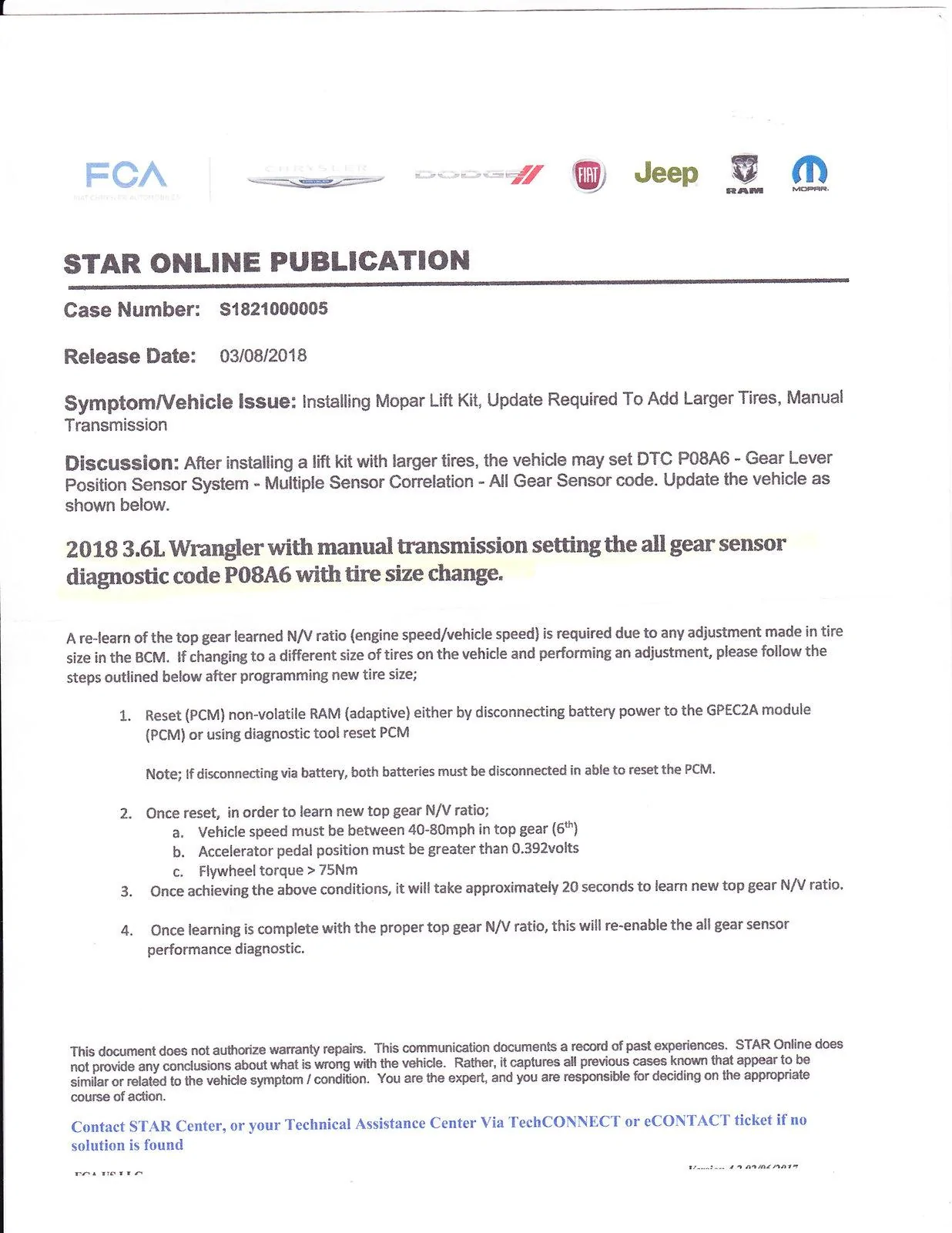

Not sure if this has been posted, but for those of you with a 6spd that experience issues with the Start/Stop error messages after upgrading tire sizes or changing gear ratios I found the procedure below fixed my issues. I had this issue when I went to 40's, but shortly after I must have disconnected my batteries for unrelated work and it reset the ESS. Recently I changed my gear ratio and the error came back. Browsing the forums I found the procedure below which apparently just applies to JL's with the manual transmission.
I apologize if this has already been covered.
Jeep Wrangler JL Tazer (Programmer) for the JL ESS reset
