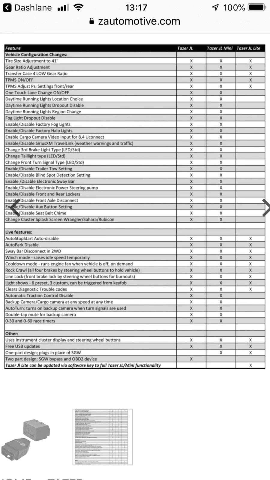

The only difference between jl and mini is one is two part and the other isn't?? What is the point of that? And which of those two would you get and why? Thanks for your input.
The mini is the newer model. If I were buying today I don't think there's any reason to buy the 2-part unit.

Well, I can see a valid reason why someone would go with a Tazer JL versus a Tazer JL Mini.
If a guy/gal is concerned with the 12v power draw of a Tazer JL, he can easily unplug the Tazer JL from the OBDll port and then no power draw.
He/she could leave the Tazer JL married, the gateway module in place and just benefit from the non live features.
NOW, if he/she wants live features if say he/she is going off road, he/she can quickly just plug the Tazer JL back into the OBDll port and have live features..
On the other hand with the Tazer JL Mini.... you have the headache of getting up under the dash and fooling with the gateway connectors every time you want to do similar as to what I mention above.
Anyone that has fooled with the two connectors will tell you it ain't pretty, disconnecting and disconnecting .... and for sure, not as easy as unplugging the Tazer JL from the OBDll port.
