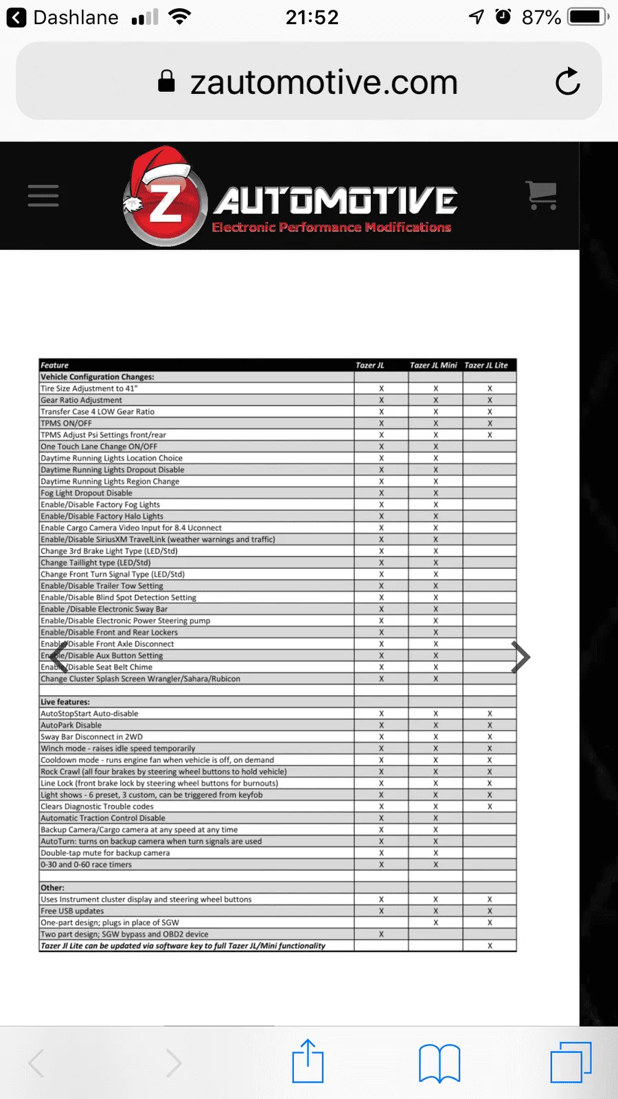

You may want to take a look at the chart at the following link:
https://zautomotive.com/product/tazer-jl-mini/
On the right side of the page it list Tazer JL, Tazer JL Mini and Tazer JL Lite and the features of each one. You may have to scroll to the right to see the chart. You may be able to see everything from the attached picture.
Believe me, I the Tazer is worth every penny.

What is the diff between full size and the mini? Web site is useless and no one responds to emails or texts. I have 19 JLR but am definitely having second thoughts on this item after reading all the posts.
Joe is a busy guy and basically a one man operation, there are several Tazer offerings and this is a quick breakdown
Tazer JL is a two piece unit that consists of a SGW bypass module and the Tazer unit that plugs into the OBDII port and it consists of vehicle settings and live settings, to utilize the live settings the main unit has to be plugged into the OBDII port
The Tazer Jl Lite is basically the Tazer Jl in a smaller package that has limited features that can be unlocked to full blown, it’s basically the bypass module and main unit combined into one so the OBDII port is free and lastly the mini is the same as the lite but it’s been unlocked and again it’s a single unit.
The latter two versions were released after the original Tazer Jl as some did not want there OBDII port blocked for various reasons so Zautomotine developed the smaller versions, also some did not want all the rich features of the full blown unit so that’s why the lite version was presented but it can be unlocked
Hope this helps
