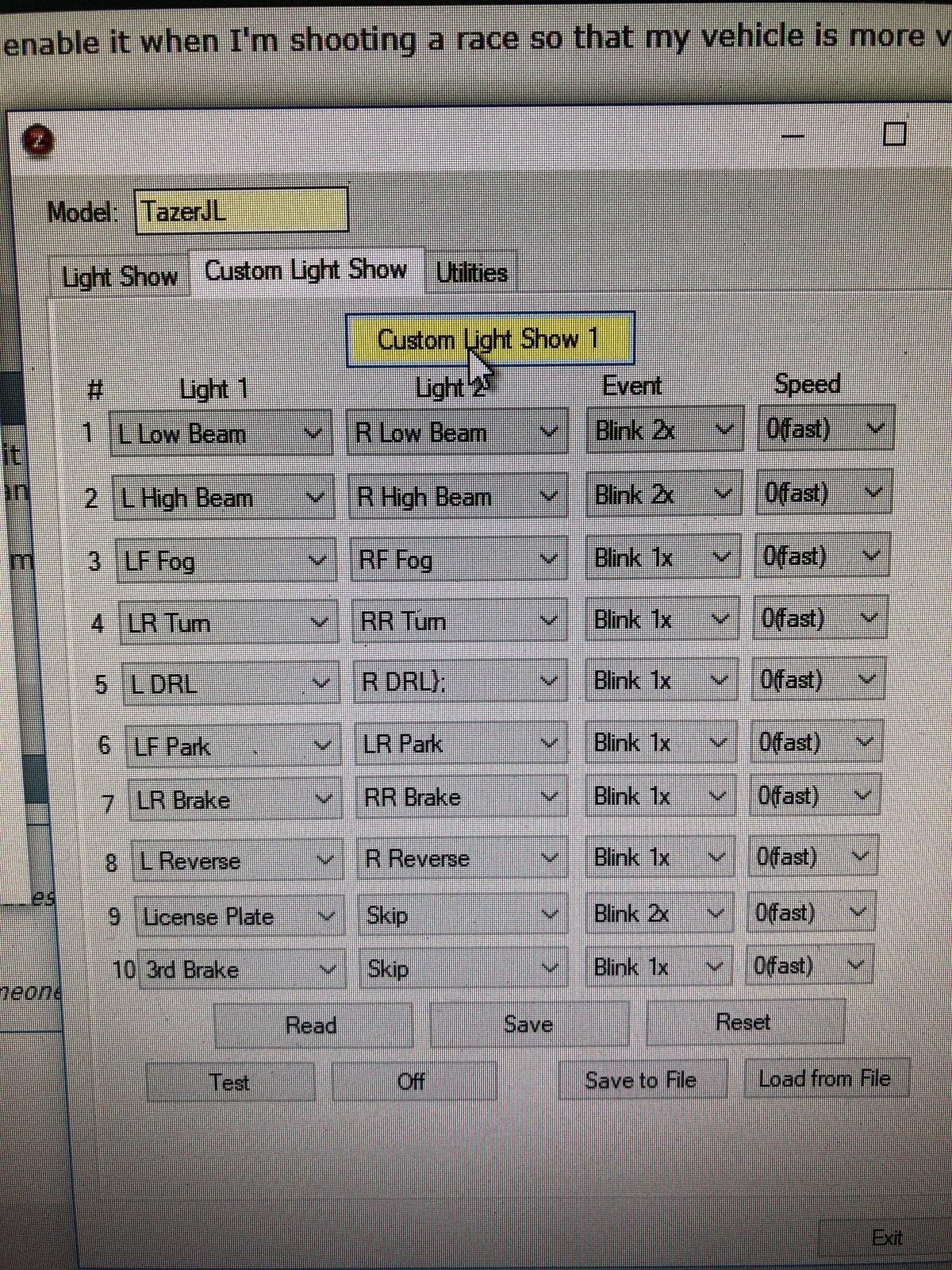

NCIC105
Aug 26, 2018
351
294
Upstate SC
2018 Rubicon
I know I've seen it here before, How do you enable the lightshow when moving...
Yes I'm a first reponder
