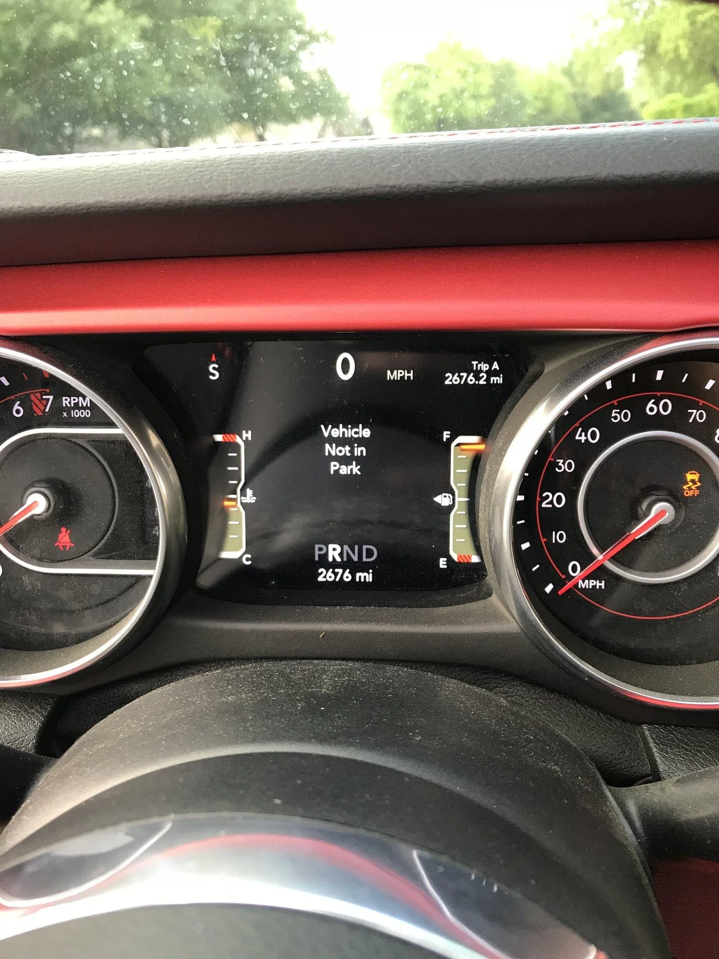

Since installing the Tazer, I notice that the following message is displayed for the first minute or so when I start the Jeep and place it in gear.
“Vehicle Not In Park”
Any ideas?
Any ideas?

Are you sure you aren’t starting and dropping it into gear really quickly? That’s the he only time I’ve seen that. What settings did you change? If you unplug the tazer (so the live features are not operatin) do you have the same message? If you unmarry, returning it to stock, does that not happen? I’m sure there’s an explanation, let’s get to the bottom of that one. First I’ve heard of this in any JL.

So it's been a few days since the initial install and many turning on/off of the ignition. I have sometimes slammed it into gear upon startup as well as patiently placed it into gear. Have not seen the message since.
Now the doors were off when I first installed the Tazer, and I'm thinking that the message is associated with the autopark sensor and door removal. You may be aware that when the doors are on and open, the vehicle will not allow you to move forward in Drive. I'll test this theory again when I have some time and let you know.
I'm mean time, I have enabled the Disable Camera Lockout option which allows me to view the camera while in any gear for any length of time. Coincidently I noticed that holding the radio Mute button for more than a few seconds will also access the back up camera. Was this by design? As this is a Live feature, I'll need to test this without the Tazer plugged in.

Yes, mine is stock (I don't own a Tazer) and I get this "Vehicle Not in Park" message on my screen while I'm driving sometimes if my doors are off. The CAN-BUS system gets confused I think. Too many computers trying to talk to each other on these Jeeps.
