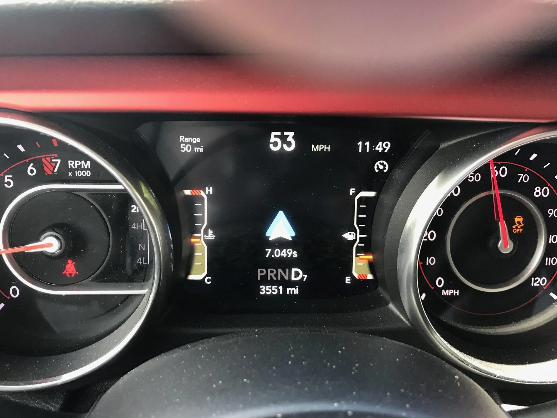

A tidbit in regard to the Tazer JL
When you get your Tazer and have a chance to lets say play with it, you will notice the 0-30 and 0-60 feature and wonder, what is that all about....
Anyway, they are race timers. Yup, RACE TIMERS.
Sure not too many people are out there trying to rip the best 0-30 or 0-60 times in their JL/JLU but there are those that might want to gauge if their large tire gear swap actually helped performance, etc..
I had one guy message me and say his JLUR, automatic , pulled several 7.0xx 0-60 times. Not bad for a Jeep...
Anyway, in case you were curious what the 0-30 and 0-60 were all about, now you know.
Undoubtedly, Z Automotive already had the algorithm developed from the cars, so they figured we'll go a head and put that on the Tazer JL just for the few that might appreciate having that feature.
And in regard to features to come, I know Z Automotive has a list of features that they are wanting to add to the TAzer Jl. Two things that list are camera control and auto park disable..
I tried it out. Not bad for 35s....7. O4 seconds
