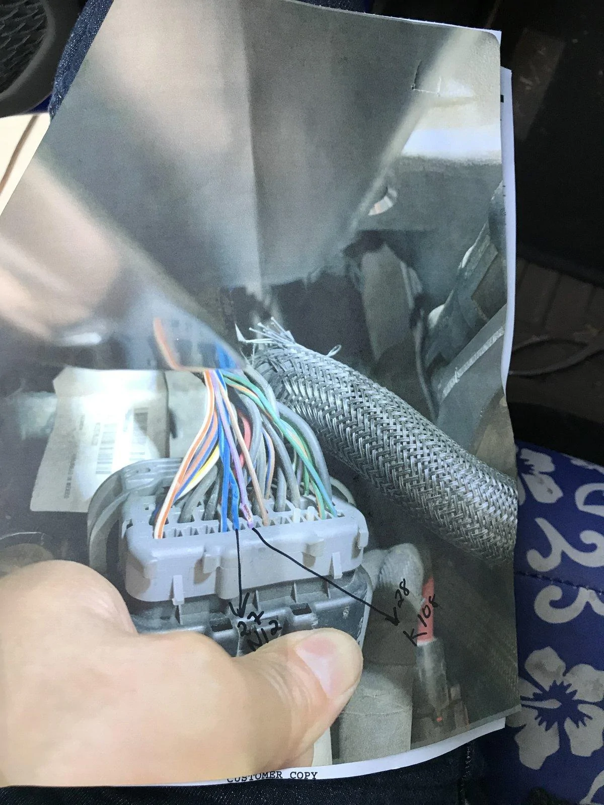

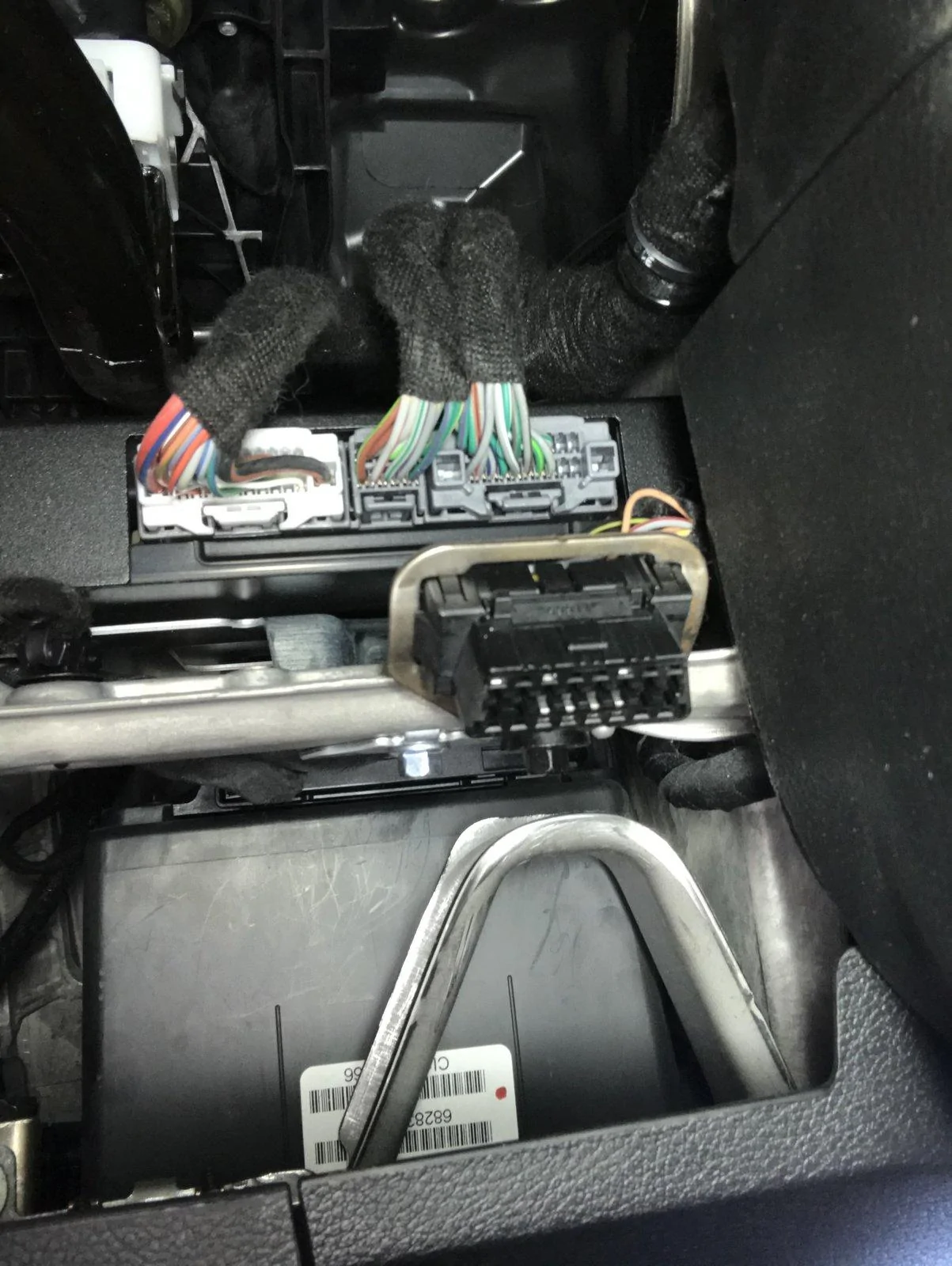

I have a taser mini in my 2019 JLUS and it works great.
I had a check engine light come on so I unmarried it and I had it in service about a month ago and there was some sort of smog leak. I remarried it and it worked great. Couple days after I got it back I had the same code come up. So I went back in the shop. I unmarried it again. When it came out of the shop they showed me a picture of wires that had become exposed. So they re-wired it with a new (larger) connector, so now I can’t plug my mini in.
Anybody have anything like this? It looks like my fix would have to be a new connector to come from joe@zautomotive. Any suggestions?
Thanks
