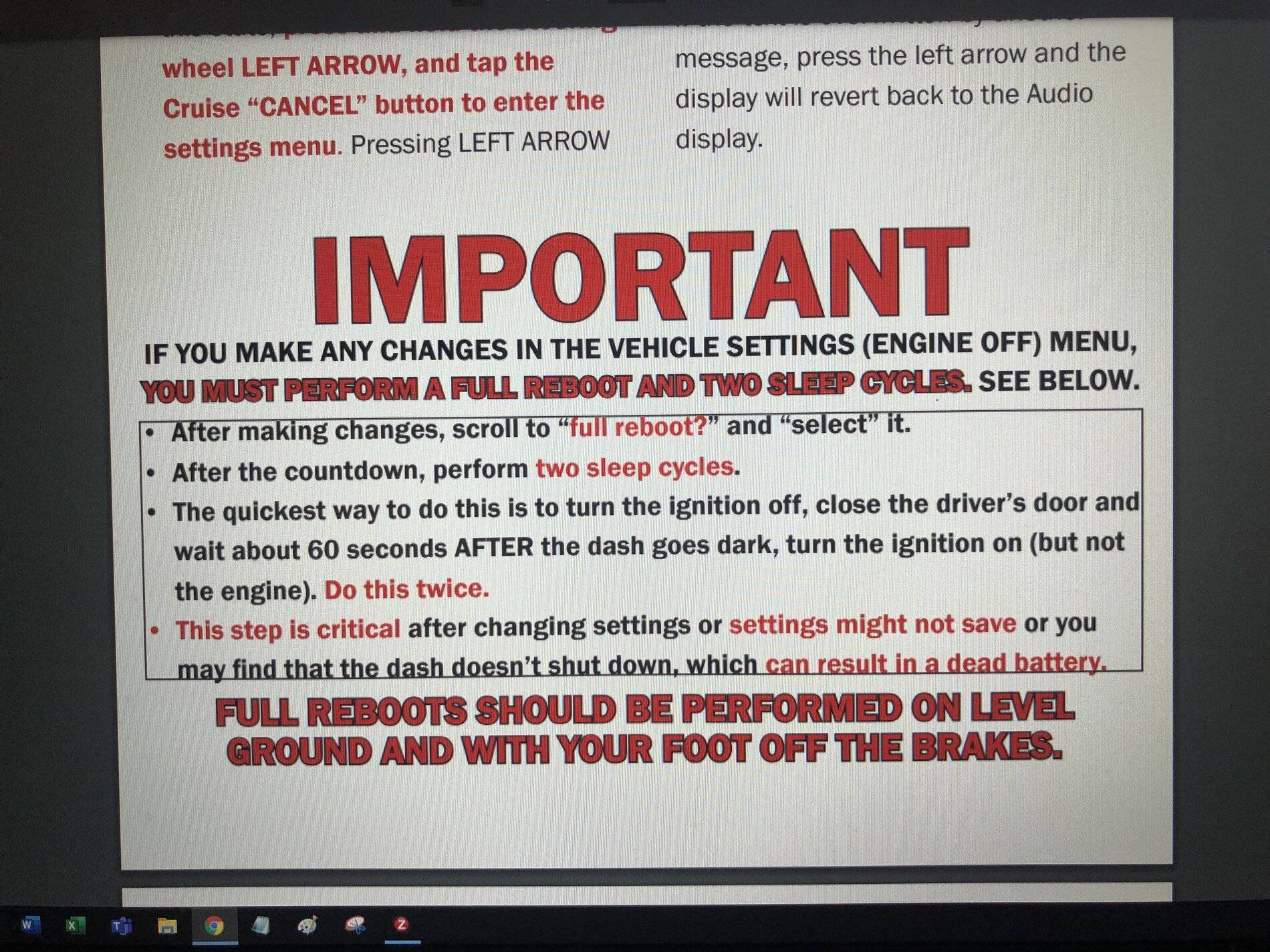

The instructions for the two sleep cycles after the full reboot does not make sense to me or I am not reading it correctly.
The instructions for the sleep cycles states:
"Turn the ignition off, close the drivers door and wait about 60 seconds after the dash goes dark, turn the ignition on (But do not start the engine). Do this twice."
My confusion is with the statement "close the drivers door". - The door is not open because I am inside the vehicle with the door already closed. I interpreted this statement as "Open and close the drivers door"
Also the statement "Turn the ignition on (But do not start the engine)" - I interpreted this statement as turn the ignition to the run mode but do not put your foot on the brake (To prevent the engine starting).
Am I correct with my two interpretations as mentioned above.

jludave

Thank you so much for your help, I highly appreciate it.
