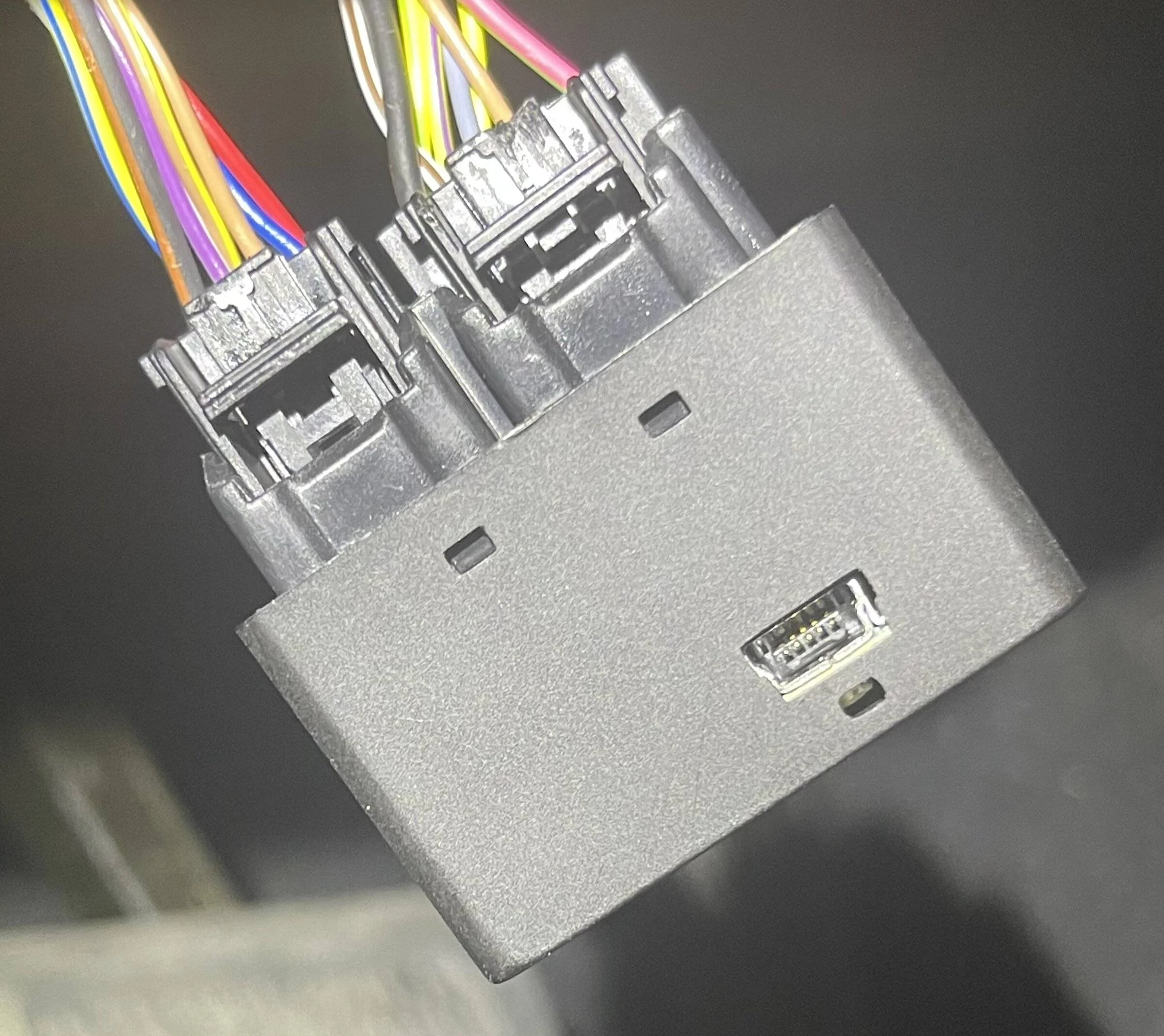

I’ll contact Joe.But I’m pretty sure I’m connecting it to the right place.
JLPilot
Oct 6, 2021
Comifornia
2021 JLUR
Looks like you have the cables installed in the right place. I just went through something similiar. It was entirely aggravating, as I used a Mac and it didn’t work- couldn't/wouldn’t recognize the Taser.. It wasn’t until I switched to a Windows machine that the Windows version of the utility recognized the Taser and updated it, but only to 11.3.0, not the latest, 11.3.1, even though I tried to update it to the latest version 4-5 times. Anyhow, the Taser is awesome and I’ll never drive the Jeep again without it- too many goodies you’re gonna love… I just wish they’d make the programming utility a little less buggy 😊

Thanks for your input. On my side, I’m using a windows machine and it actually took the 11.3.1. When it wasn’t working, i plugged it back in to the windows machine using the USB cable and tried to update to 11.3.1, and it show me that it had the latest firmware already updated.
JLPilot
Oct 6, 2021
Comifornia
2021 JLUR
Almost sounding like a hardware issue with the Taser if it’s not lit/blinking. I used the recovery portion of the programmer utility and that worked, however my lights were already on/blinking. I’d wait to hear back from ZAutomotive for your next steps.
