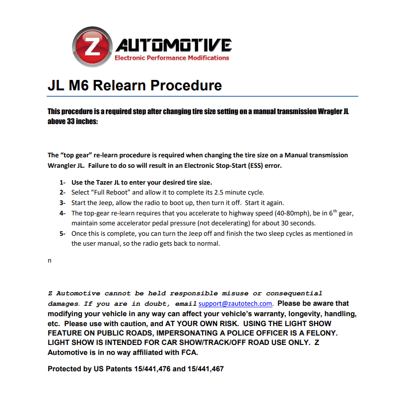

the Tazer instructions also get updated as the unit does. I've used it for the past 3 years on two different Jeeps, one diesel, and it has worked great. The biggest thing I've found to cause problems is if you don't go through 2 key cycles after reprograming. Oh yeah, for the manual, here you go...
I'm aware of that sheet. I read and followed it multiple times.
Please tell me which instruction number tells you that you may also need to disconnect the battery for 30 minutes to finish getting the Jeep to accept the new settings?

I followed those instructions multiple times, as did the shop that installed my gears and tires. Finally, on this forum, I connected with a couple other owners of 6 speed JLs. They both confirmed that for the new size to fully be accepted, an additional step, not listed in the manual, needed to be performed - disconnect the battery for 30 minutes to reset the computer. (I won't describe those steps here. Suffice to say that simply disconnecting the black negative terminal on the main battery is NOT sufficient.)
THAT was the magic incantation to get ESS working again with the new tire size.
SO TRUE. I have asked them multiple times to add this to the instructions. When I downsize the tires is when I see it happen the most. I am old blonde and forgetful and by the time they respond I remember to pull both the batteries. I only learned of said instruction after I submitted a support ticket.
I also do not think this quirkiness is the Tazer as much as its Jeep programming.
