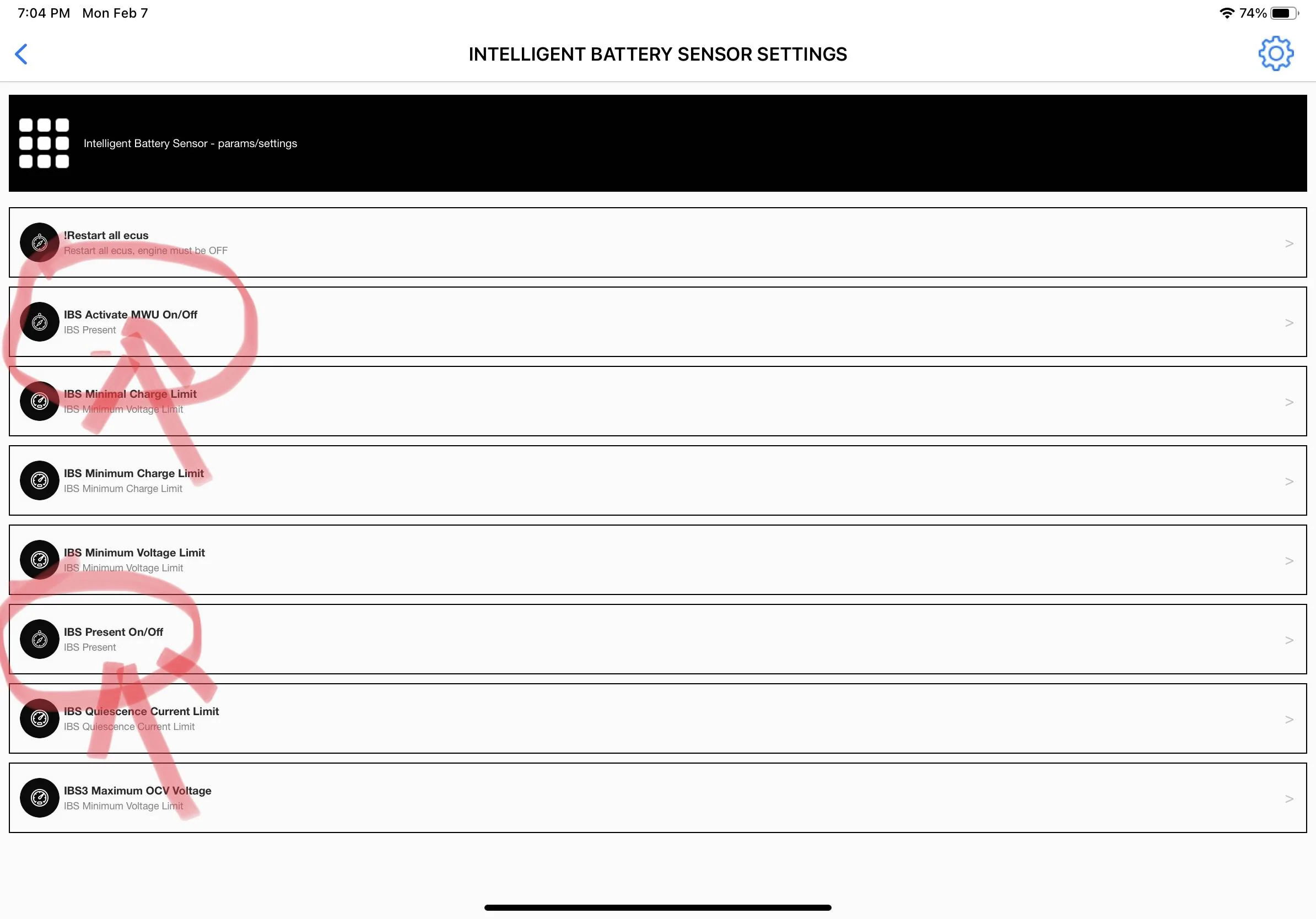

Do what I did, get a Smart Stop/Start module for ESS if that’s your thing, mine has been in for several years and works perfect then get JSCAN and make what ever changes you want from the host of all it has and be done.
Don’t get me wrong the Tazer offers a lot and support is top notch but all this marry/change/unmarry stuff is just to much to keep up in.
Also if your having battery issues don’t instantly just to point out it’s the Tazer as there are a host of other things that affect batteries like proper charging, battery age and a little device called the IBS which I have disabled.
For me since disabling the IBS my charging system has be a lot more stable.
Same for me--dumped Tazer for JCAN. I never liked the idea of the requirement of having something attached "permanently", the fact that it does not write the changes into the PCM, AND there is the whole marry/unmarry BS that returns all of the settings to OEM when you do it.
With that said, you need to have a good quality OBD2 scanner IF you are going to leave it connected for JSCAN. Some of the cheaper units "wake up" and can drain your battery as well. @WranglerMan - what did you do to disable IBS?
I have several OBDII BT modules and even the pricier ones I never leave plugged in, I just keep one in my center console.
There really is no reason to leave one plugged in all the time since there are no live features like the Tazer unless you count the Trail View which I played around with but it’s no off-road pages ?
For me and my setup since I run the dual Genesis battery setup I was having some random issues with battery protect mode and this may be due to the fact the IBS is connected to the aux battery and since the Cole Hersey really opens and closes based on the smart relay it gets confused on charging so after I did some testing and talked with Jerry about this the options are to move the IBS to the main battery but I found the IBS disable setting in JSCAN and opted to disable the IBS rather than move it for a test and after I did I still have the smart alternator feature but the IBS is not visible since JSCAN tells the PCM/ECM it’s not there and the error messages went away and my batteries charge smartly like it always did.
Its also possible that the IBS can have issues since one of its functions it is to wake up at a predetermined time to check battery health and if it determines that voltage is getting critically low it directs the ECM/PCM to power things off but if the IBS has issues it can keep waking up more than it’s supposed to and cause the battery to drain prematurely.
Thanks for the settings; I'll add them to my collection.
For the OBD module "waking up", that was for the OP in case they weren't aware.
