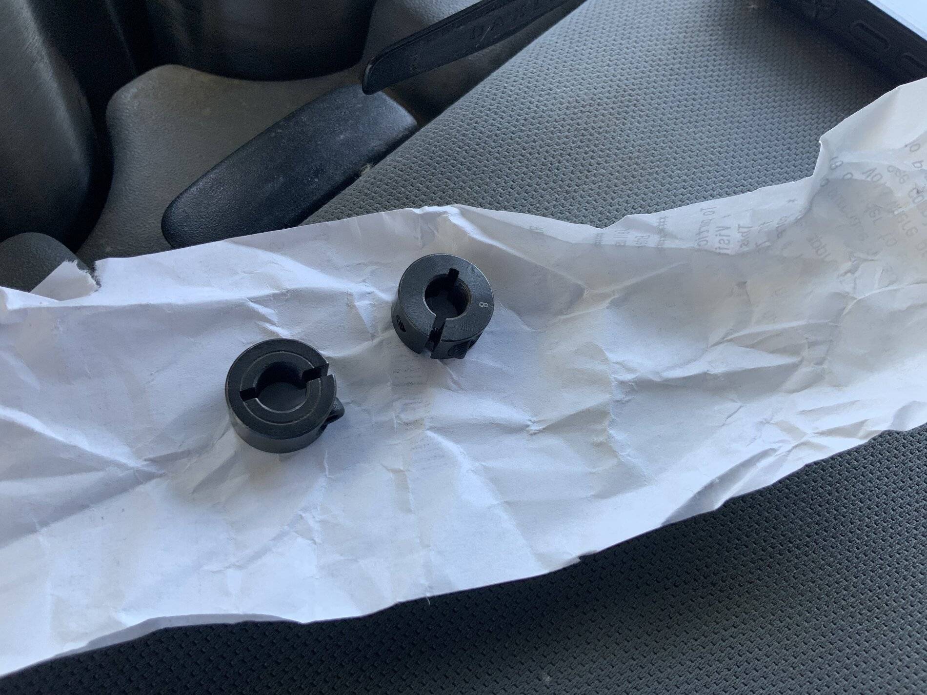

I’ll be joining this DIY repaired visor club this weekend. My driver side one is broken and I’m gonna go ahead and do the passenger while I’m at it. I found these sweet 8mm clamps at my local Ace hardware store. I’m gonna try and slide the wires through the opening for a quick easy fix!

I just did my broken drivers side. Took about 30 minutes. I used an oscillating saw to cut down the plastic on the visor stem and the mount. Then a dremel and razor blade to get it lower. Then the oscillating saw again to get the plastic even lower and more level. I put the clamp I bought in a vise and spread it open a little more so I didn’t have to mess with the wiring at all. then the clamp wouldn’t close without trying to strip the Allen wrench. I pinched the clamp with vise grips and that did the trick.

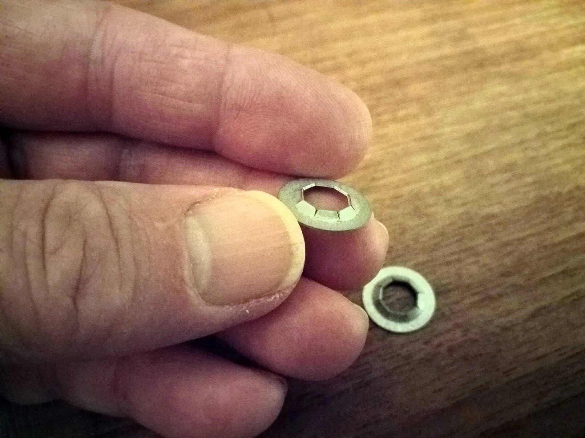

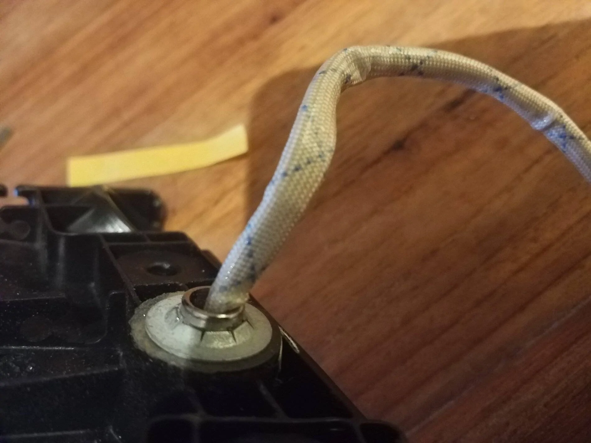

I'd just like to report that 20 months later, the repair using the push on metal retainer has held up on both sides and has not loosened at all. I had completely forgotten about it and use the visors like any other vehicle, including swinging them to the side. I know they don't look like much, but these retainers have an extremely high retention rating .
