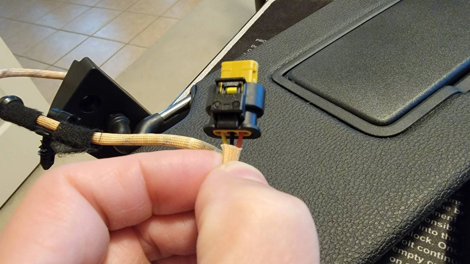

Repaired mine today. Seems to be working well. I could not get the stem to stick out back the base as much as @roaniecowpony did, but the retaining ring is well onto the shaft and in the grooves. Hopefully, it is fixed for good now.
Photo of the repair and the wires (in case someone forgets to take a photo ahead of time):
