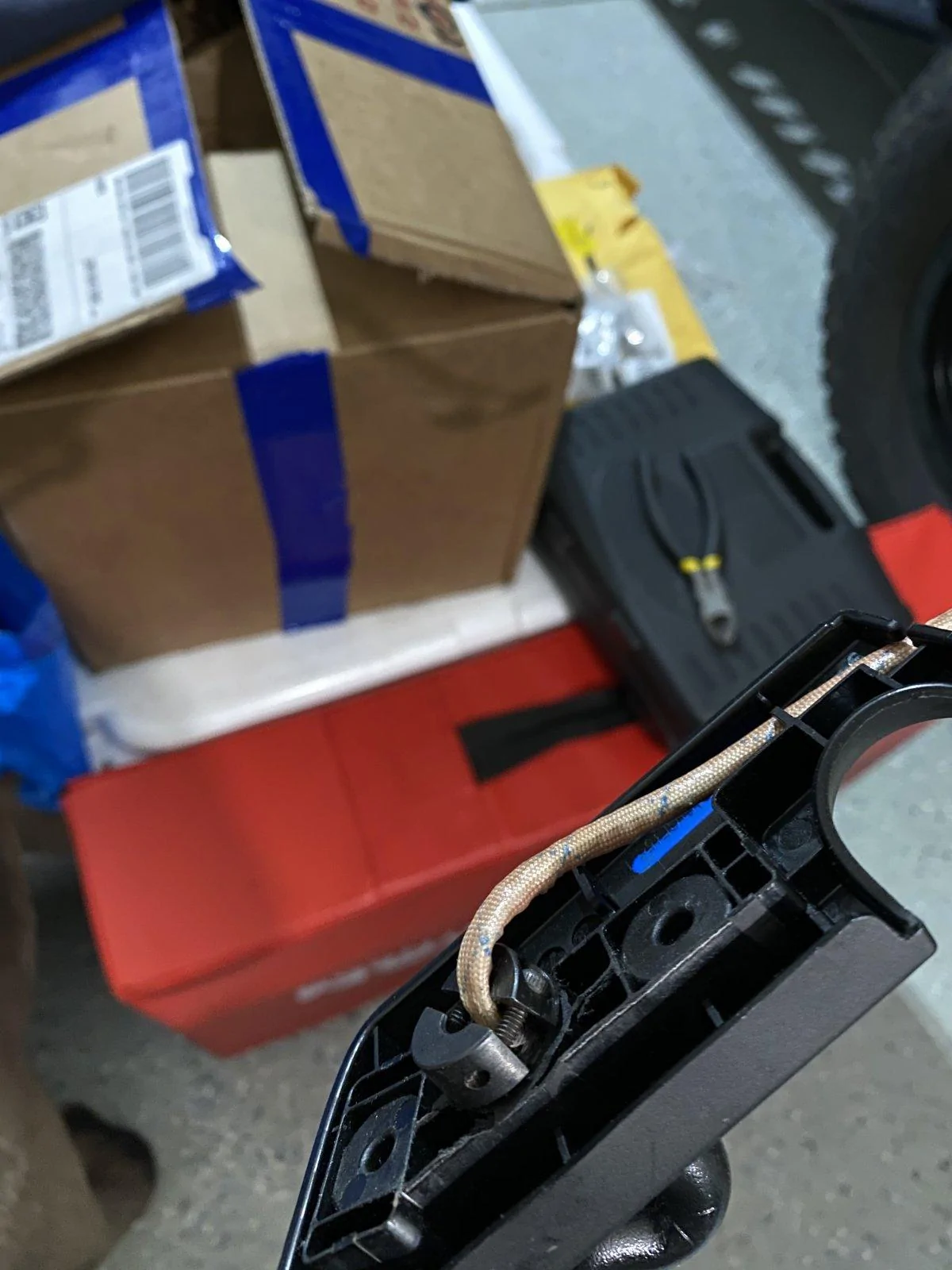

Not sure, but might be best to go the next size down on that 2pc set. Since the ID is 5/16 and you clamp both set screws down it's still 5/16. The collar w/ the 1 set screw goes into the shaft so it secures into it. Might not get enough clamp pressure since my 5/16" single screw collar just slides over that visor shaft and is loose until that screw secures it.

that’s what I’m thinking as well, I ordered a 5/16 and 1/4 set. I will report back which one works best.

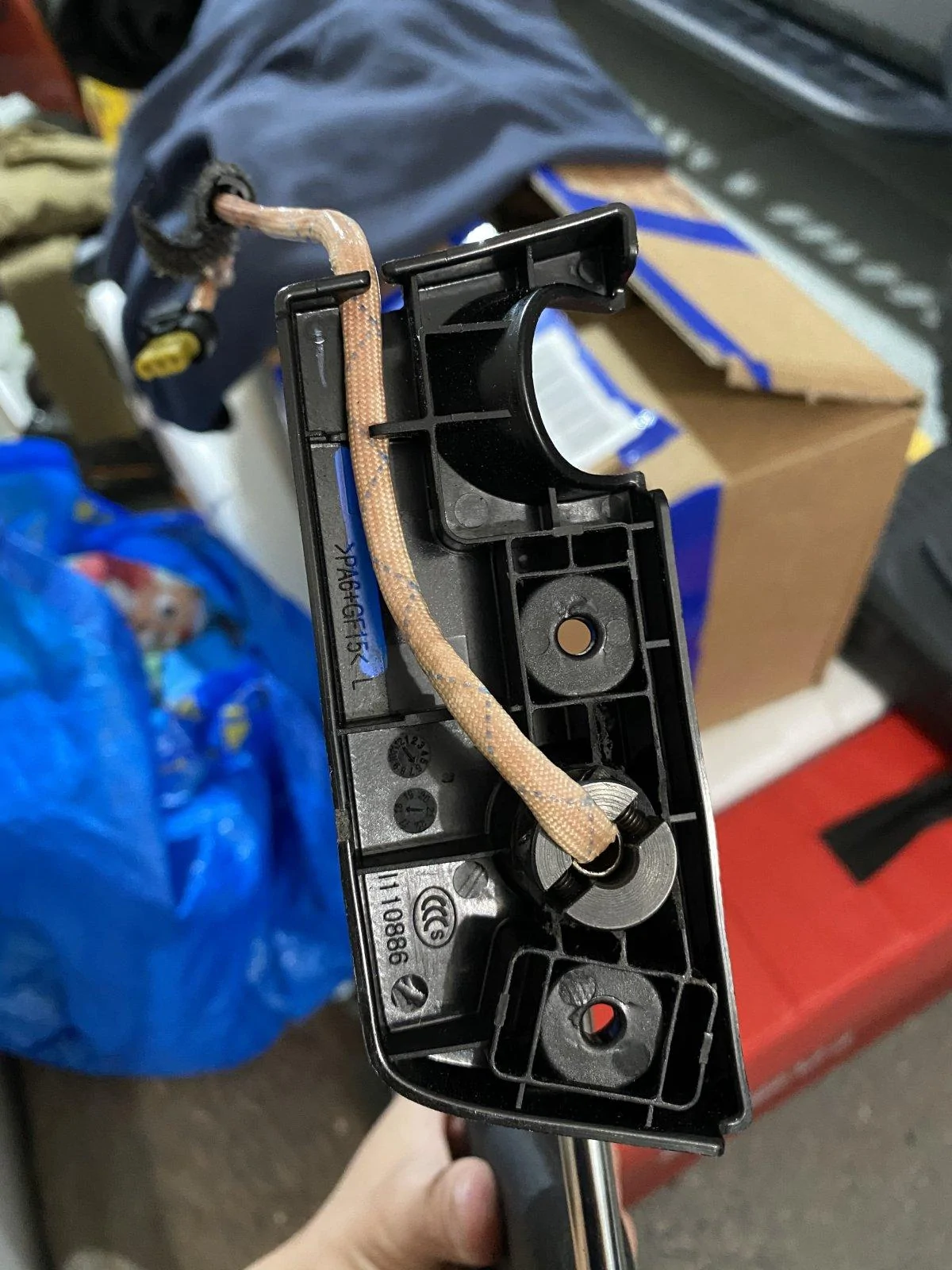

Thank you so much for this post! It was a great guide to fixing my own driver’s side visor.
I bought the Jeep used about 2 months ago and didn’t check the visor. First time I adjusted it, it fell and hung crooked and was no help at all, of course. This provided a great fix. I ended up using the split collar so I didn’t have to do as much with the wiring.

I ordered one that 15/64” (don’t remember how I cam up with that one) but it was too small. I ended up running to Ace Hardware and purchased one that was 8mm. Fit great.

Those ought to do it. 8mm or ÂĽ" bore is the right size.
Good luck.
A correction to the above the visor tube diameter is .312", which is 5/16" or within an RCH unit of 8mm (.315"). Not 1/4" (.250").

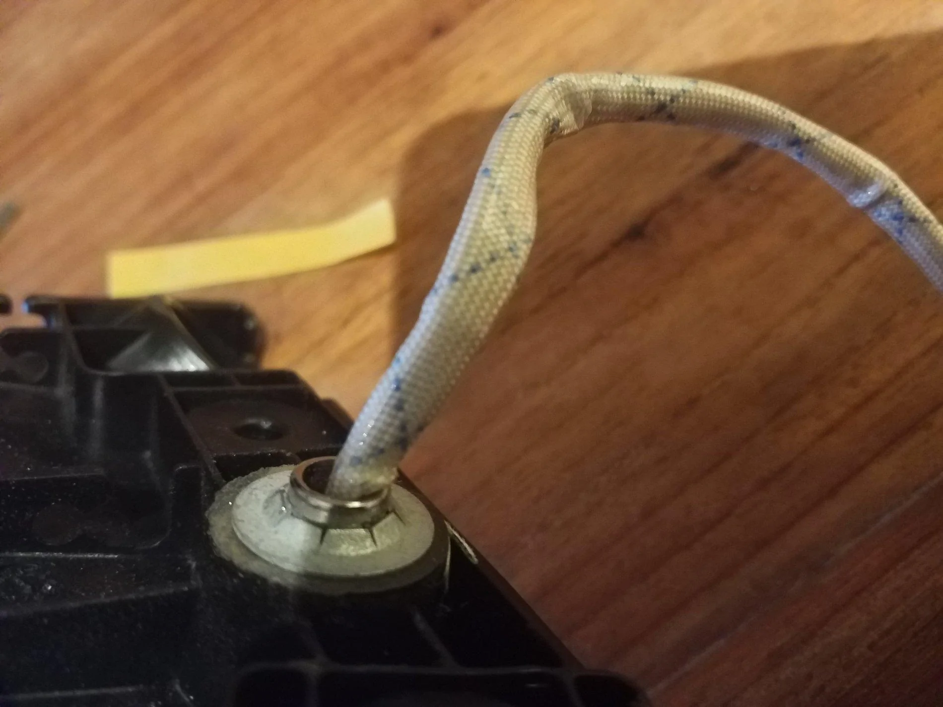

Just an update. My original fix with the flat push on retainers is holding up after a year. I've used them like a rental car and swung them to the side and drove like that on a bouncy freeway. I believe the push on retainer has a much higher holding strength than collar-setscrew. But I get that its more work to de-pin the connector.
