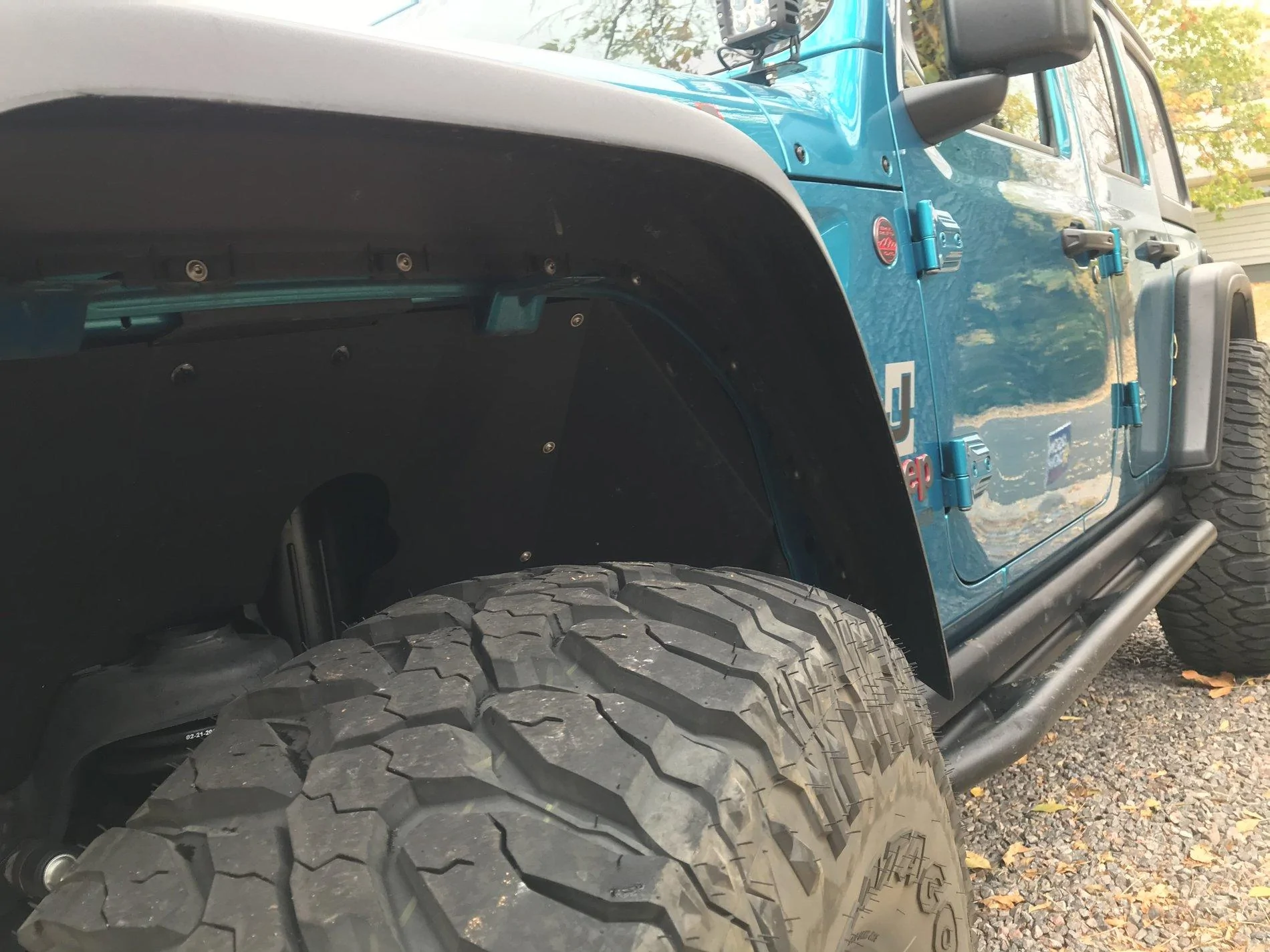

I just used a dermal and shaved the plastic back as above post. I 3d printed an 8mm split collar with 3mm nut and screw. No need to de-pin anything. Visor works fine and I can make unlimited parts if my 3d collar fails. https://www.thingiverse.com/thing:2940715

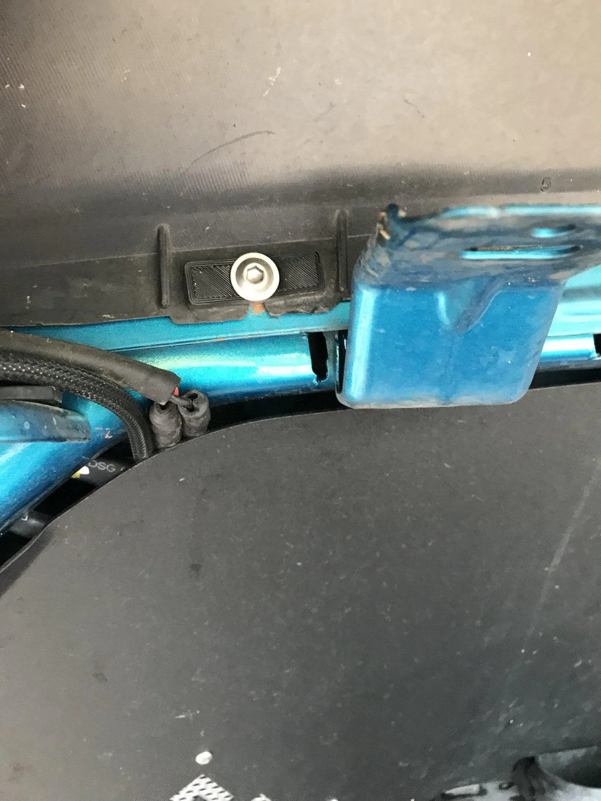

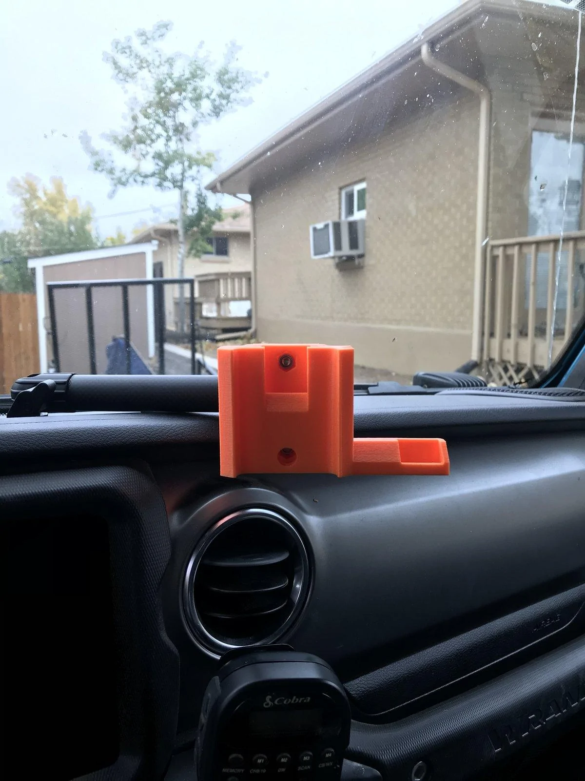

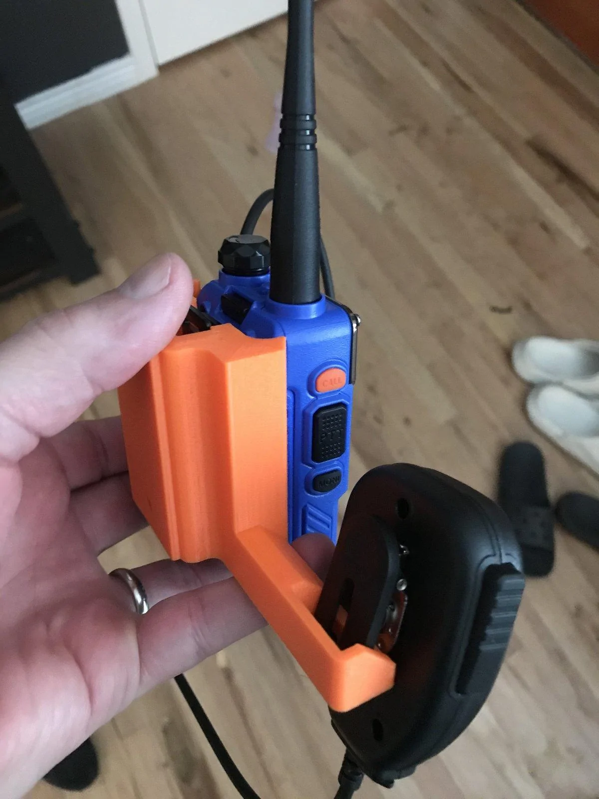

Yes I have my own 3D printer. It’s very useful. I needed a ball mount for my Radio and mic so I printed one, The inner fender clips that bolt on are 3D printed. The go pro mount is 3D printed.

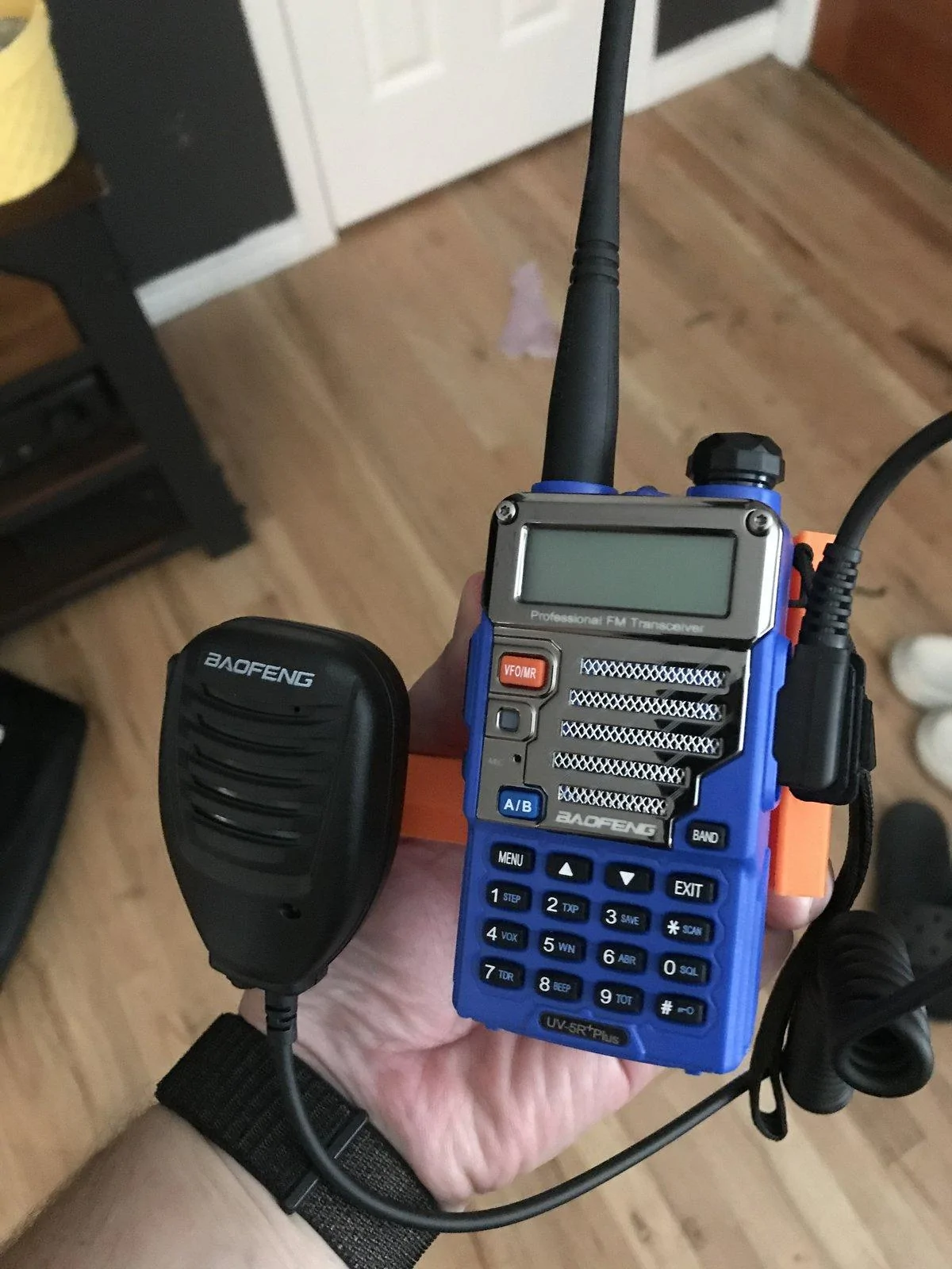

How do you like that Beofeng radio? I have been watching a couple of those but would like to handle one or get an opinion from an owner before i pulled the trigger.
For the days I go out and no one has a CB it’s a great alternative. They are very reasonable to buy and work great. As you can see in the pic I got the Optional Mic and 3D printed a mount. The range is more than I have ever needed. If your very tech savvy there is a gazillion programming options you can do from your computer.
