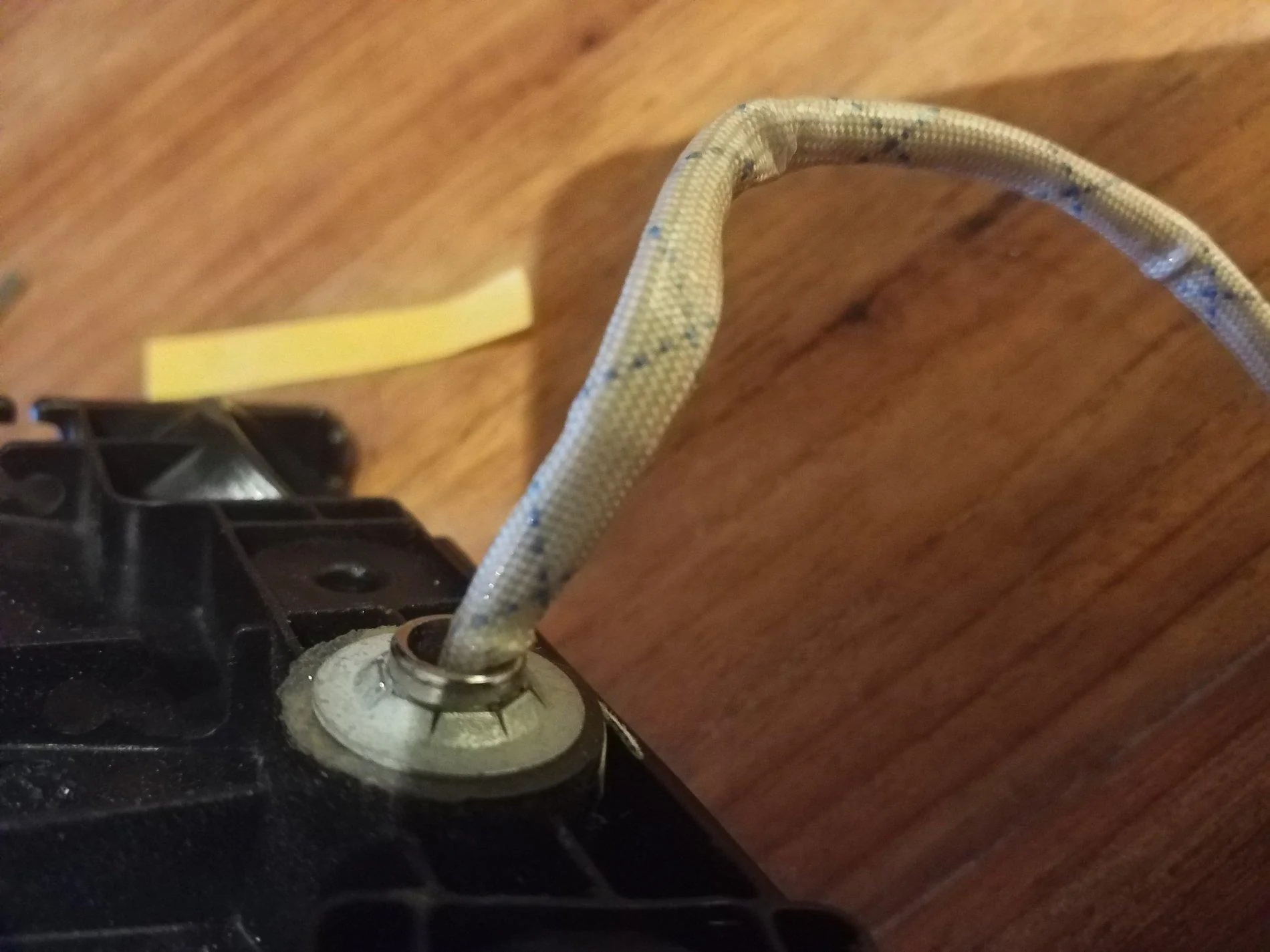

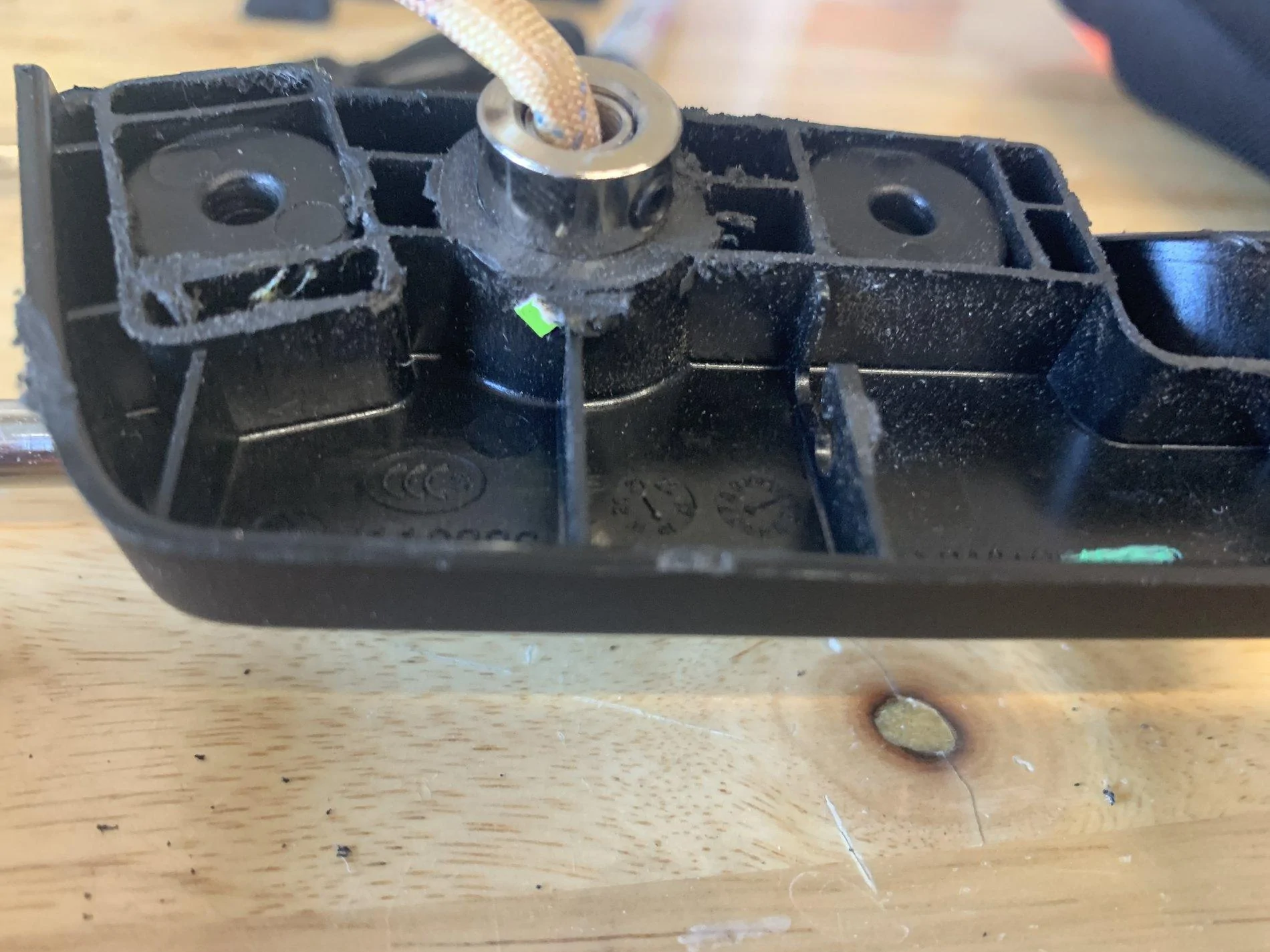

It's been a few months since I fixed my visor with the push on retainer. I've been using it quite a bit and even treat it a bit rough on purpose. I also flip it to the side to cover the side window, which is probably what broke it in the first place. So far, it's held up.

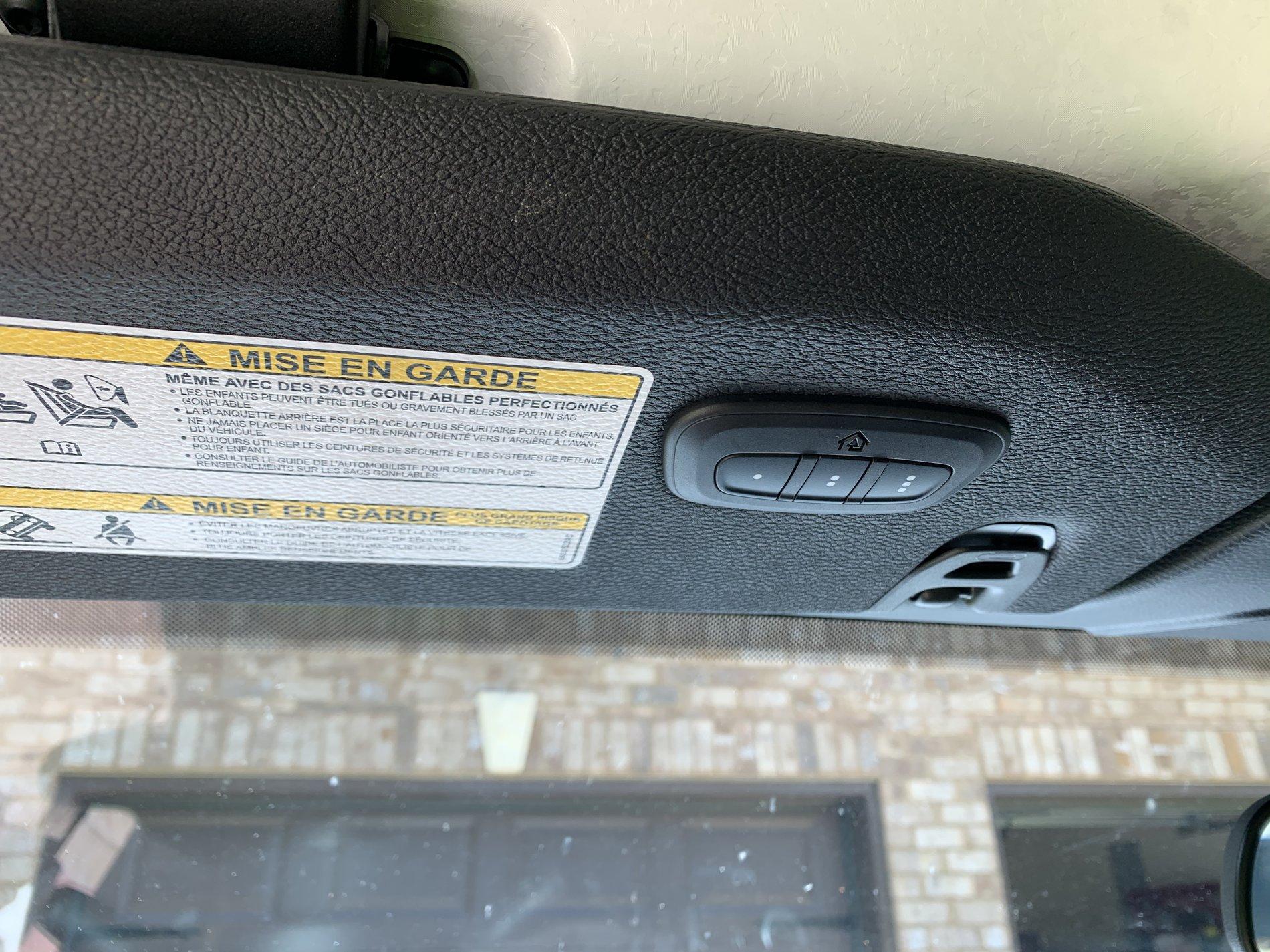

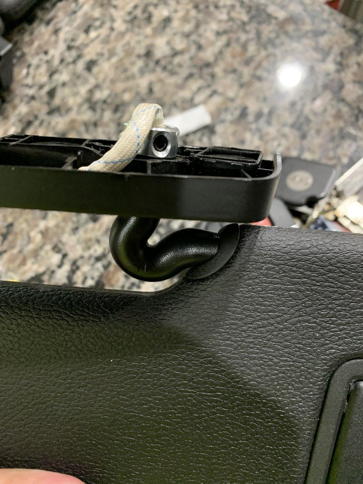

Used the shaft collar method for mine. Looks and feels solid. Thanks for the idea. Was able to pick up one with homelink cheap!

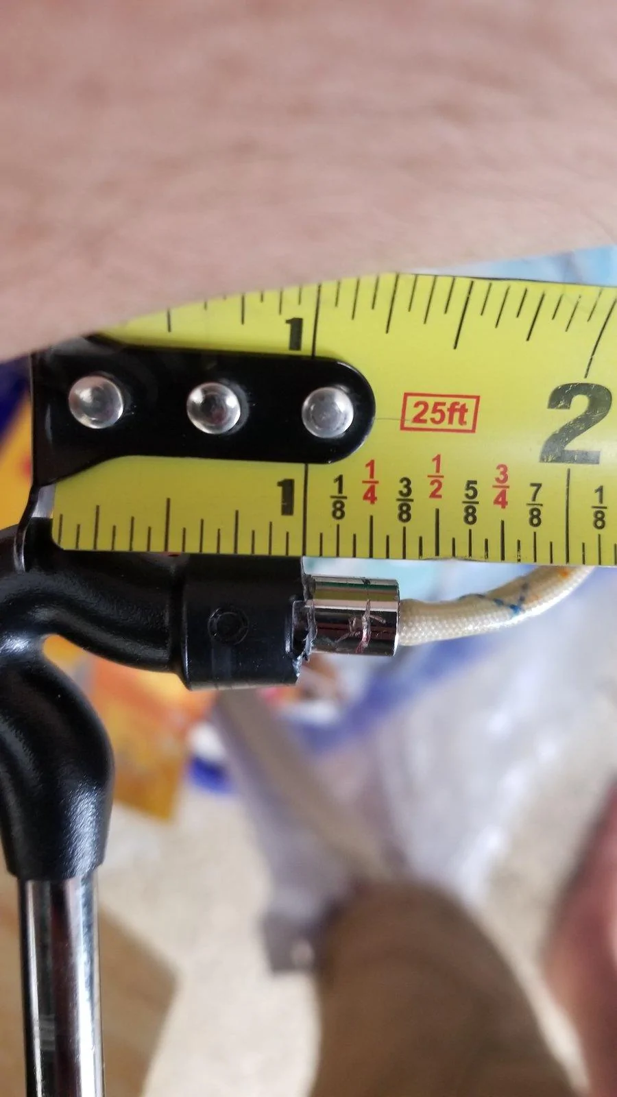

You need to remove a good bit of plastic from the shaft and from the mount. I removed about 3/8 of the plastic from the shaft.
Jeep Wrangler JL Sun Visor Fix 20200808_150611

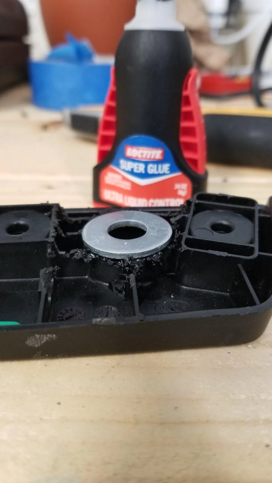

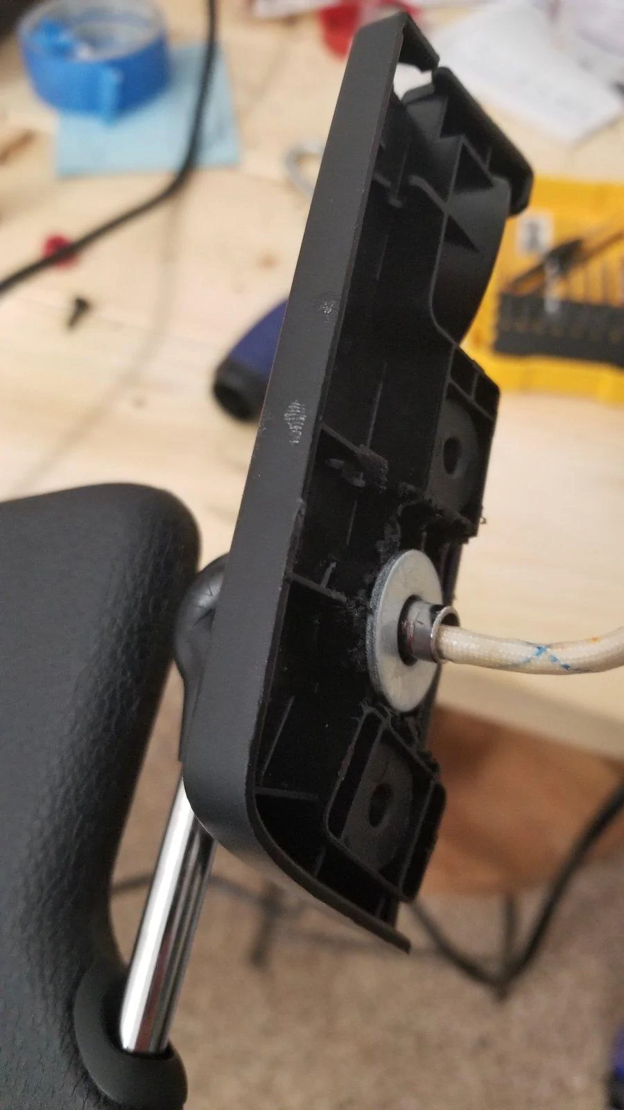

Then, I had to remove enough plastic from the mount to allow for a metal washer. I did all the plastic removal with a dremel. Here is what the mount looked like after removing the plastic:
Jeep Wrangler JL Sun Visor Fix 20200808_144120

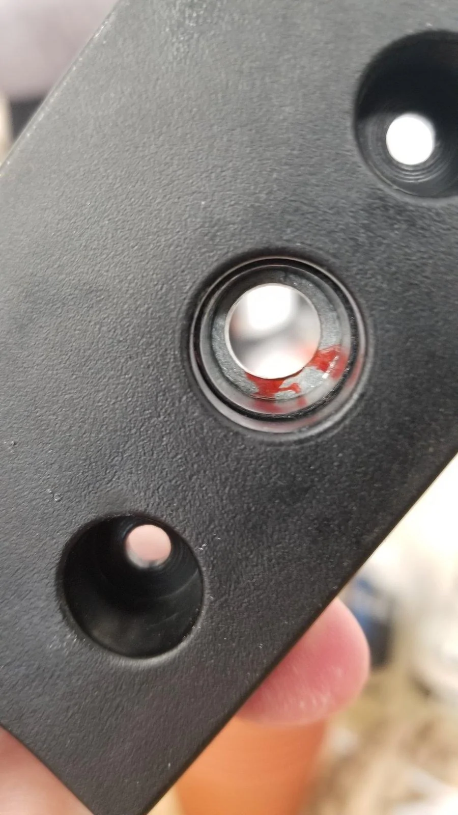

Note that I removed plastic from ALL AROUND the shaft hole in order to fit the washer. Washer is simply a 5/16. I locktite super glued the washer to the plastic mount. Be careful. Let it set, and make sure it is centered. Here is what that looks like:
Jeep Wrangler JL Sun Visor Fix 20200808_145720
Mine should have been slightly more centered, but it works in this position. The red paint is of no importance on the washer.
After 10 minutes, the glue was set. I added a SMALL amount of grease to the top of the washer.

From there, I re-inserted the shaft (already trimmed to remove plastic and reveal 3/8 of metal). I dont know the amount of metal shaft that protrudes above the metal washer, but it will look like this:
Jeep Wrangler JL Sun Visor Fix 20200808_151053

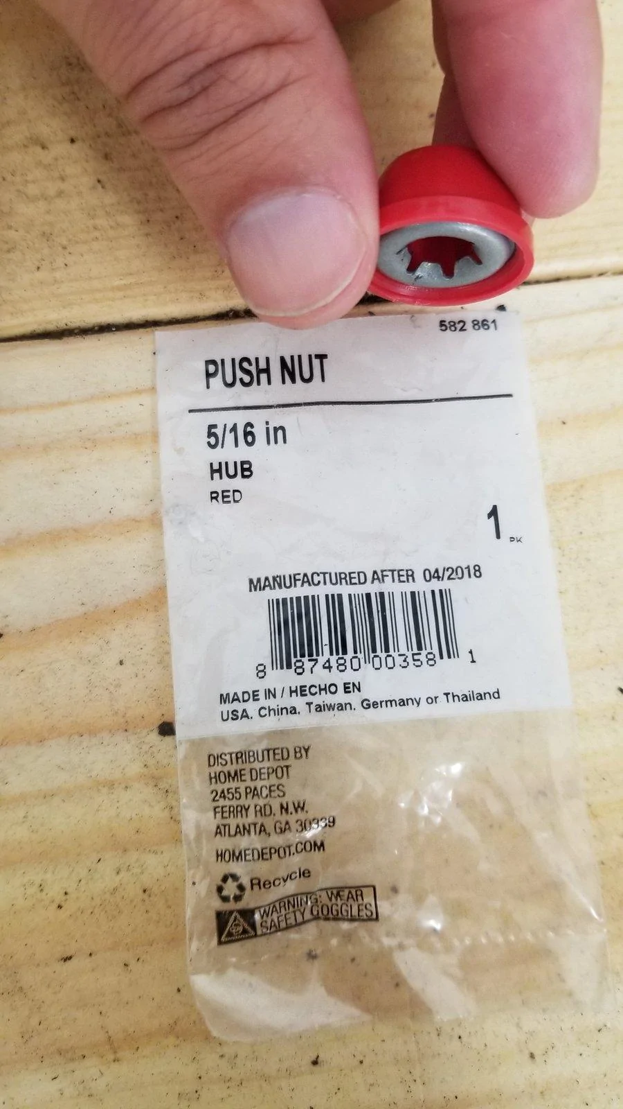

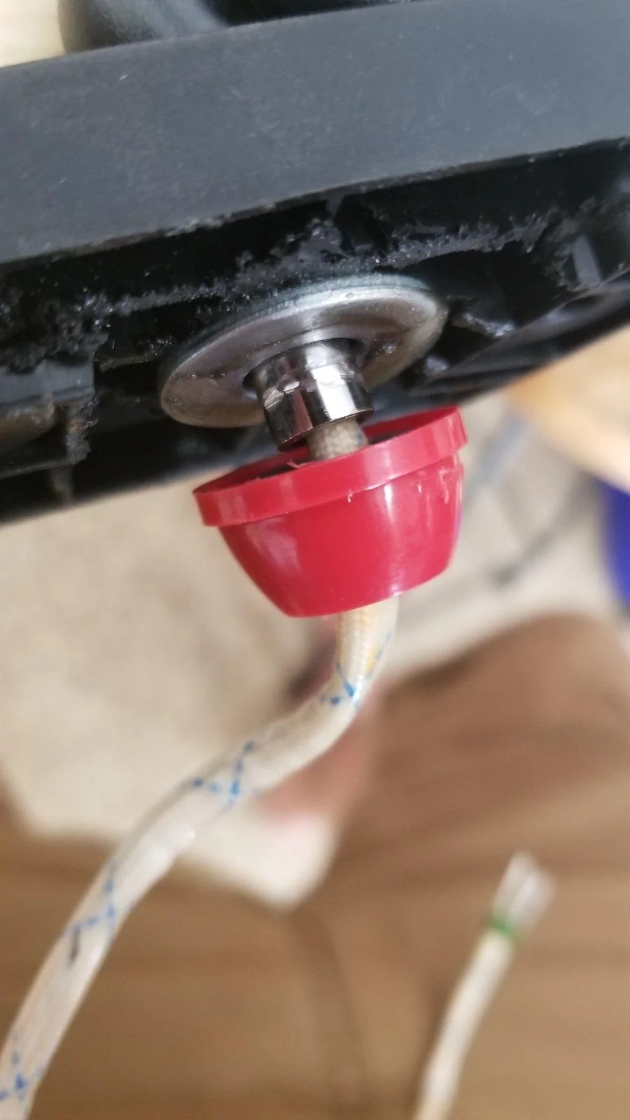

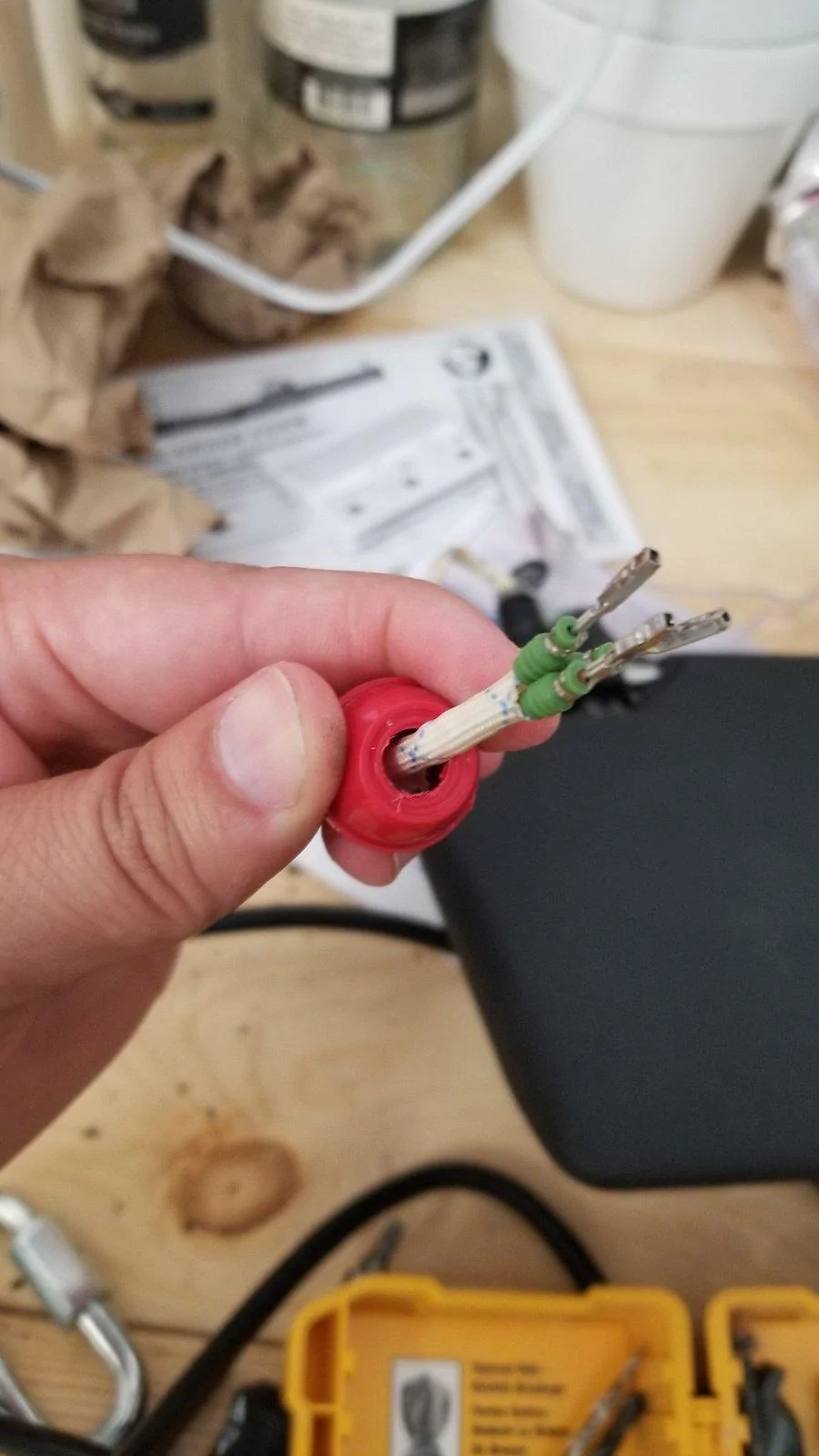

I bought 2 push washer / retention nuts from Home Depot for $1.00 each in the hardware section in the sliding drawers.
Jeep Wrangler JL Sun Visor Fix 20200808_143755
The cap is plastic. Drill a hole in the top large enough to allow the wires to come through (hold nut with channel locks on a table).
Jeep Wrangler JL Sun Visor Fix 20200808_145316
The wires will pass through easily.
Jeep Wrangler JL Sun Visor Fix 20200808_145335

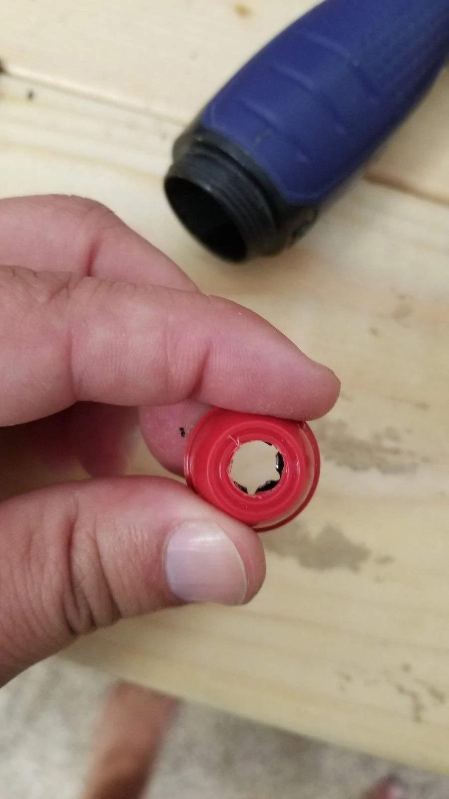

The red nut will pass over the shaft, pinch the shaft and hold it in place. BUT it needs to grab something on the shaft. I used to dremmel to carve/scratch a line around the shaft.
Jeep Wrangler JL Sun Visor Fix 20200808_151706
You can see a bit of the line on the shaft in the above photo.

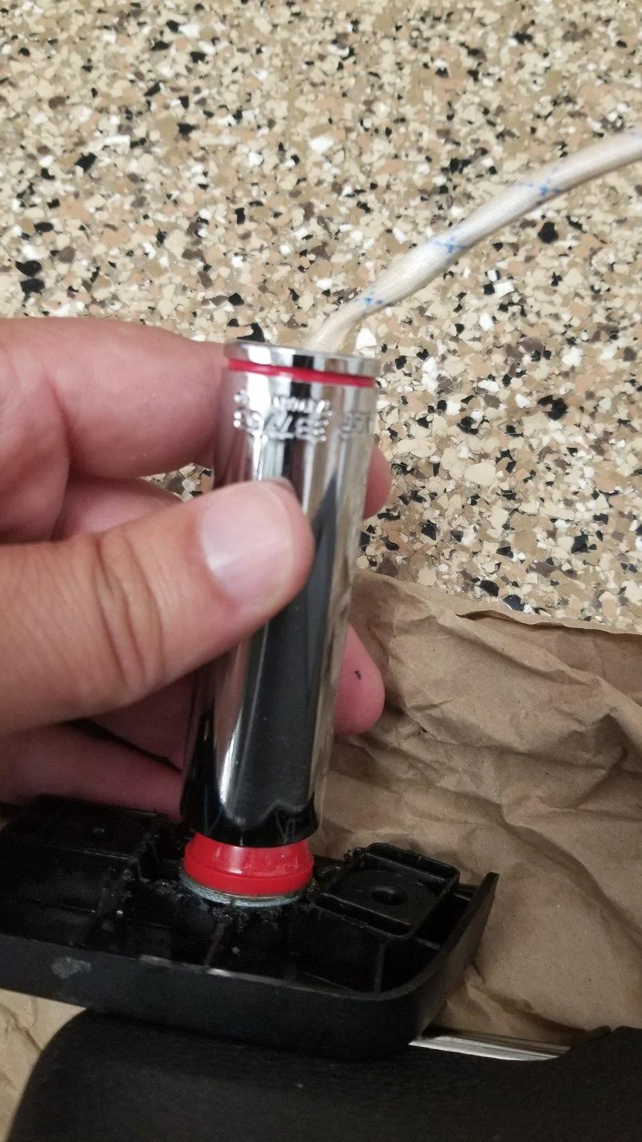

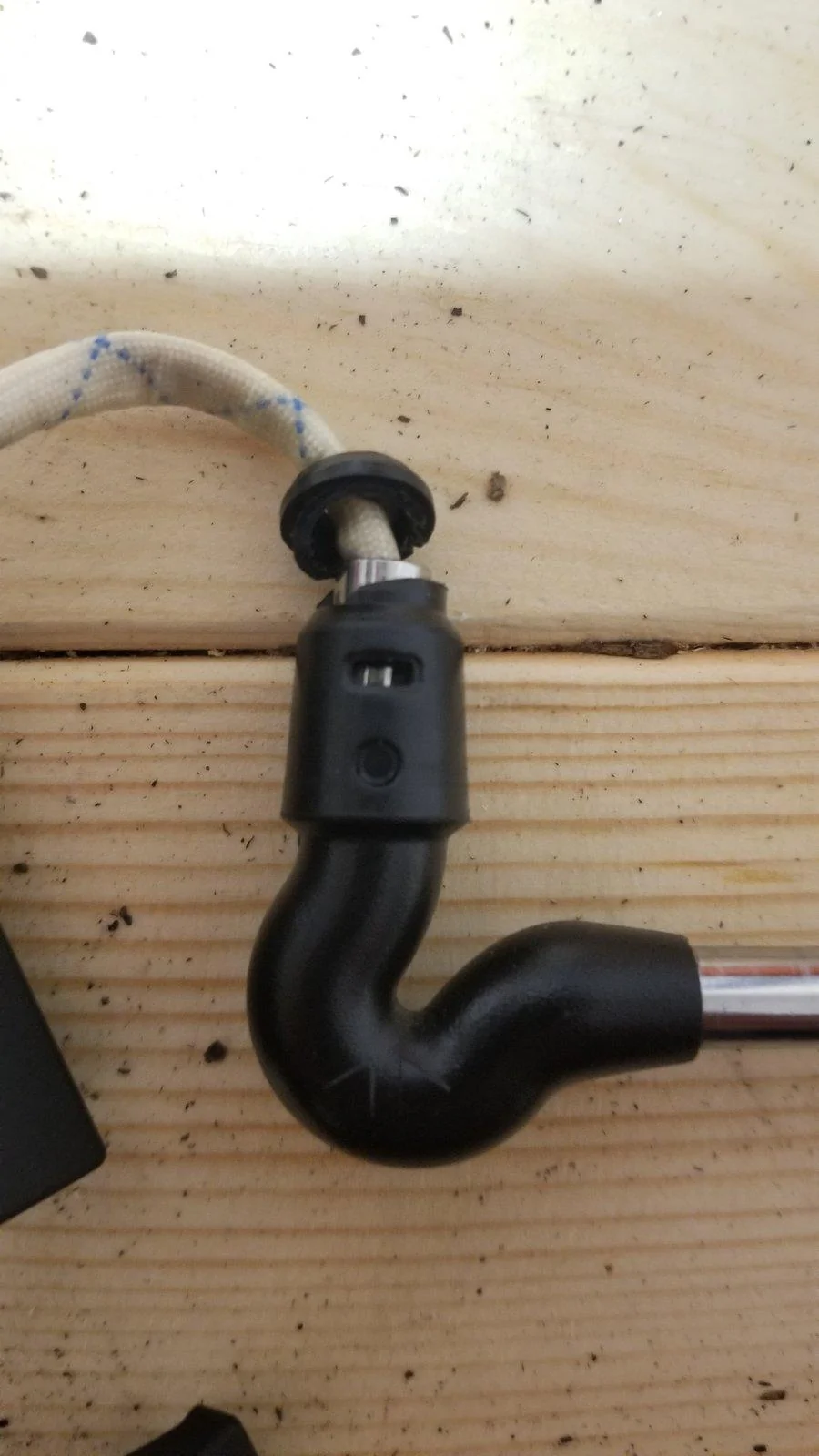

You will have to really press hard to get the nut and lock washer down the shaft. The red nut MUST go all the way down to and TOUCH the washer that is super glued to the plastic mount. Any gap will allow wobble and rattle.
Jeep Wrangler JL Sun Visor Fix 20200808_152229

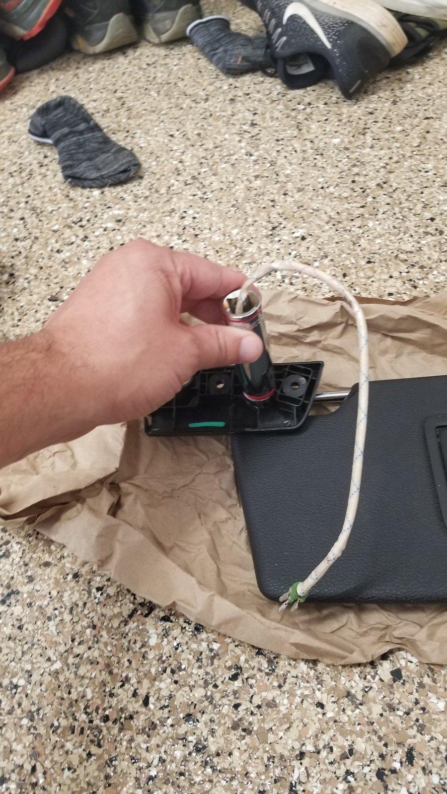

I used an 11/16 deep socket, ran the wire through it and set it on the washer. Use it to push AT FIRST. Once it is on, get a rubber mallet, line it up, and smack it into place. One hit was enough to seat it properly, and a second one was for good measure. BE SURE TO PUT THE VISOR ON HARD GROUND AND PUT A TOWEL OR PAPER UNDER IT TO PROTECT FROM DAMAGE WHEN YOU STRIKE IT.
Jeep Wrangler JL Sun Visor Fix 20200808_152240
Verify that the red nut is all the way down.
That's it!! Just retrace your steps and re-install. Works like a champ!!
