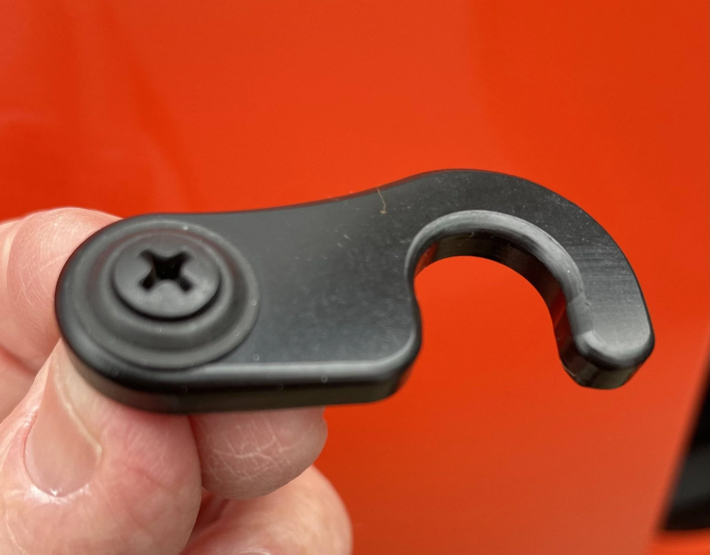

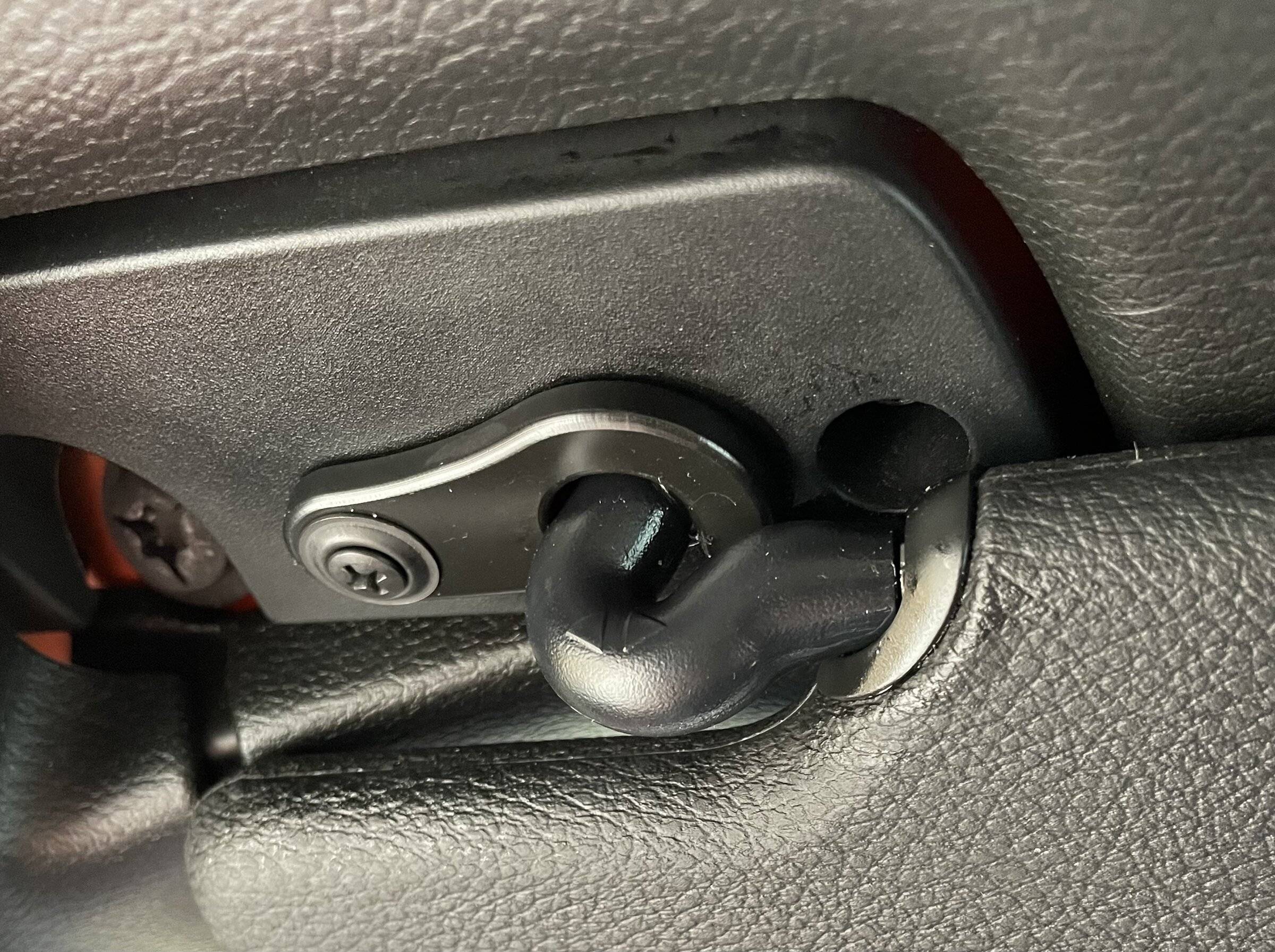

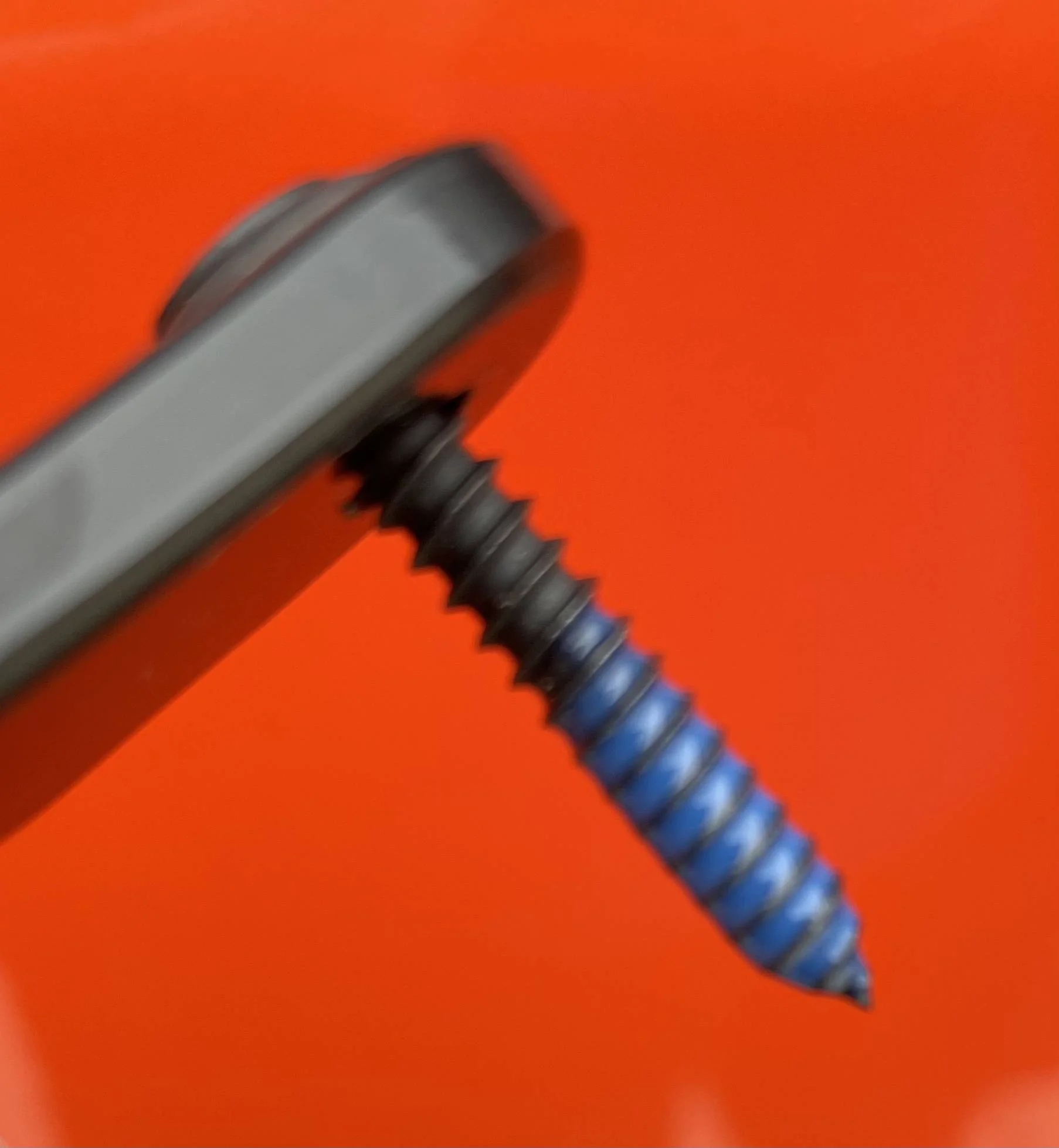

Update…TACCOM visor clips arrived; although broken visor was replaced under warranty (see prior post) I decided to install these to (hopefully) avoid a repeat failure.
Very easy install; I replaced the supplied screws with trim screws (I prefer the look of them, and very little filing was necessary for a good fit).
I used thread locker and lubricated the OEM visor shafts with LANOX. Visor clips look very well made and fit great.

I was going to apply thread locker until I realized I was screwing into a clip. The factory doesn’t seem to use a typical anaerobic thread locker. It’s more like a thick paint which I’m unfamiliar with. Any ideas about that?
