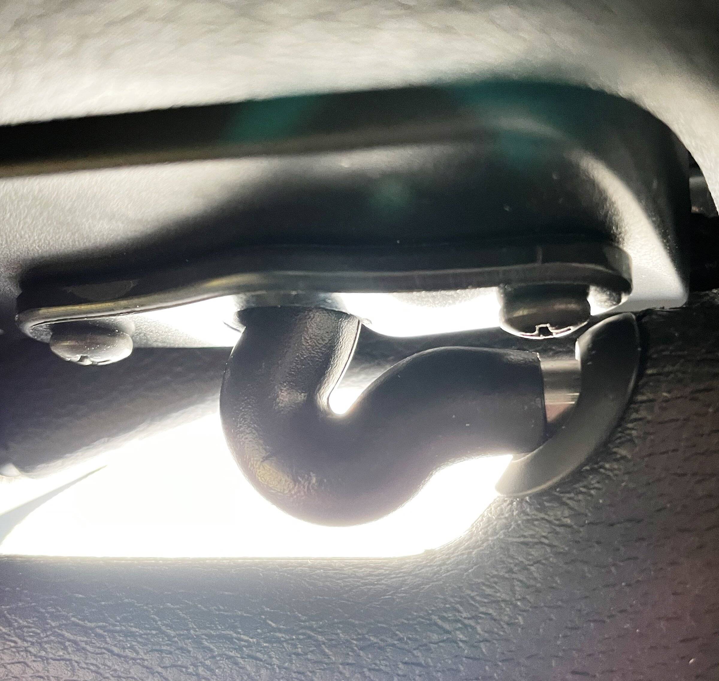

Manufacturer just messaged me and said the 2 screw visor clip absolutely do not rub.
Seems to be some discrepancy on either installation or manufacturing of the visors themselves. Clearly the one screw offering does not have the same lateral support that the two screw one does (see photos below from earlier in this thread) As Rhinebeck01 states the simple solution would be to file or sand off any contact points. C'mon you are "jeep people", right? ? sanding, filing, grinding, fabrication shouldnt be foreign concepts...

I cry foul on that 2nd pic you posted with the single screw clip. Whomever did that install ... like you see it in the pic, botched it somehow...
The single screw clip can be used in /for a repair.....
Sure, I'd go with the 2 screw clip for a repair but, even the manufacturer says all that is needed for a repair is the single screw clip.

Sorry, didn't mean to make you cry. LOL! I think you might want to re-read through the thread then. These are not my photos and experiences, they are from other Jeepers who took the time to post their photos and results-yours may vary.
You said it yourself: "Manufacturer just messaged me and said the 2 screw visor clip absolutely do not rub. "
I agree; The manufacturer thought they were "overkill". ...But as a multiple Jeep owner, and like so many others here, I want overkill.
So... if they do not rub, (or can be installed/modified not to rub), then a two screw attachment would be far superior to a one screw offering. I believe there are a few photos showing this. In the end it is up to you, but I'll stick with simple physics, especially on a part that is known to eventually fail.

One guy posted a pic that displayed a botched install with a the the single screw clip... and that was the picture you re-posted.
As the manufacture has stated the single screw version will fix a broken visor or can be used to make an aok visor more stout.. He said the 2 screw visor was "overkill" but he would offer same as he could make money doing so..
With that said... the single screw version is all that is needed..
Yes, if it were me I would go with the 2 screw version for a repair..... but I like the extra beef/overkill.
I have seen the repair accomplished with the single screw clip with my own eyes though and the repair was aok...
Reality is the manufacturer should be doing the sanding.... thinning down the two screw clip so it will fit all... no, he chose to not do so and leave the deed for the buyer (some) to do.. Yes, the manufacturer originally thought the 2 screw would never rub... I doubted that from the get go.
About the sanding.... there are gals and guys that do not feel comfortable doing such...
Again, I have seen a decent repair with the single visor clip and indeed, the single clip does the repair well.... so, I agree with the manufacturer, the 2 screw is overkill and not mandatory for a re-pair..
