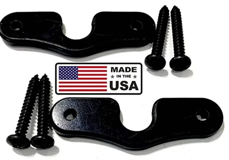

Here's the US Amazon site for both versions.
TACCOM Sun Visor Clips (single hole)
TACCOM Compatible Heavy Duty Sun Visor Clips (2-hole)
The pic for the 2-hole doesn't show countersunk screws but it is just an old pic and I've read that all of the 2-hole versions are countersunk now. Those are the ones I have.

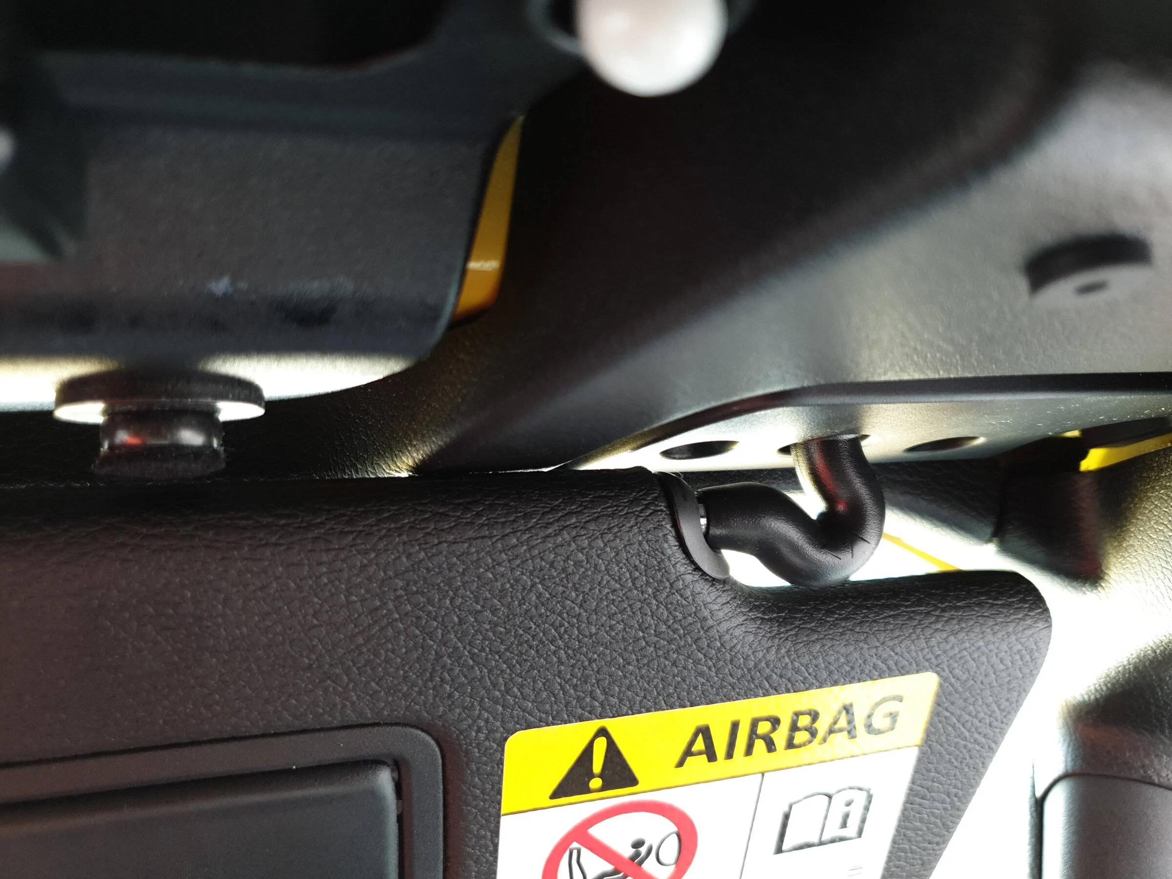

This might be a stupid question already answered somewhere in this thread............ but
Is the issue that the visor "joint / arm" can eventually pull through the factory location and fall out? And this just keeps that joint from falling through because it's creating a "catch point" / tighter space it can't fall through?

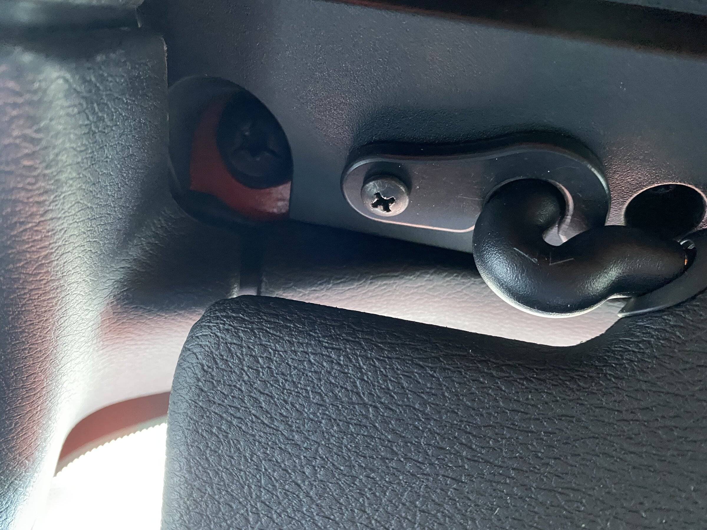

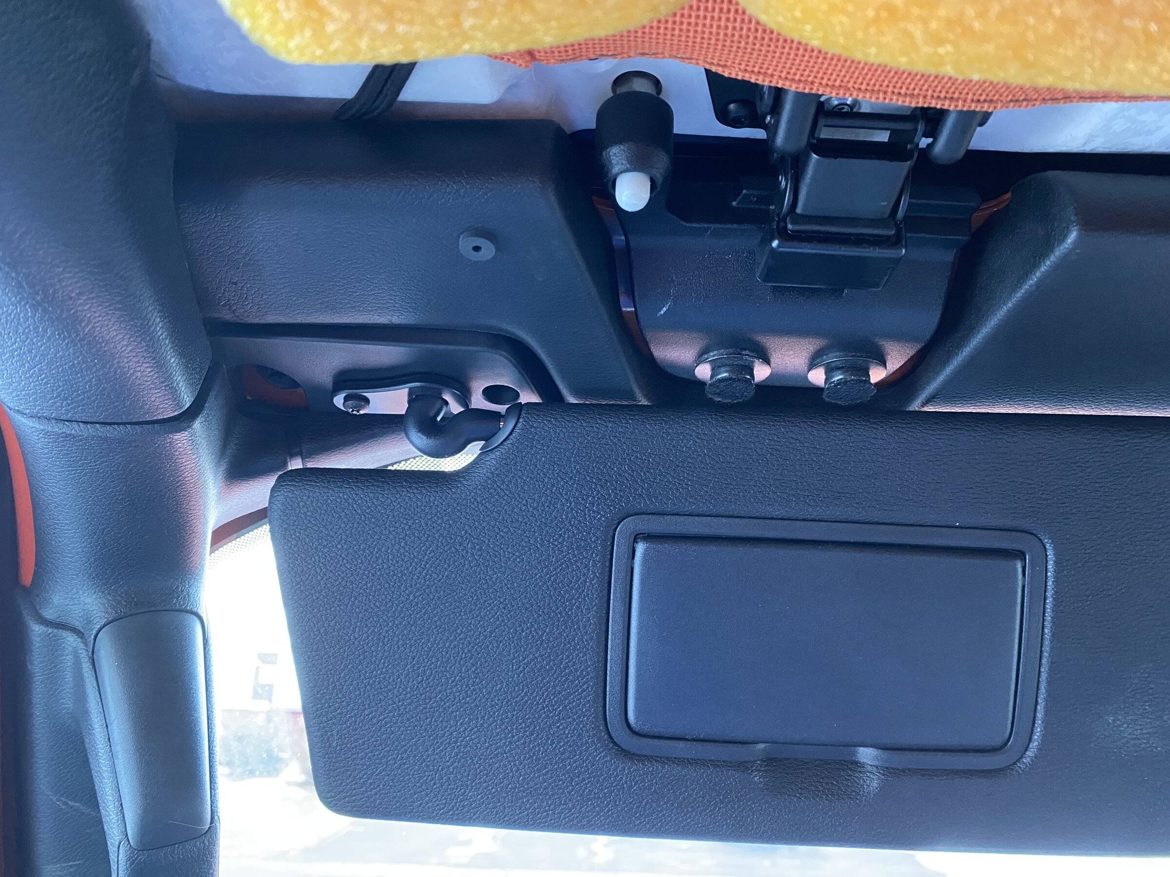

Installed today, can confirm they reinforce good Sun visors, and fix broken ones.
Driver side is good, definitely tighter/ more snug as that visor was replaced. My passenger side is broke shortly after. These clips restore it to normal function. For $20, and made in the USA, these are a slam dunk.

Just installed mine yesterday. My passenger side broke and now it’s back to normal. The driver’s side is pretty snug and pulls out that little plastic trim piece on the visor. Might have to sand it down a little. I bought the 2 hole version.
Trying to understand the mechanics of it.
Yeah, go to the fix pages for the EBay product or the Amazon product and they show a pic of a visor that has fallen out. There's a tapered nozzle/bezel that holds that assembly in. The additional clip prevents it from popping out. Gotta love Jeep engineers. Design for modification...
