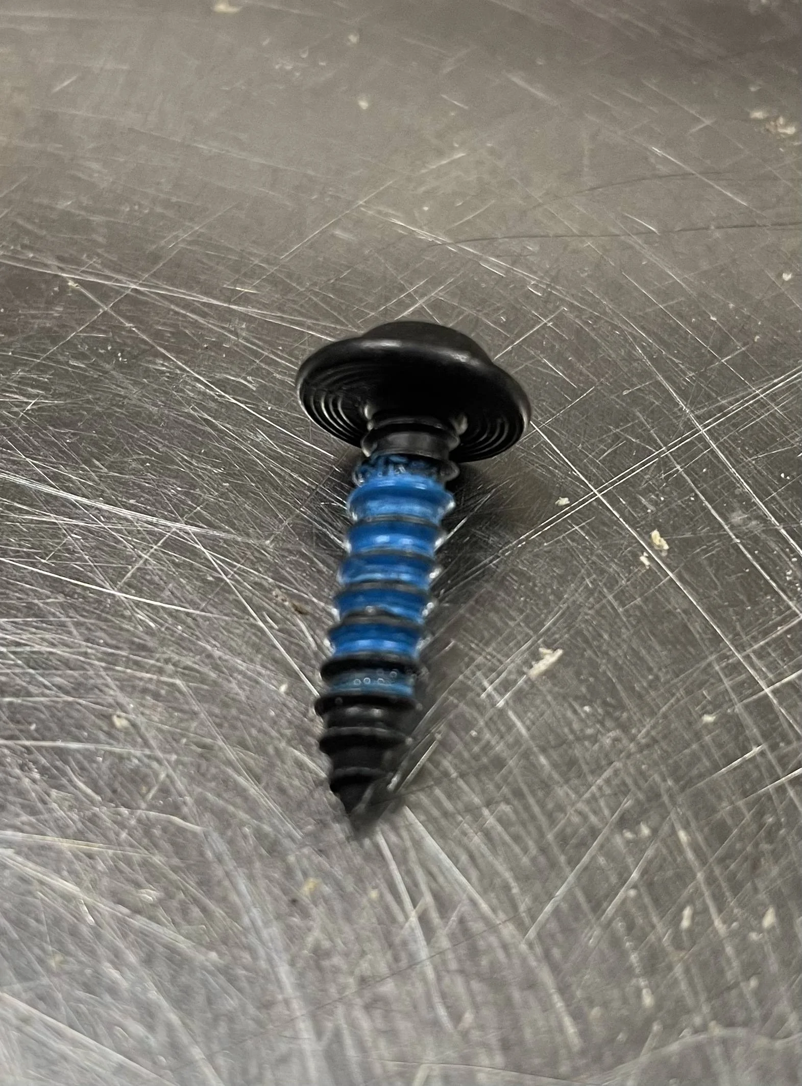

I used thread locker, but it may not really be necessary. I did note that the OEM screws had what appeared to be some kind of ”blue stuff” on them.
Removed OEM visor screw:
My old and new visor came with the same blue stuff. I could scrape the soft-ish stuff out of the minor diameter with my nail. I think it’s more like paint.

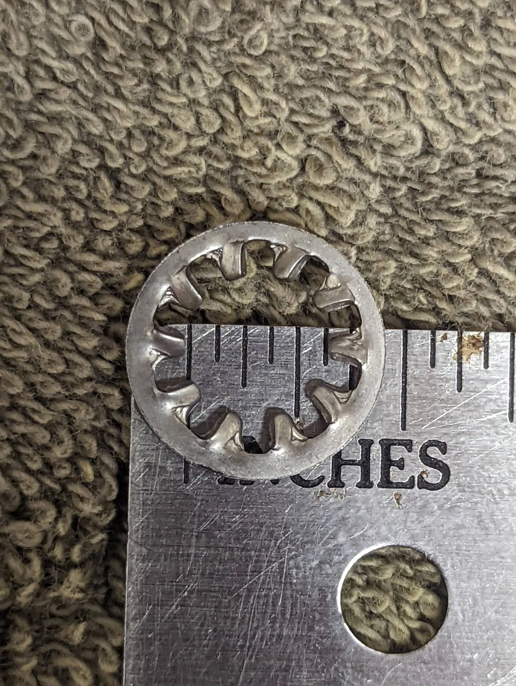

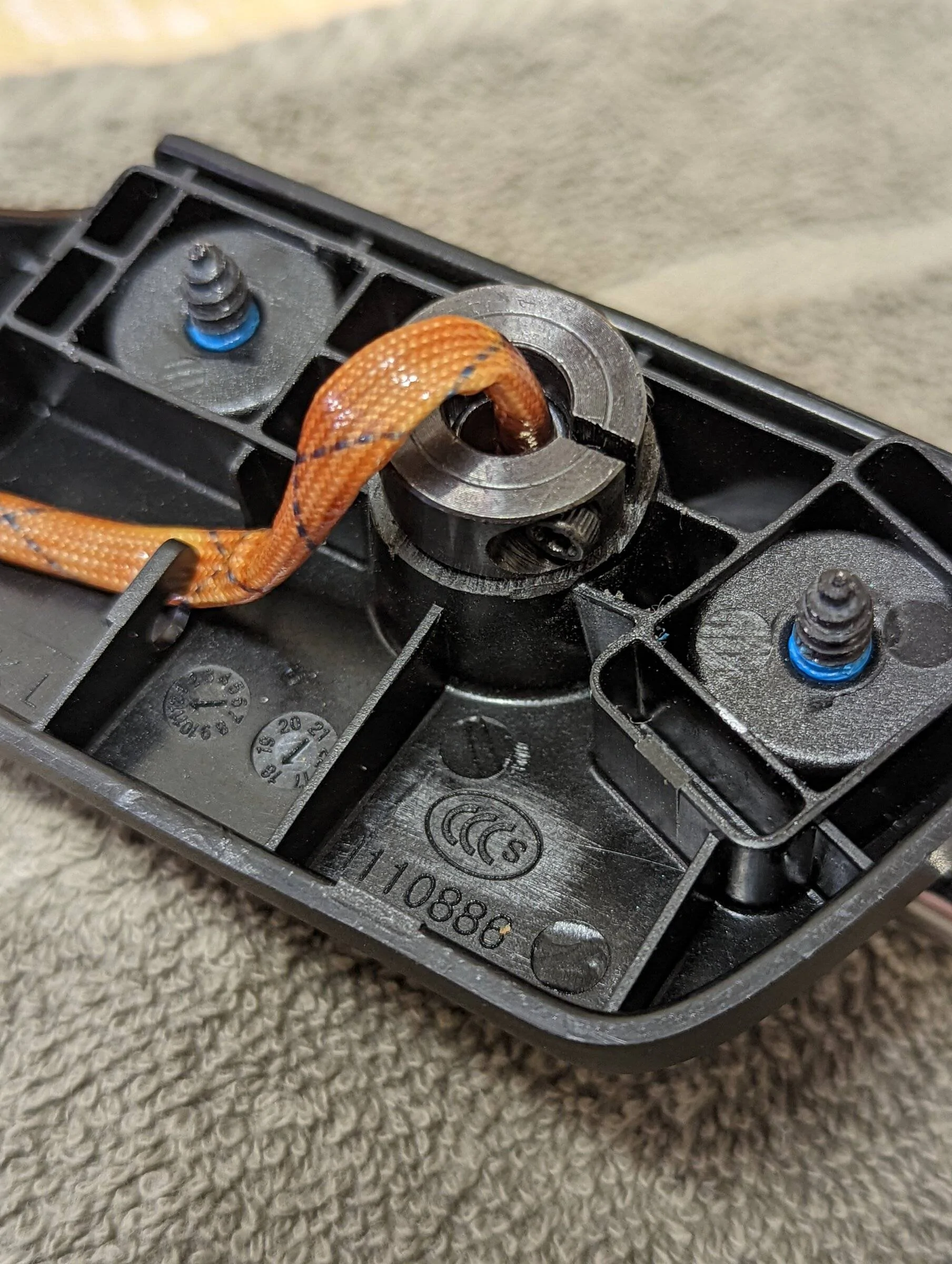

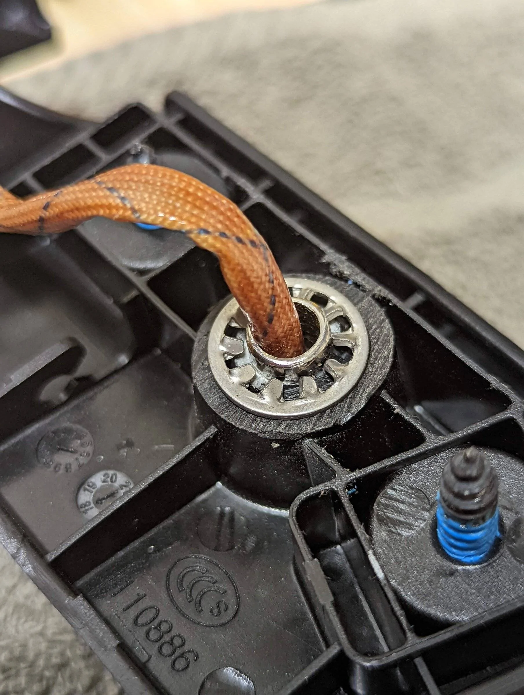

I attempted this fix, but ran into an issue with my push nuts. I purchased a couple 5/16 inner diameter push nuts from Ace Hardware for 50 cents each. The issue is that the inner diameter is too large and doesn't securely contact the metal collar of the sun visor. I measured the push nuts and they are indeed 5/16 inner diameter. Just a heads up that you might want to go for a smaller 1/4 push nut or shaft collar if attempting this fix.
Used a hacksaw blade to trim the plastic.
Jeep Wrangler JL Sun Visor Fix PXL_20220520_172603236
Jeep Wrangler JL Sun Visor Fix PXL_20220520_173011834
The 5/16 inner diameter push nut slides right on, completely loose.
Jeep Wrangler JL Sun Visor Fix PXL_20220520_173501008
Measures 5/16... so I guess I'm headed back to Ace Hardware for a smaller 1/4 push nut or shaft collar.
Jeep Wrangler JL Sun Visor Fix PXL_20220520_174816302
Lateapex
Darrell
Apr 29, 2019
876
5,391
San Diego, California
1944 MB, 2019 JLS
The teeth on the “retainer“ you are using look very thick in your last photo (looks more like an internal tooth lock washer than a push nut). You might try to find a pushnut like the one in post #2 of this thread instead.
Thank you. I didn't realized I grabbed the wrong hardware. My Ace didn't have the correct size push nut but they had a 5/16 shaft collar. It's not going anywhere now.
