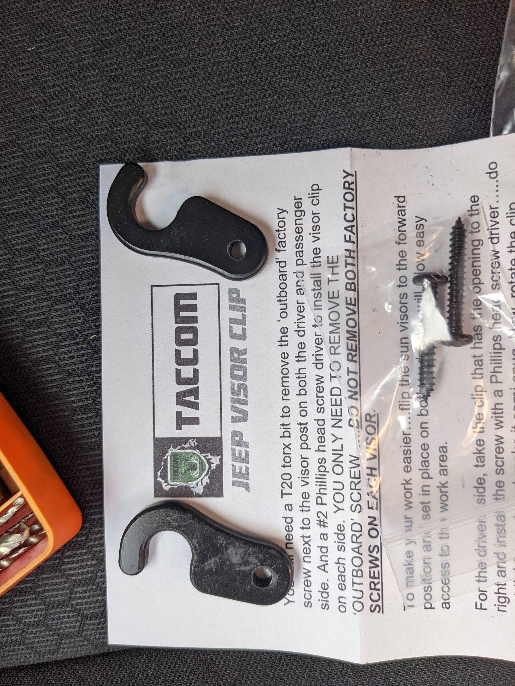

Received my set today and got them installed.
The install is dead simple and they lock tightly around the post on the visor. There is an audible click when they attach. It is a rock-solid hold. Fingers crosses they work as advertised, but, I think they should definitely do the trick.
Jeep Wrangler JL Sun Visor Fix PXL_20211209_184841615
Jeep Wrangler JL Sun Visor Fix PXL_20211209_185154970
