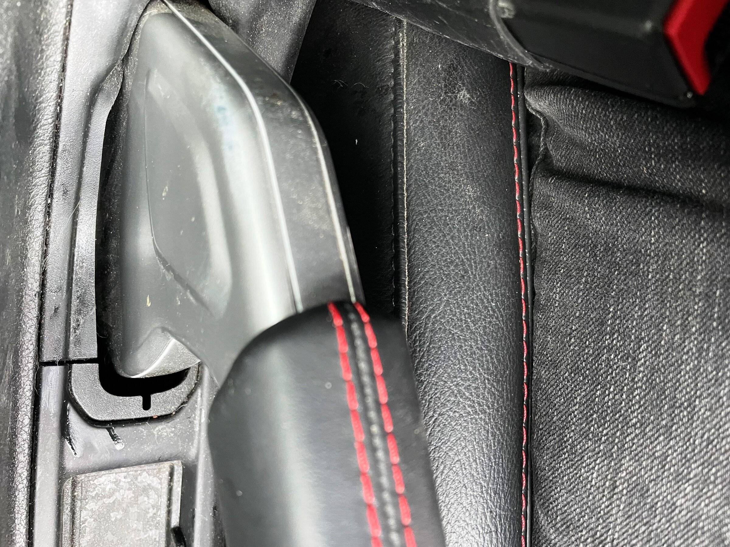

I just got mine and proceeded to drop one clip down into the handbrake never-to-return slot. Don't do that.
Jeep Wrangler JL Sun Visor Fix Clip fail
I would like to see a design that accommodated both screws as well. Seems solid enough, but flush mount would be better.

That does not look seated correctly. Shouldn't it sit flush?

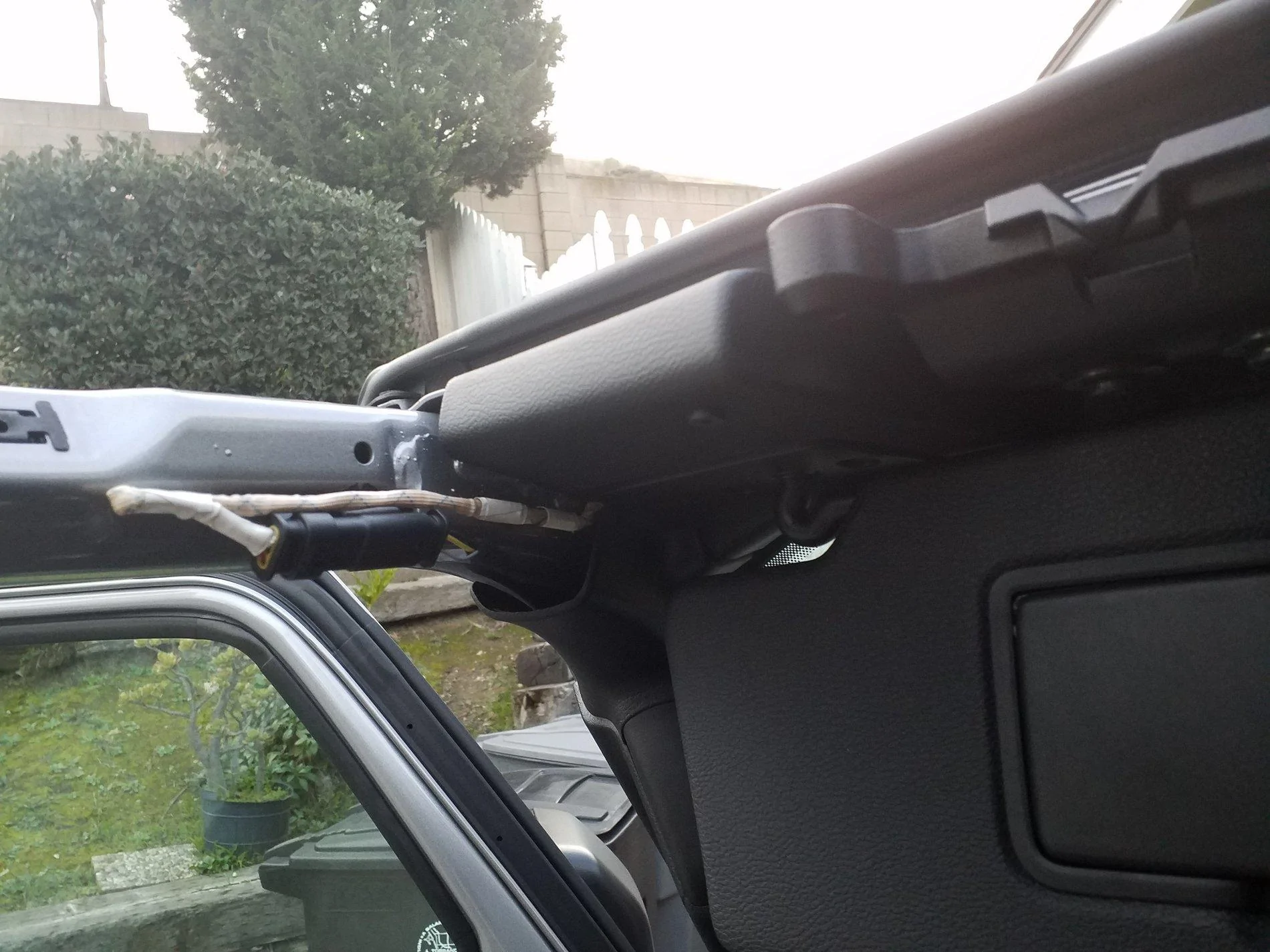

It took me a few days of thinking about how to repair the visor in a way that would be stronger than the OEM POS. I had all kinds of ideas about machining rings and cross drilling the metal shank.
In the end, I came up with an idea, all on my own, that apparently was also devised by Dorman for the JK in their repair kit. I found this out later after I had ordered what I needed for the repair.
Here's the repair.
You need a T25 Torx driver, a very small flat blade screw driver, some electrical tape, a sanding disk or other method to remove some plastic and a little triangle jeweler's file.
You'll need to get a 5/16 push-on retainer of a specific type. I found them on amazon for $3.59 + $3 shipping.
https://www.amazon.com/Push-Pushnut-Stud-Size-5-Piece/dp/B078B71X81
You can find similar ones from McMaster-Carr or Grainger for about 5 to 10 cents each if you buy 100-200 pieces. I just went with the amazon listing because it was easy and I can't envision using many of these. Although, I can see the need for one more for the passenger visor.
I've written this for a Jeep equipped with the garage door opener and lighted mirror. If you don't have these options, yours may not have any wiring and you might not need to remove the rollbar cover.
If you have a top on the jeep, you need to remove at least enough to get access to 2 Torx screws on the plastic cover on the top rollbar tube. I have a hardtop and just removed the "Freedom panel". Remove 2 other lower screws on the rollbar cover and remove it. That will expose the tube and you'll see a connector near the A-pillar. Disconnect it. Also remove the push-pin retainer that holds the harness in the rollbar. Remove the 2 Torx screws in the visor base and you should have the whole visor in your hand.
That was the point of the picture. There is no way I can see to get it to "seat". There is no seat other than the screw. I am guessing it is the broken visor's weight on the shaft pushing down on it. It feels good, and the screw is as tight as I am willing to crank on it.
Was yours already broken, so this was a repair, rather than prevention? Your photo is helpful so that we will know what to expect.
I wonder if you pushed the visor rod (mount) into the body while tightening the screw, if that would help relieve some of the downward tension and allow it to seat a little better. I would be concerned that the way that sits it may not last. This is why I was thinking the part should be designed to attach with both retaining screws (on on each side of the axis of the rod…
Hopefully I’m explaining this correctly.
Yes, this one was already broken and why I was poking around for a solution. Driver side 2020 JLURR. I pushed the shaft up pretty hard as it would hold on its own up there for a bit if it was in the stowed position. I am going to go out and play with it a little more soon, but I was a little surprised that it pushed out that much. Feels solid though.
I also agree on the two screw design. You could still install one screw at a time, so the visor assembly would never be detached. Leave the open slot for the shaft. Remove 1st original screw, position the clip, and Install one of the new screws. Remove the second screw prior to rotating the clip, rotate the clip into position and install the 2nd screw. That seems like a better long term solution.

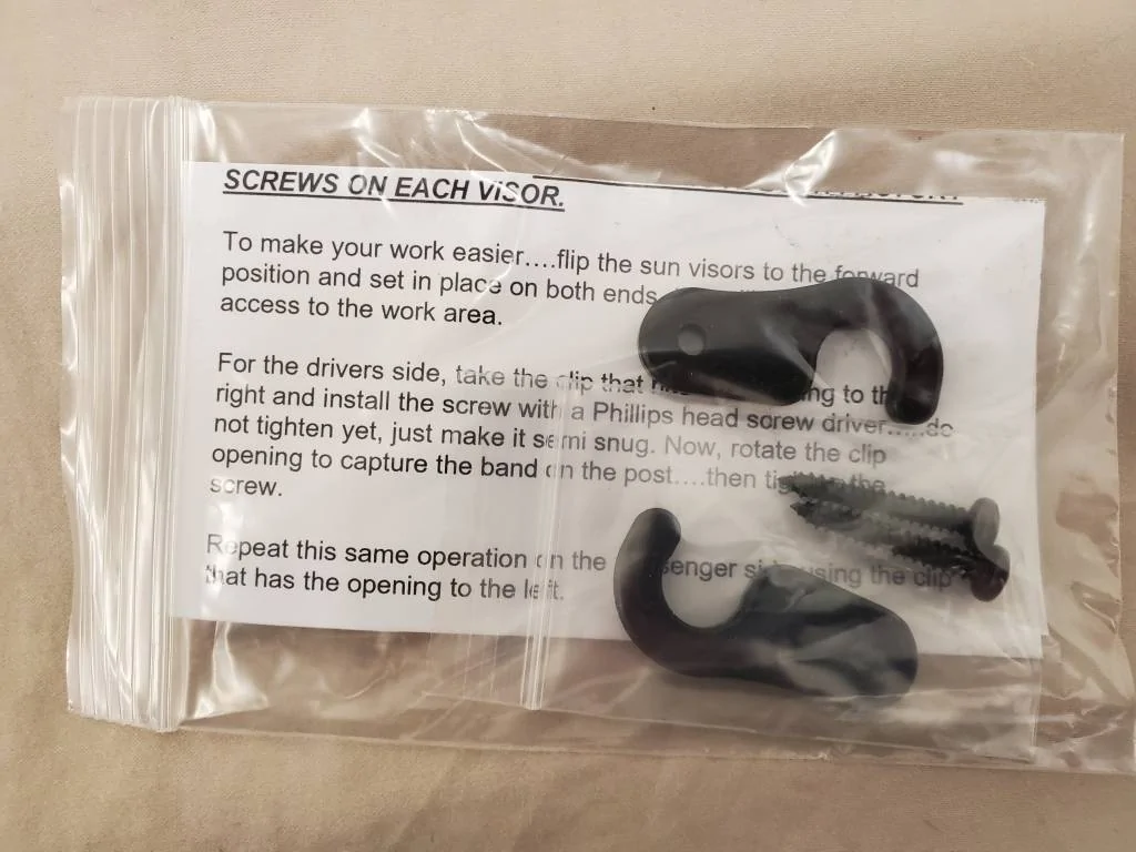

I received the USA Manufactured visor clip offering today, that we have been talking about for the last few days..
Product arrived in a timely fashion. Shipping label and packaging were above average.
The product, an invoice and an instruction sheet were inside in a clear plastic bag..
Product itself presented very well. No blems, etc..
Can tell you the visor clips, made out of black Delrin plastic are very stout and do appear very durable.. They are not going to break.
Te visor clips are Lazer cut and all the edges are smooth. Good black color.
Installed they blend right in with the black plastics of the JL.... you'd figure they were factory if you did not know better.
Install was easy easy and took no more then 3 minutes on each side...
Yes, I did place some blue threadlocker on the supplied screws. I doubt that was necessary as the screws are quite a bit longer then the factory screws....these supplied, longer screws, grab well when screwed in.... they aren't going anywhere or going to vibrate loose.
Can tell you the short factory screws indeed had blue threadlocker on them.

Will say install of these visor clips does beef up things to to speak... Sure a guy manhandling the visor or if you sic a heavy handed, kid or Wife on it, you could probably still break the visor but for sure it won't be easy to do so now.
Here are some pics... No pic of them installed on my JL as my Alien Sunshade bungees lie over the installed clip making a pic a no go... Can tell you my clips installed nice and flush and looked good... looked factory, like in the pic forum member @Reldn posted earlier in this thread.
