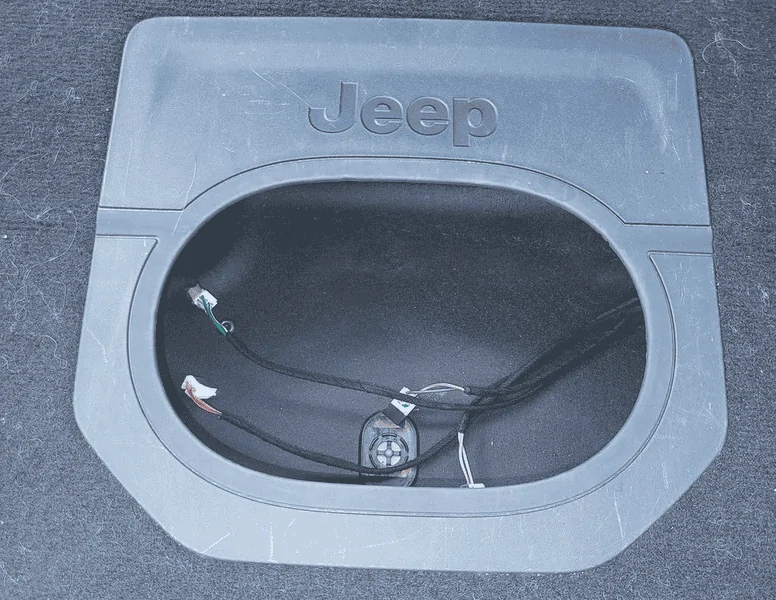

So, I basically just unscrewed, unbolted, and unclipped. I taped over the ends of the plugs, jic, and I'm gonna see if I'm okay with the sound. If I like it, I'll figure out something to do to cover the hole or replace the lid.
I think that little bit of extra space would be great for storing emergency gear like a fire extinguisher, tow straps, etc. I've found a lot of roll bar attachment storage doesn't fit anywhere on a 2-door soft top. ?

Fwiw, I can hear the difference without the subwoofer installed, but I don't mind it. The backseat passengers also noticed the lack of bass vibration without knowing what had changed.
For me, the tradeoff is worth it. Now I just need to find a solid cargo cover flap and figure a good way to store the cords. It won't be difficult to reinstall. If you're not sure, try it out.

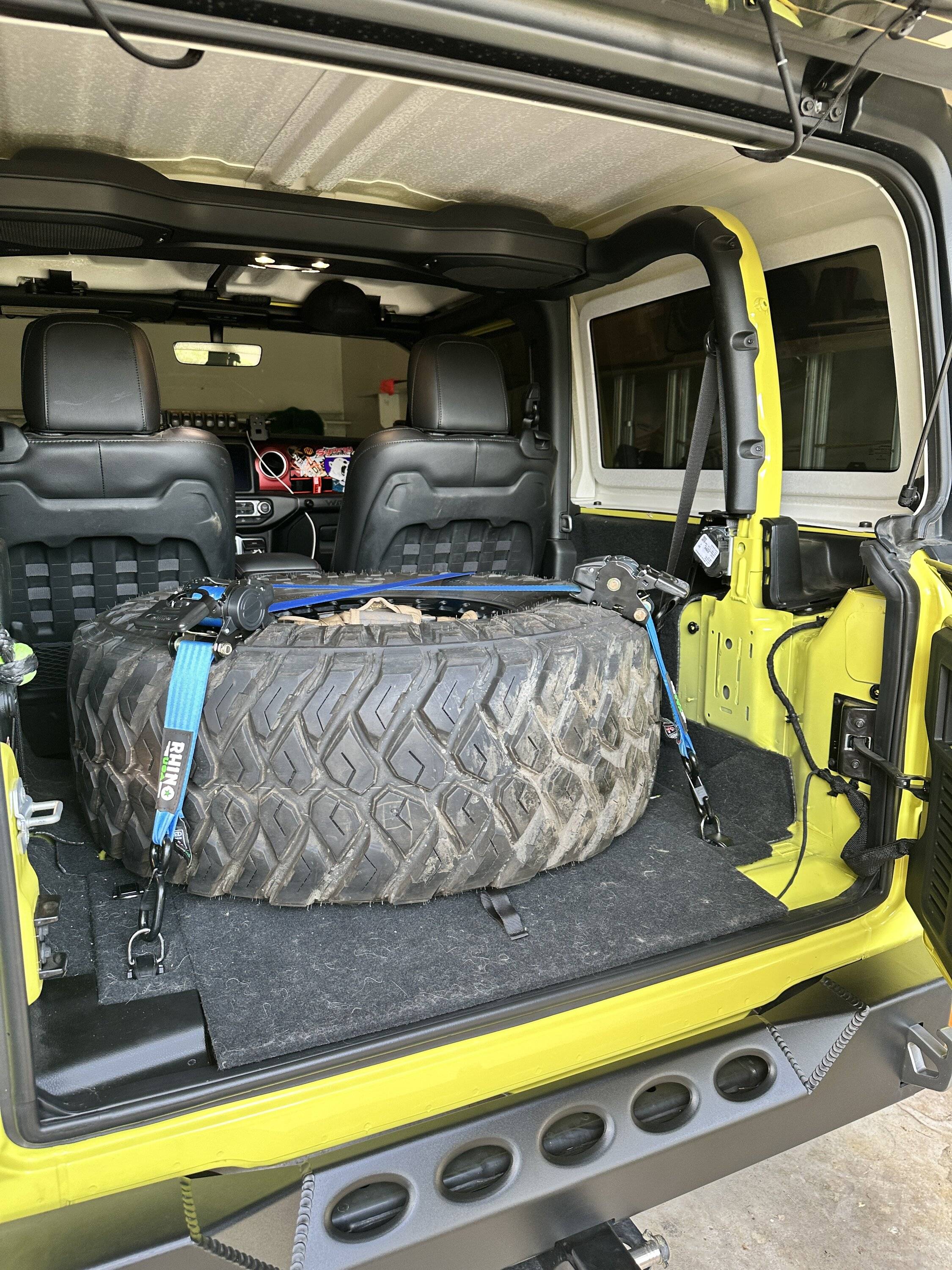

Pulled mine it sounds fine as did with it neither is anything to write home about. Just unbolted and pulled the single wire from the passenger side.
I have stuff needed rarely but want to have under there since I keep my spare inside. All my other stuff goes in a bin I strap on top for trips.
I don’t have the plastic back in so you can kinda see the sub plugs in just in front of the seatbelt.

I'm living life just fine without the subwoofer, and with the extra "scoop" space. Anyone have a ballpark figure for how much I should try to sell the sub? I know I should probably save it for when I sell the Jeep, but it's large, bulky and awkward. So I'd prefer the free space. (See a theme here? ;) )
You have the space. And we need the space to live!
