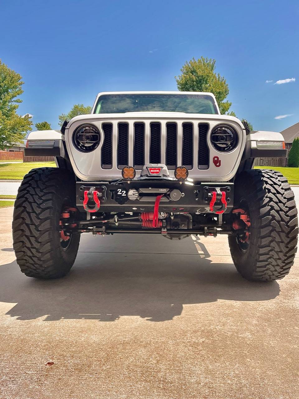

As others have stated, no major concerns other than a little hit on aerodynamics and your wheel being more exposed to critters or people from Ohio. Local law (and enforcement) varies.
OEM steel bumper is probably the easiest to work with for most since it’s expandable for inspection and allows for top mounted lights and fog lights, as well as a winch. Really nice setup.
Bumper here is the Barnes4WD Pritchett Canyon.

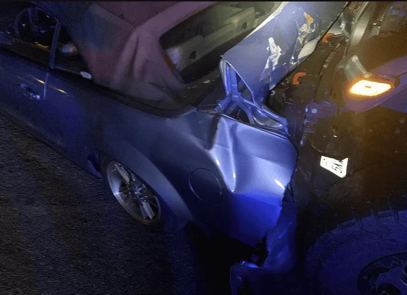

As far as safety, my Jeep in stubby mode was hit from behind by a driver going 50-60 mph and was pushed through the back of a Mustang. The Mustang was destroyed and the only damage to the front of my Jeep was the plastic license plate holder, some scratches on the bumper paint, and one fender blinker lens popped out.

as for your crash, your pics make it evident that it wasn't offset or at an angle, so that's not really relevant to any discussion regarding corner protection.
i'm glad you didn't suffer any further damage, but having the ends on the bumper would have spread out your contact area and might have helped prevent you from being pushed so far into the back of the 'Stang, and saved you even more.

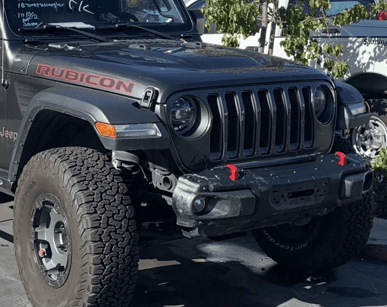

I recommend you stay away from the OEM steel. It’s not that well thought out. 2 additional expensive components needed to mount a winch. (Plate and adapter). Massive plastic pieces that cover spacer “pucks”. These things are the first thing to hit when off-road and they are cheaply made. Solid steel would have been so much better. I only ordered it with the oem steel because I’d ordered a mopar steel bumper for my TJ and it was amazing. It looks nice but the steel bumper package was a major disappointment.
I'm pretty sure those are for the 5 MPH crash test. They probably wouldn't comply if they were solid steel.
