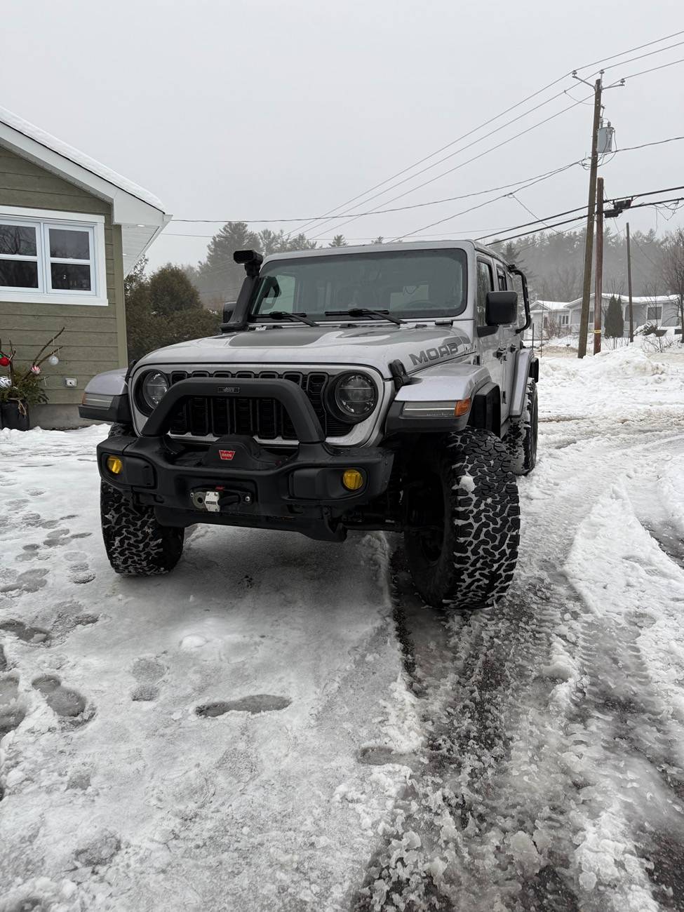

Pic for attention.
Jeep Wrangler JL Stop/start revisited. Need clarification. IMG_6102
