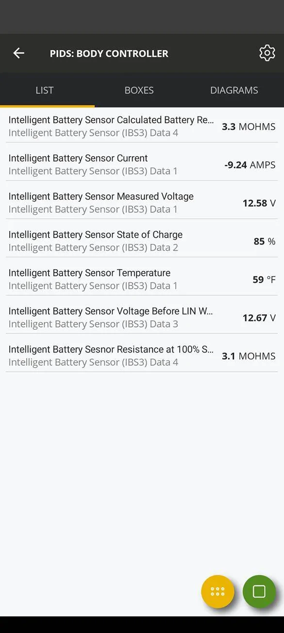

Does your Foxwell show CCA, SOC, and SOH? If so, do you recall roughly what it reported?
I ask because I have a Foxwell that does and am wondering if I should be more skeptical of it.
im sure it must have reported low numbers, I don‘t recall now, Maybe a little hyperbole on my part to make the point that without a load test it’s not 100% reliable. As you’re well aware, I’m not a battery expert.
