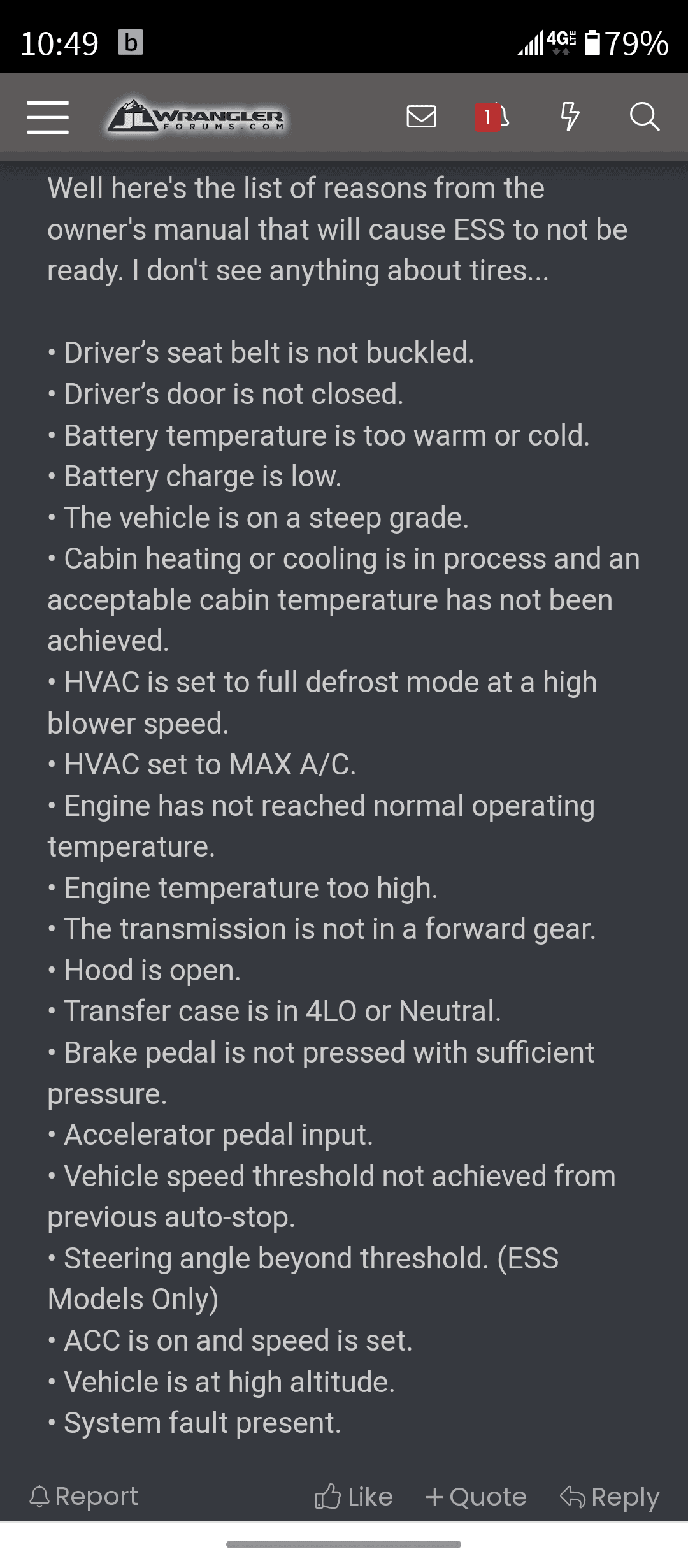

Thanks, all. I didn't know that taking off your seatbelt shut off the feature. I have changed my habit to taking off my belt as the garage door opens instead of having to hit that button.
By the way, I was sitting at a light yesterday. It was about 90 degrees and I had climate control on auto. The air was blasting and the engine still shut off. Cold air continued blowing, but apparently it isn't supposed to shut off with the air on? Also another time I waited a long time at a light and it shut off, and a few seconds later started back up again while I was still stopped. I guess it knows when it needs to start back up because it's a drain on the battery.
Mine shuts off with the AC going. That isn't one of the reasons for it not to work. If the delay is too long, it will start up on its own.
I was going by this post:
Jeep Wrangler JL Stop/start question Screenshot_20220804-104921
