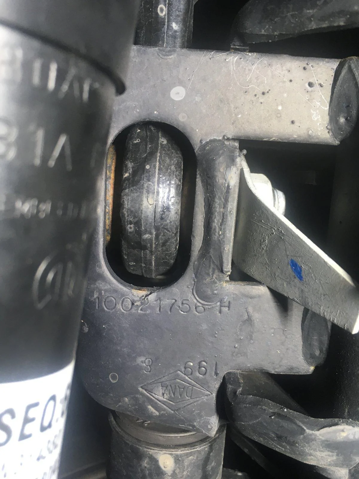

Is that the track bar weld?
Went home & checked and it was just a paint/ coating drip that pulled away from bottom of axle tube bracket. But yes it was on track bar bracket at axle tube. Picked it away with a dental pick and now you clearly see edge of bracket. Whew!!! Instantly nervous about welds on JLs but this one would have been a Dana issue & not frame plant.
