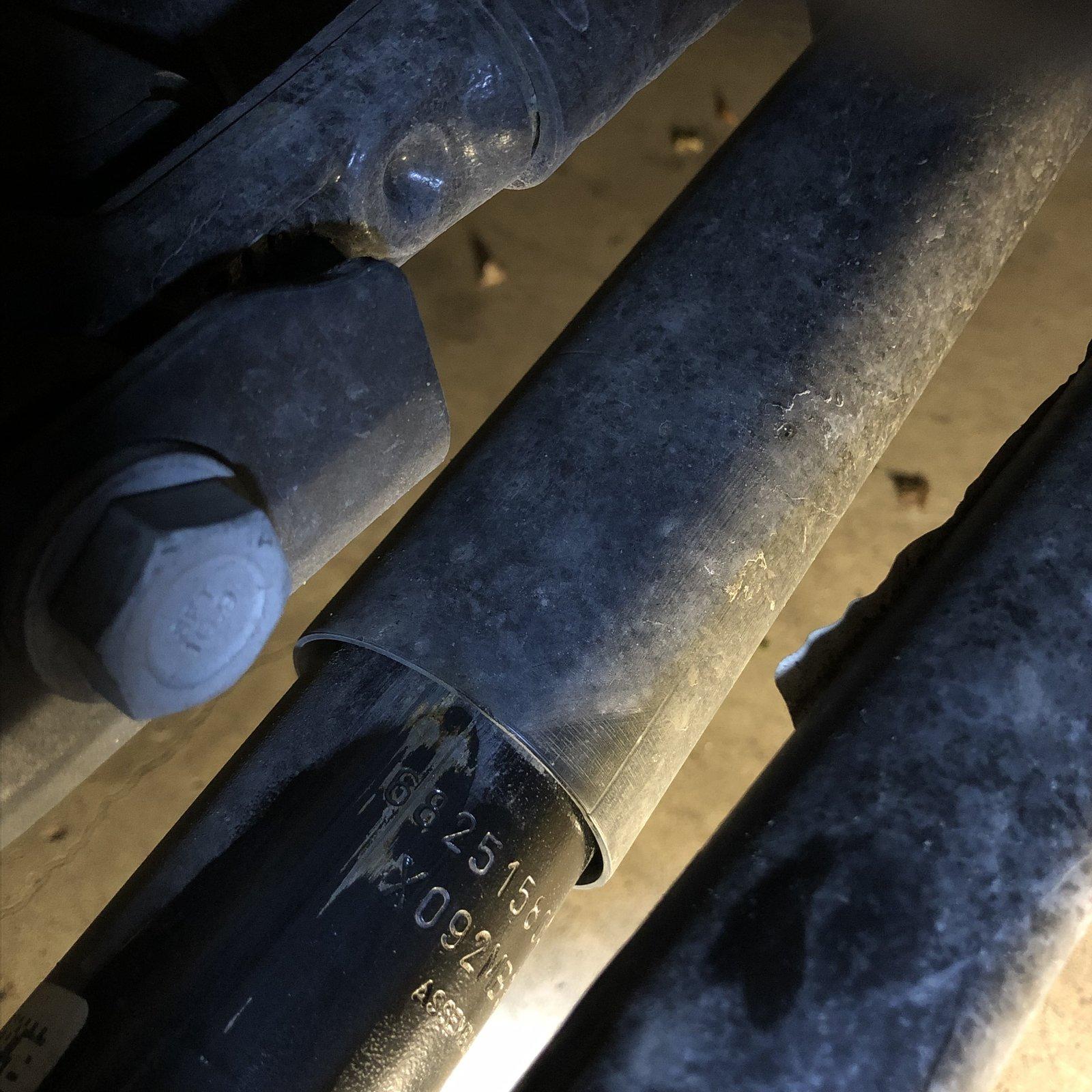

I cannot quite see the date code (I too have had a wobble) but going fairly slow - 30 mph or so. Tried to stick a camera in there to read it but there is something in the way...grrrrr I guess the dealer can hoist it and have a look.

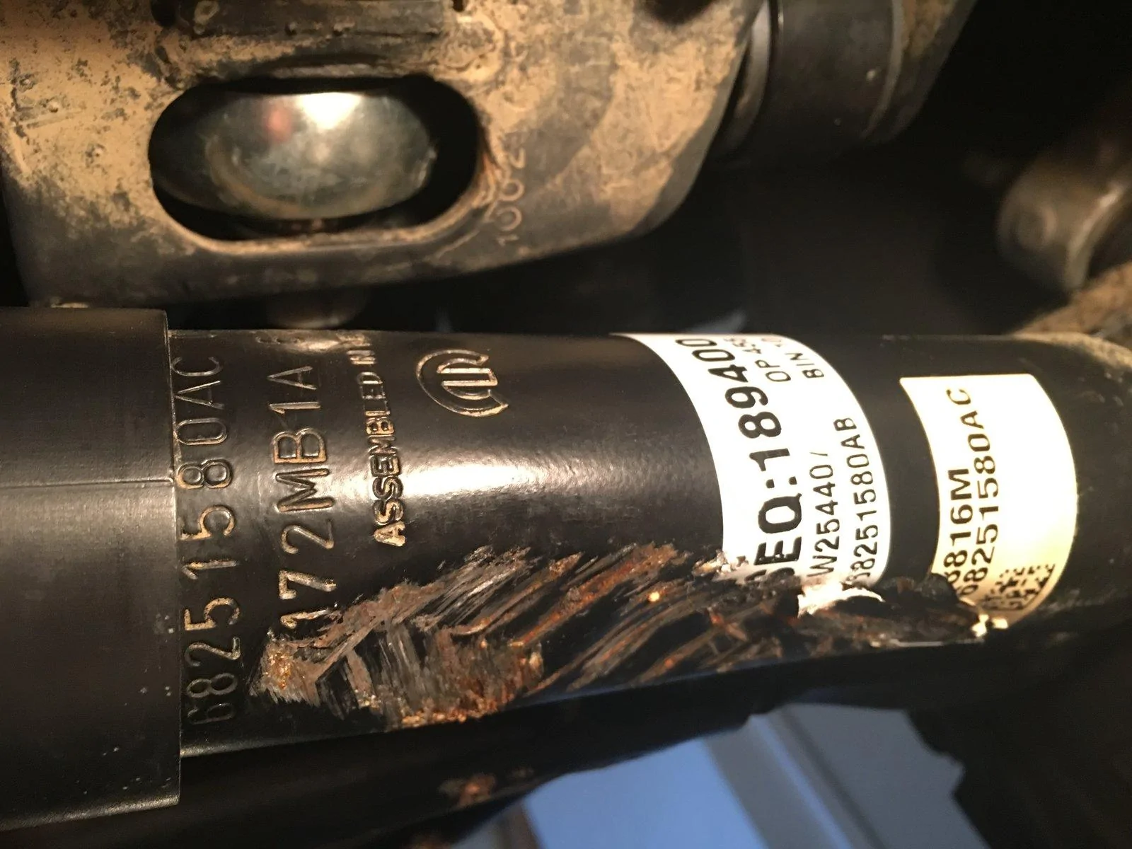

I had a hard time at first trying to get a pic of my date code too almost 2 weeks ago. First I crawled underneath and shot upward - not good. Best access and this shot ended up being from the passenger wheel well shooting downward with a light shining up from the garage floor.
#092 Note the long scratches next to the X documenting damaged unit.

I received a text from Ralph, service manager, today that my Sahara was ready. This was day 12 including drop off day. The drive home went well, definitely better than when I brought it in, but it was only 20 miles back.
Props to Szott Jeep all around. Excellent communication from Ralph throughout the 12 days. The loaner 2 door manual was fun to drive, but glad I’ve got an automatic.
They let me take a pic of the old part, with the scratches now rusting. They have to send the part back to Jeep.
Thanks also to Darlene @JeepCares for her help and oversight.
