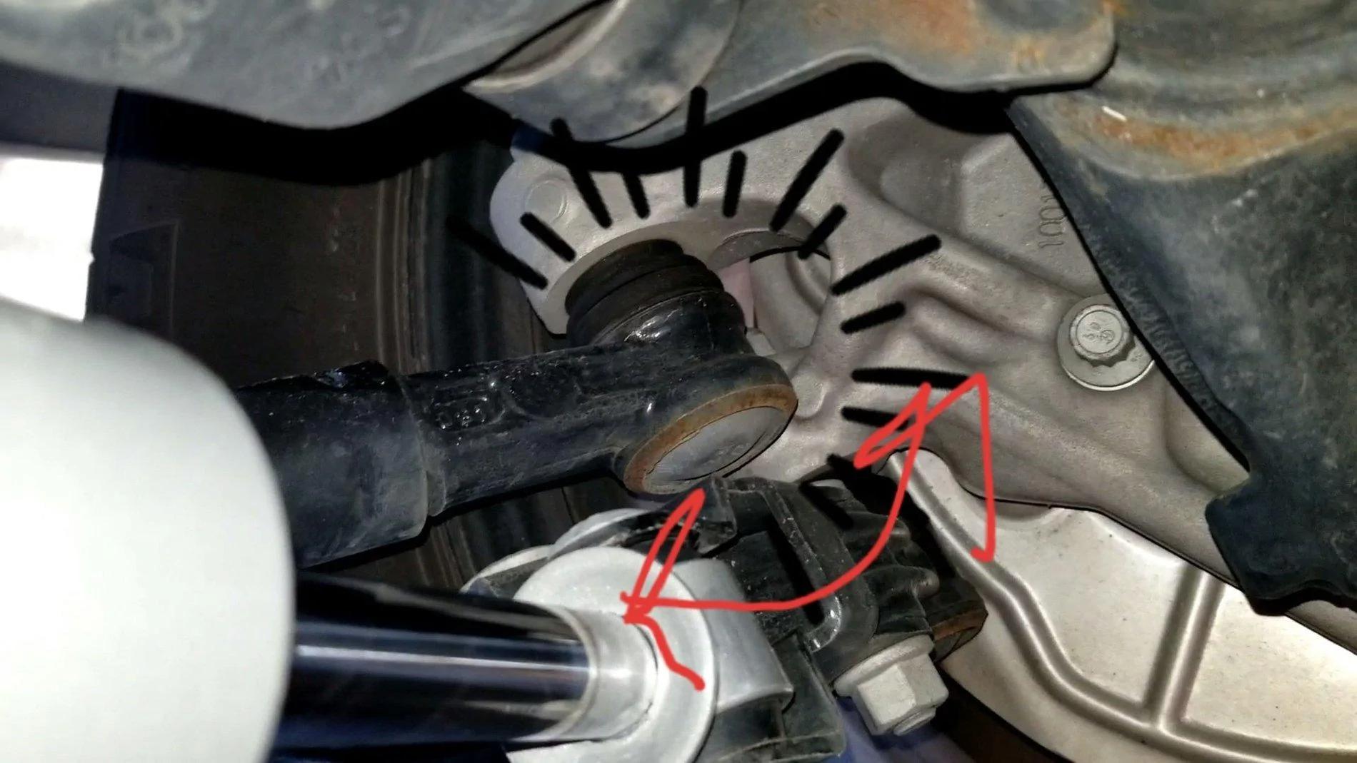

Here is an image of the drag link. It has play and makes a "clunk sound. It doesn't have up/down play. It has rotational play.
Jeep Wrangler JL Another JL with Steering Wobble draglink
Same thing with tie rod. Makes "clunk" sound upon rotation. No up/down play. This is harder to rotate though.

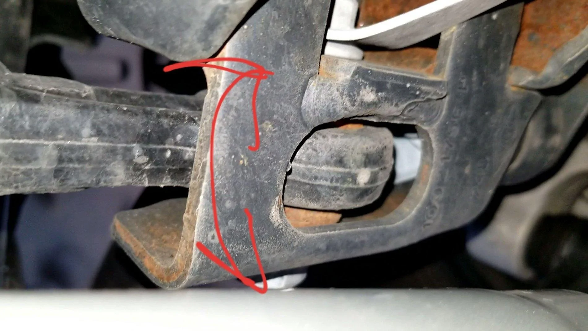

Here is an image of track bar. No "clunk" here. But still some slight rotational play. Nothing excessive but I can get it to twist slightly with my hand.
Jeep Wrangler JL Another JL with Steering Wobble trackbar

All that little bit of rotational play in the drag link and tie rod is normal. Not sure if there should be any in the oem track bar. Having said that there was more than one design of the track bar because the bushings were to soft I believe. It wouldn’t hurt having the tires road force balanced and even if that doesn’t fix it you are only out 45-50 bucks. You are right that a steering stabilizer won’t fix the problem(as you found out with your new one). Next you should check the torque on all your bolts to make sure nothing is loose.
The steersmarts track bar, drag link, and tie-rod are stout components and a great upgrade. Jeeps current “fix” for wobble or death wobble so if you want to actually fix it you are going to have to do it yourself.

2 dealers told me play was normal and that they would replace stabilizer.
So I did steer smarts. The steer smarts parts do not clunk and have no rotation play after installation.
I no longer have wobble on the highway. I now have a very small shimmy, but it goes away in literally <1 second. I am going to re-torque everything after some more driving and check out ball joints, control arms, etc... I can definitely live with the shimmy for now. I will update again if I can get the shimmy to go away. Either way, the steer smarts parts definitely cured my problem, so add me to the list.
