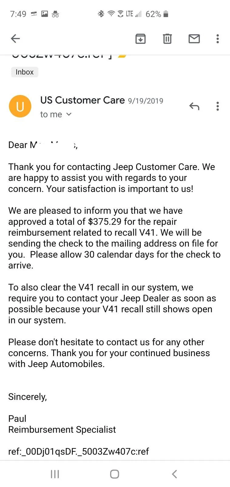

Fwiw..here is an email from FCA regarding the reimbursement.
They reimbursed me for the Tereflex adjustable stabilizer I installed many months prior to recall. With the reimbursement check I bought the FOX ATS. Total win.

Well looks like all of you who were reimbursed by FCA got lucky. I was just informed by @JeepCares that they " are not reimbursing for aftermarket parts under V41. Customers had been reimbursed in the past but it was in error. The only way to close out the notice is to have the customer satisfaction repair completed by the dealership with the specified parts." Bad news for everyone like me who were told "If you have already experienced this specific condition and have paid to have it repaired, you may visit www.fcarecallreimbursement.com to submit your reimbursement request online. Once your documents are received and they verify them, reimbursement will be sent to you within 60 days."

@JeepCares won't reimburse you a nickel. They are mediators.
All the reimbursements are/were valid.
Call Jeep.
@JeepCares is useless.
