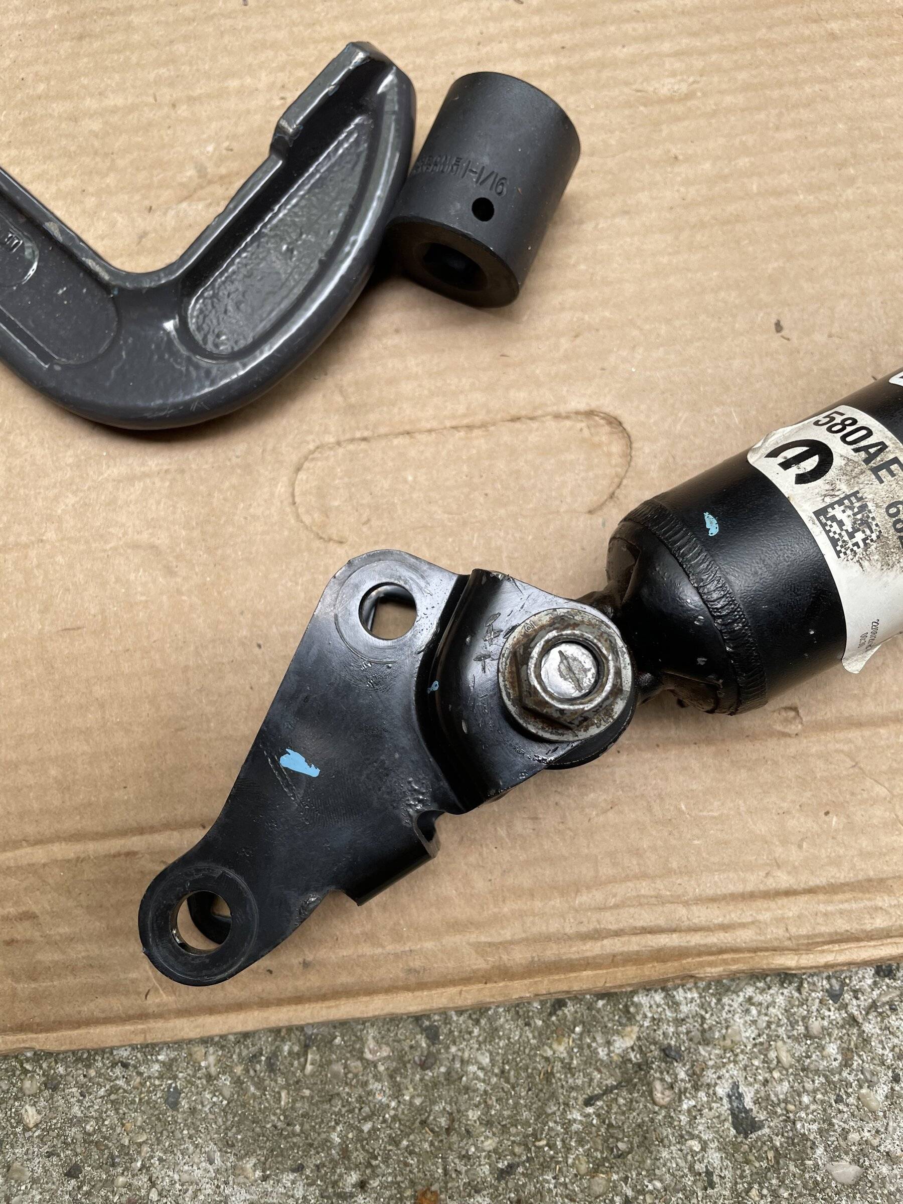

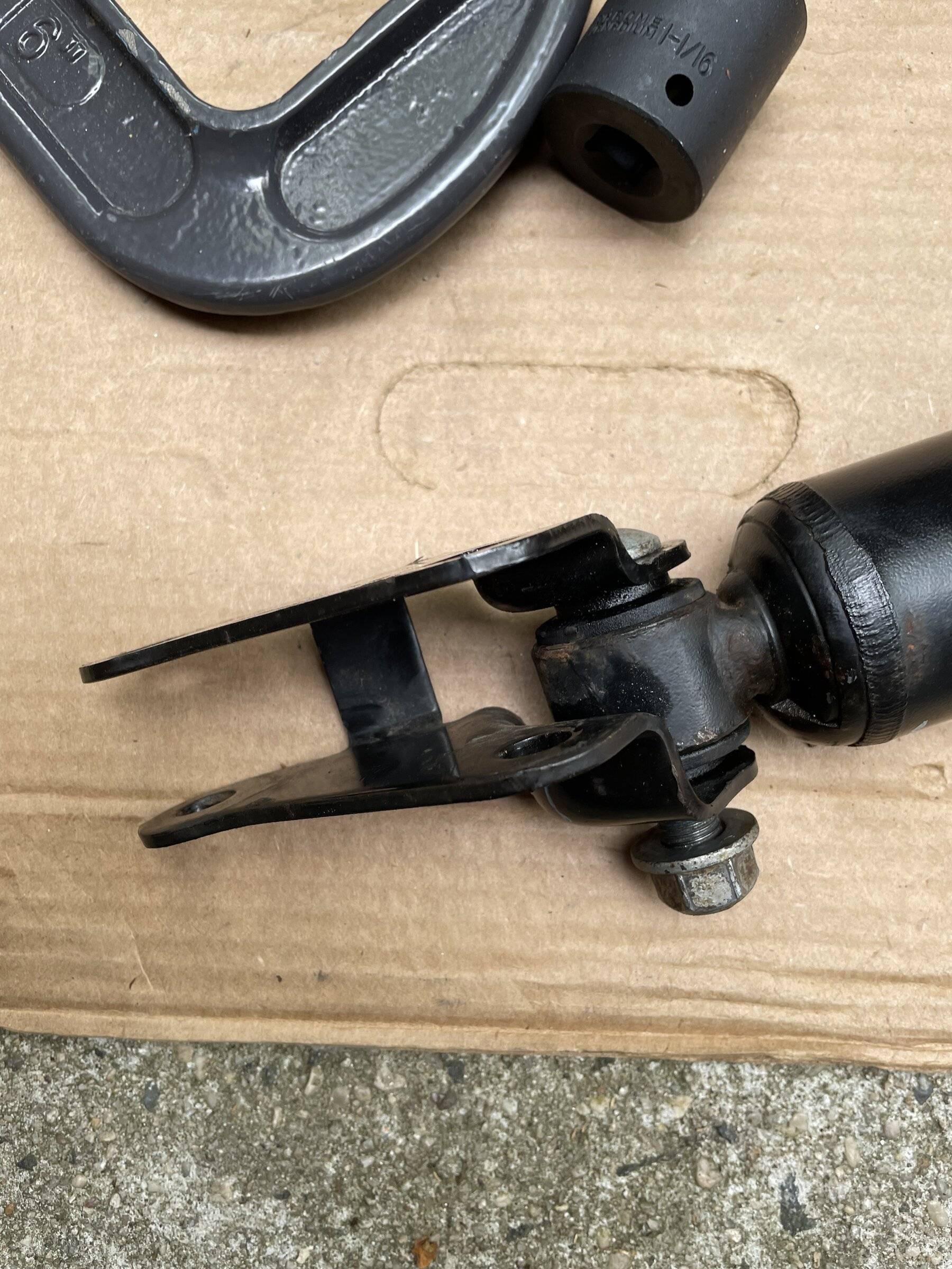

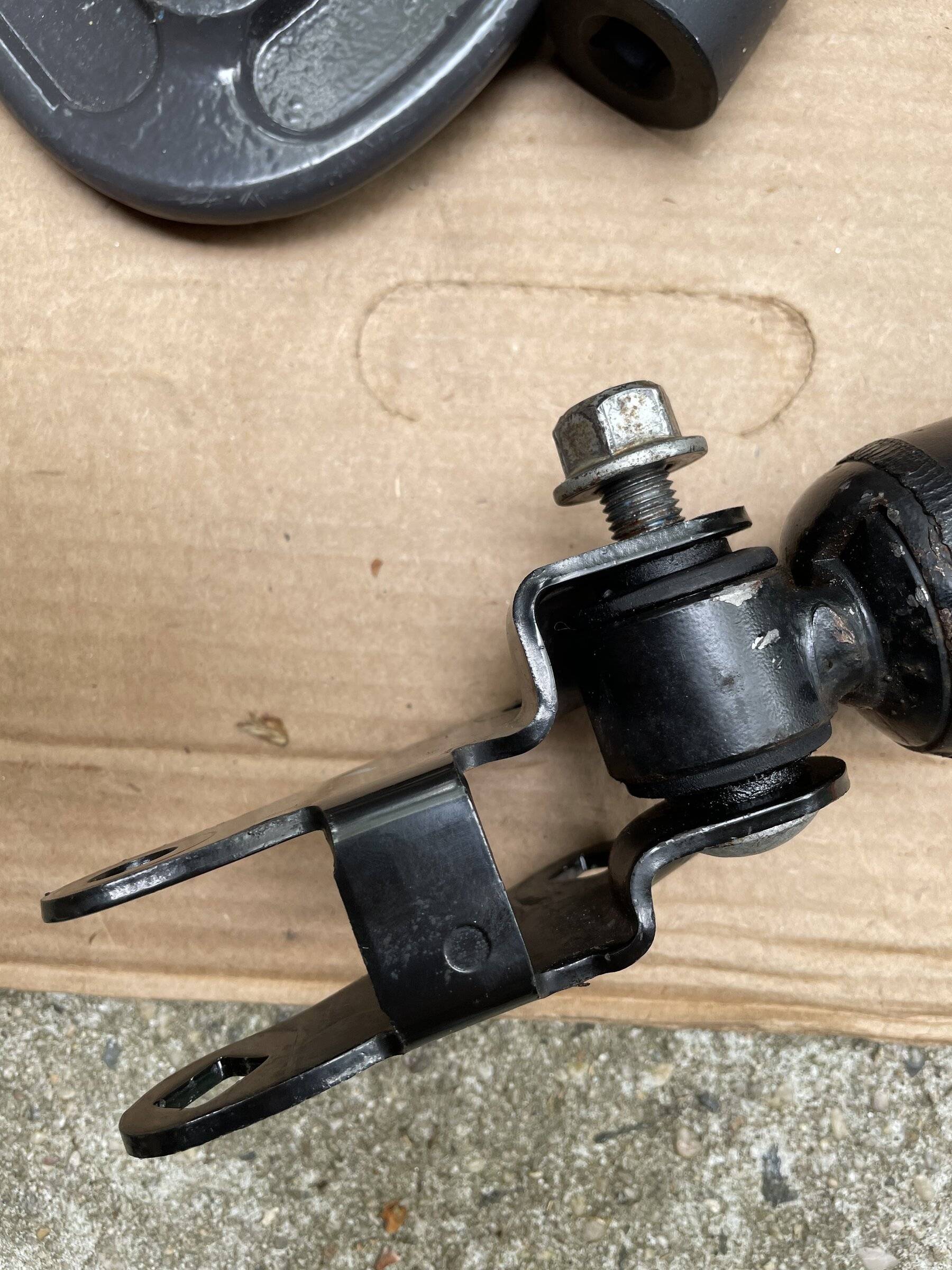

Does anyone have this part sitting around after swapping their steering stabilizer and don’t need it?
I’m unable to remove mine to change my stabilizer.
Genuine Mopar Damper Bracket part#68309363AB
(For Dana 210 or Dana 186 without wide axles)

You can cut the rounded head off with a cut off wheel, if you are careful about it. It should weaken the bolt enough to punch it out of the bracket. The shank most likely twisted in the bracket.
BadA$$Rubi
Bryan
Aug 16, 2019
316
434
Northeast Ohio
2019 JLU Rubicon
An extra pair of hands, a good bench vise, cut off wheel, drift punch, sledge and new bolt. You’ll get it!
