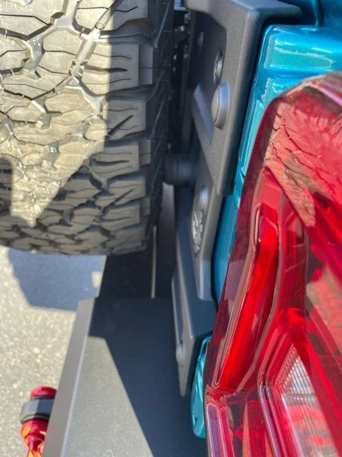

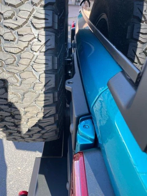

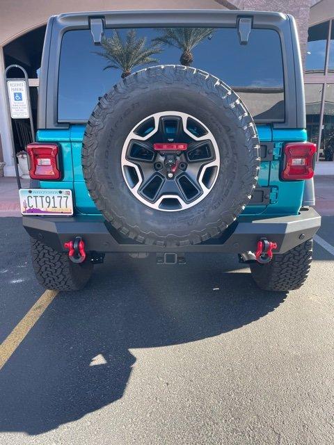

Could I trouble you for a couple of pics?
Here are a couple pictures, I had about the same spacing as you before I installed the Teraflex HD Alpha. Another benefit is the Teraflex camera housing is a little longer so you will see more of what is behind you and a bit less of the tire!

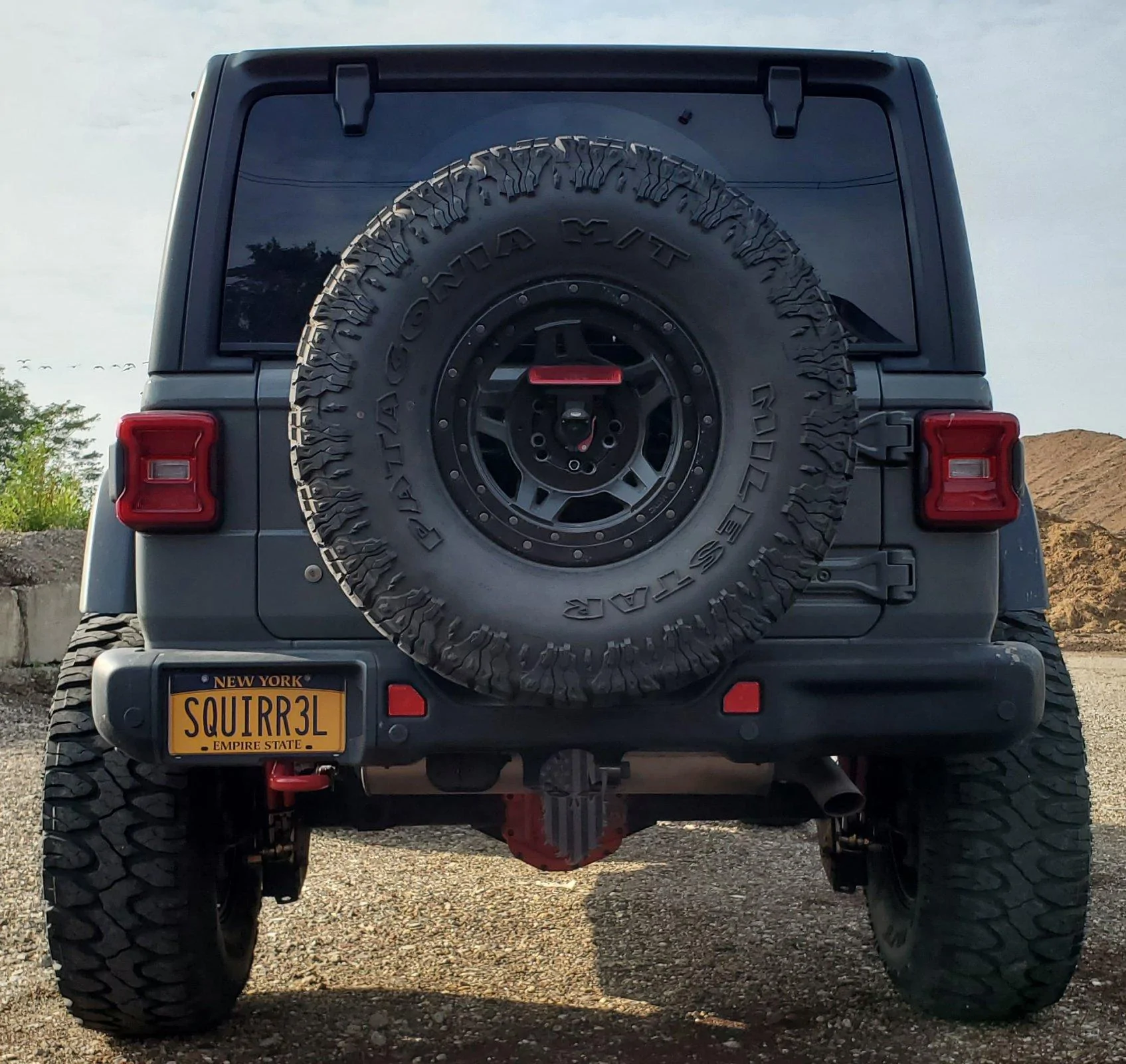

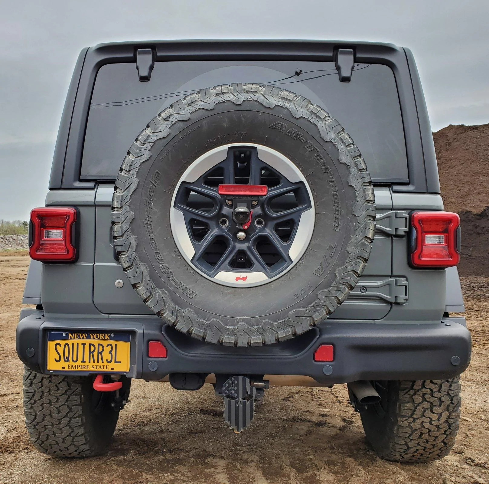

I only have rear pics. 1st with a 35 on factory wheels. 2nd with the 38x13.5 on a 17x9 wheel. Both are with the carrier at the highest level.

The Alpha HD carrier did very well with the 35's. I'd probably still have it if I didn't go larger. It's a great carrier.
Here's a couple pics. 1st was taken down low, which shows how high the 35's sit above the mopar steel bumper with the carrier set to the highest position. 2nd was from a standing position, which shows how much window gets blocked.
