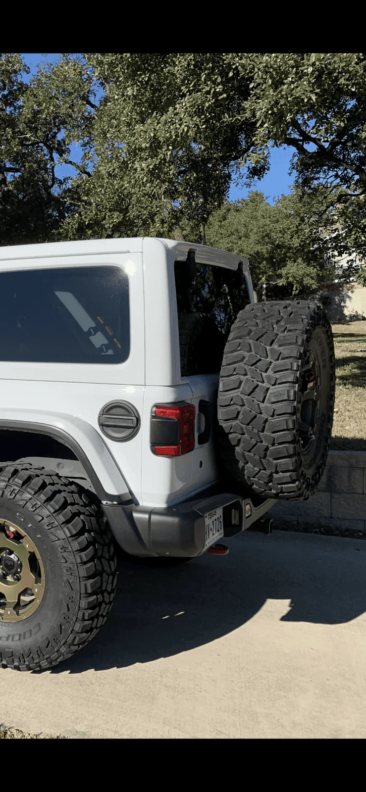

I’ve been running the Evo carrier for a few months and I’m very happy with it. Solid and never a hint of rattle. I’m running a 37x13.5x17 so it’s a pretty heavy spare.

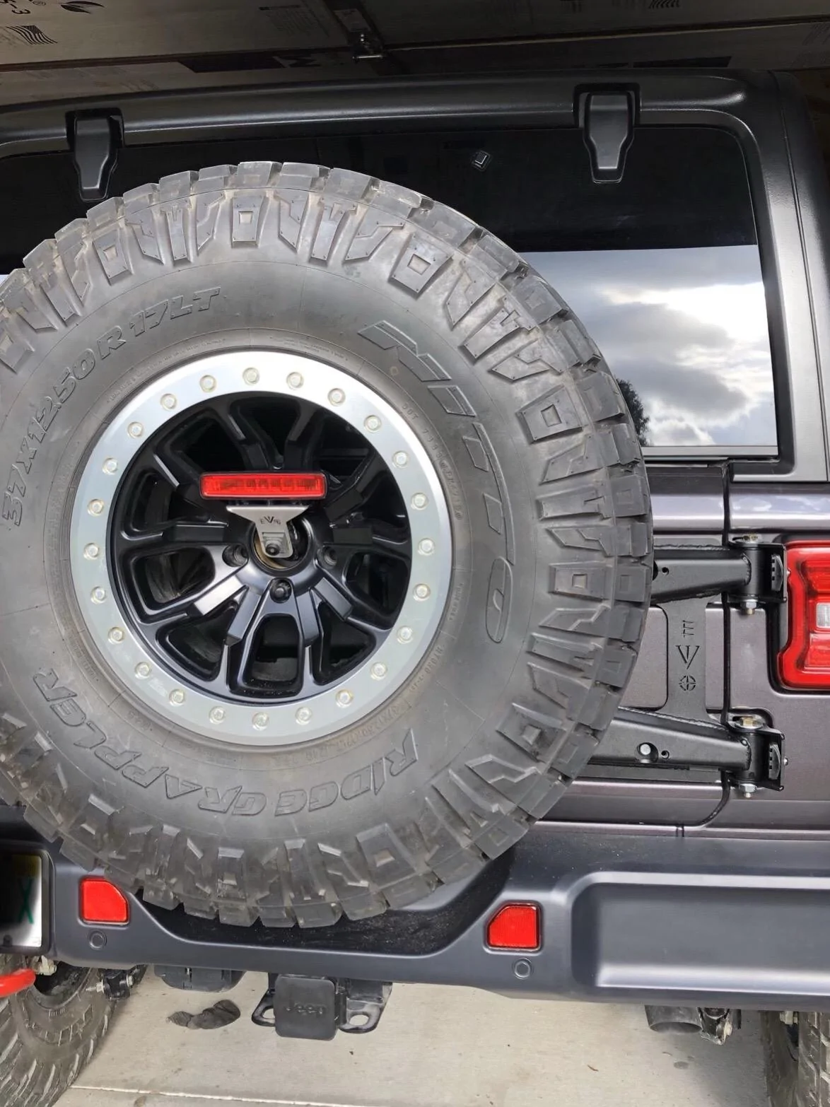

Rusty’s for sure. Reinforces the hinges on the body side with an extra plate. Provisions for camera and 3rd brake light that don’t require they be removed when changing spare. Excellent ecoat and powder coat.
I had the evo first. Sent it back due to rusting within two weeks of ownership.

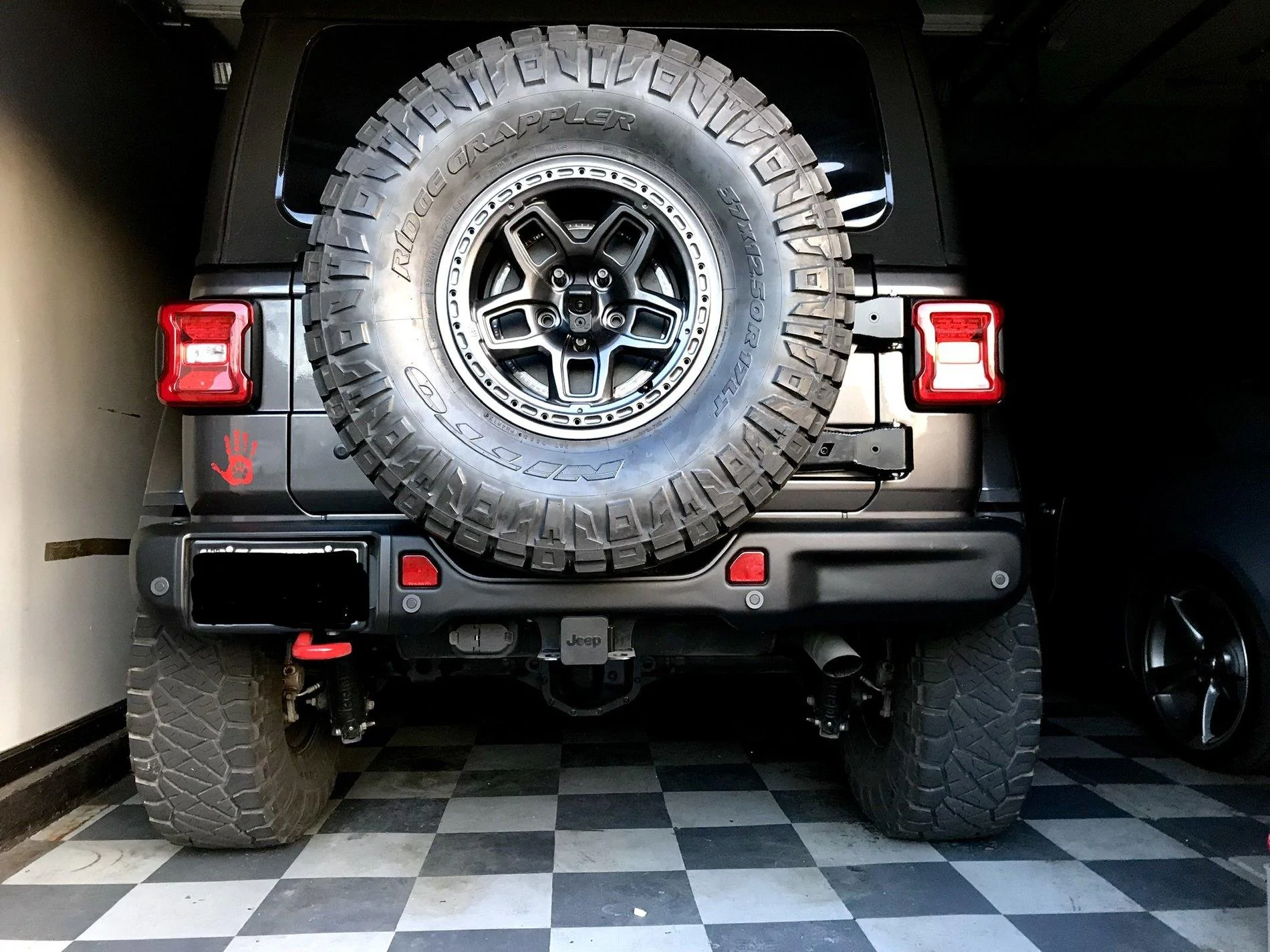

Motobilt is the tire carrier you want and need. It’s bilt like a tank and is adjustable up and down to mount larger tires. I have a 37” tire mounted here on its lowest setting so it sits lower and doesn’t obstruct the view out the back as much and keeps the weight low as well.

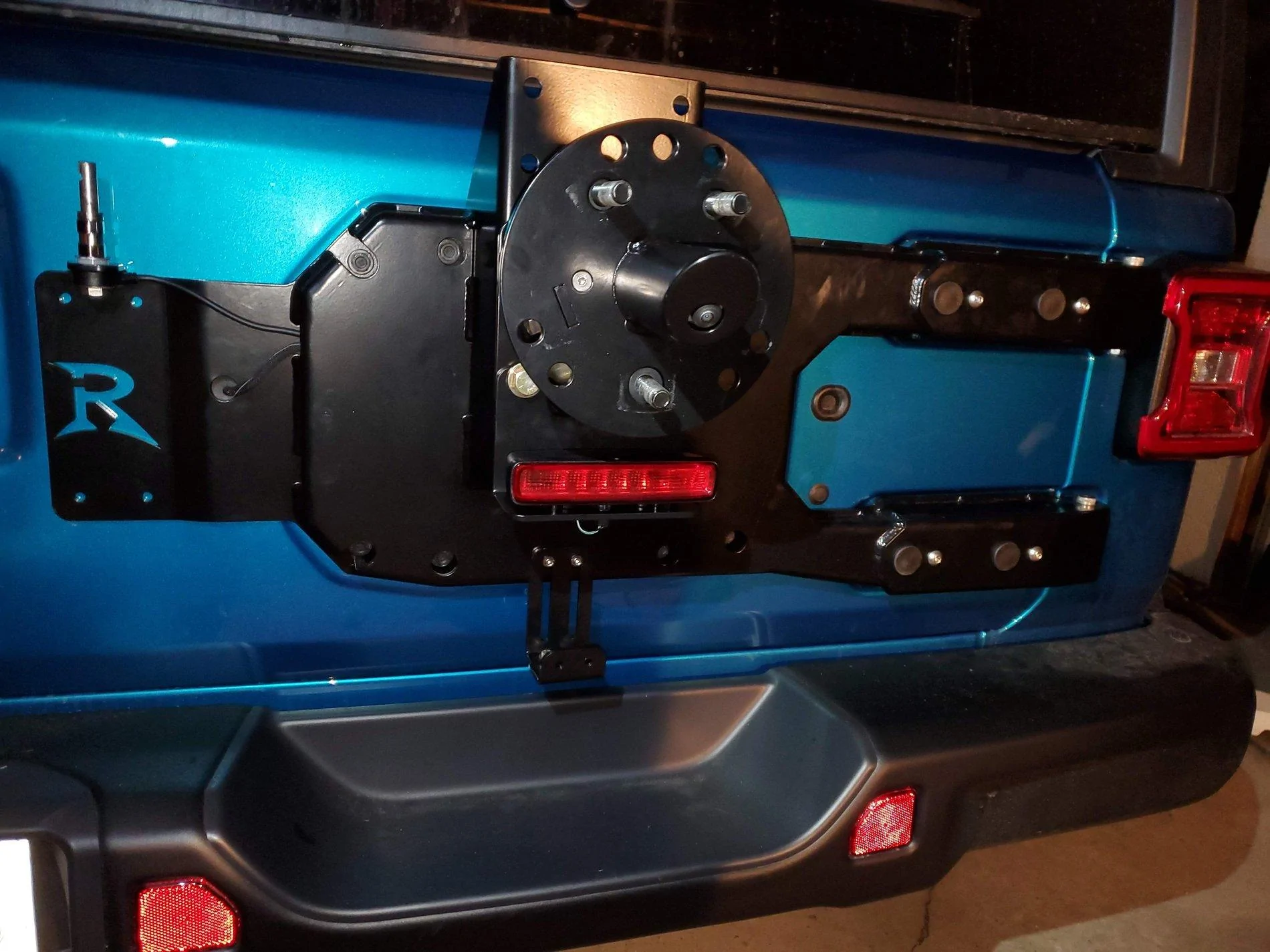

Teraflex for a solid engineered carrier that has mounting options for Hi-Lift, Rotopax, Antennas etc. Rugged Ridge for a budget version. Installed both without issues
