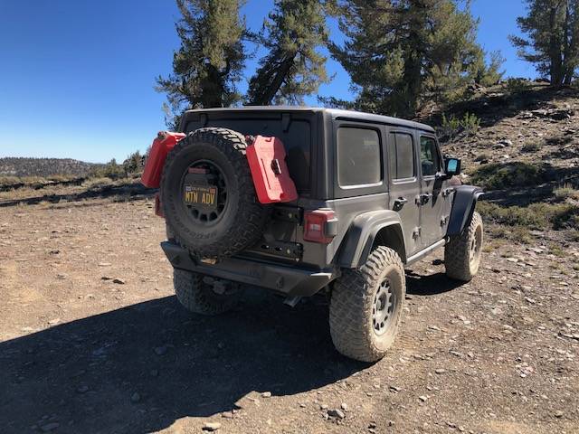

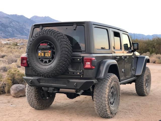

I have the Teraflex hinge and carrier. The thing is super beefy. I ran one when it came out for the JK, and it’s worked flawlessly for about 11 years with a 100lb+ wheel and tire combo. The new owner just totaled that Jeep a couple months back, but I don’t doubt it would have kept kicking much longer. Simply works.
The JL version feels just as beefy, if not more so, and should have no problem with even fairly heavy setups. I believe Teraflex claims support of up to a 39” tire.
Plus, there’s plenty of extra holes drilled and tapped to get creative with lights and accessories later on. I have my GMRS antenna mounted there and have plans for dust/chase lights at some point.
